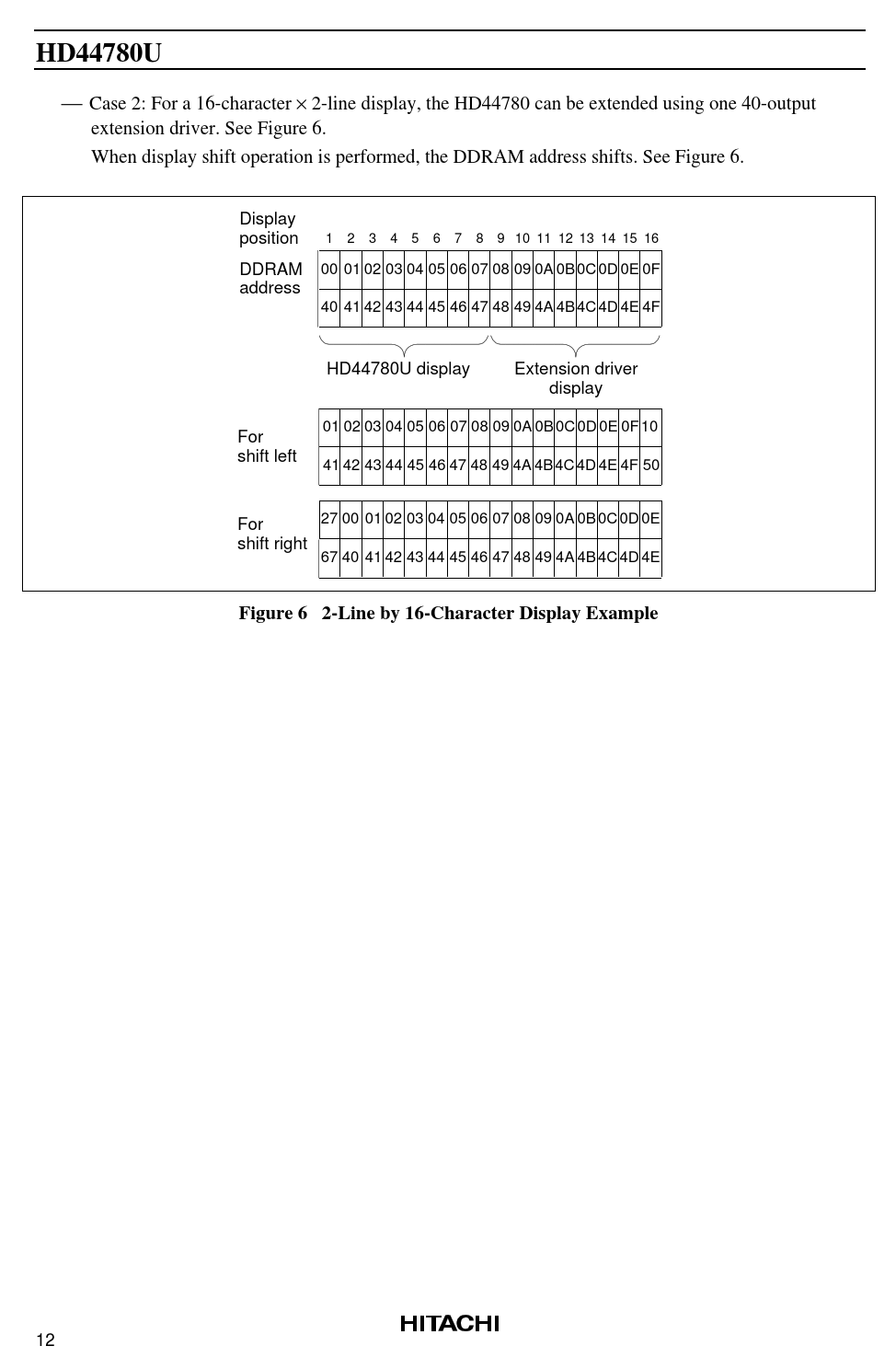

 Case 2: For a 16-character × 2-line display, the HD44780 can be extended using one 40-output extension driver. See Figure 6. When display shift operation is performed, the DDRAM address shifts. See Figure 6. Display position 1 2 3 4 5 6 7 8 9 10 11 12 13 14 15 16 DDRAM 00 01 02 03 04 05 06 07 08 09 0A 0B 0C 0D 0E 0F address 40 41 42 43 44 45 46 47 48 49 4A 4B 4C 4D 4E 4F HD44780U display Extension driver display 01 02 03 04 05 06 07 08 09 0A 0B 0C 0D 0E 0F 10 For shift left 41 42 43 44 45 46 47 48 49 4A 4B 4C 4D 4E 4F 50 27 00 01 02 03 04 05 06 07 08 09 0A 0B 0C 0D 0E For shift right 67 40 41 42 43 44 45 46 47 48 49 4A4B4C4D4E
Figure 6 2-Line by 16-Character Display Example
