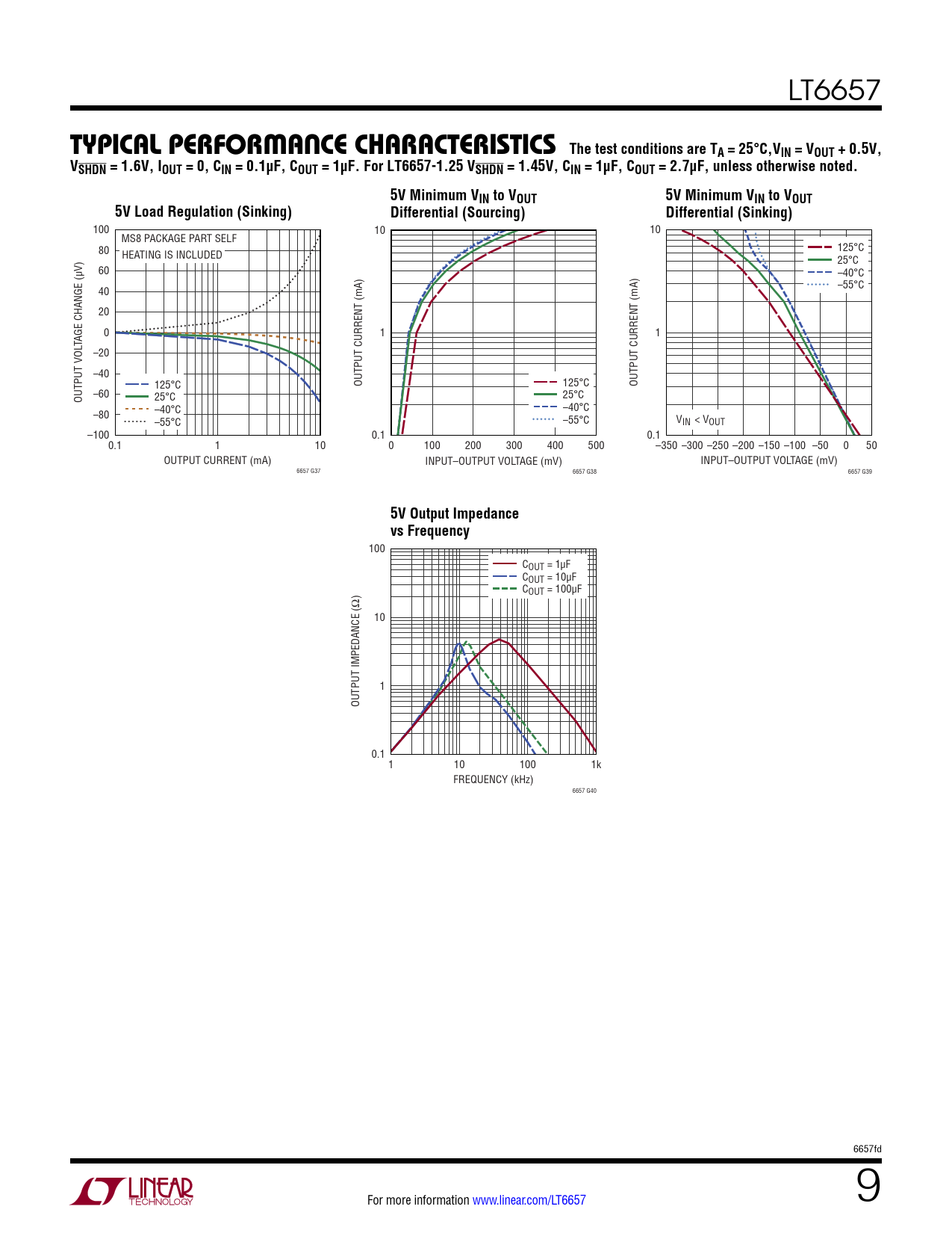

Typical perForMance characTerisTics The test conditions are TA = 25°C,VIN = VOUT + 0.5V,
LT6657
Typical perForMance characTerisTics The test conditions are TA = 25°C,VIN = VOUT + 0.5V, VSHDN = 1.6V, IOUT = 0, CIN = 0.1µF, COUT = 1µF. For LT6657-1.25 VSHDN = 1.45V, CIN = 1µF, COUT = 2.7µF, unless otherwise noted. 5V Minimum VIN to VOUT 5V Minimum VIN to VOUT 5V Load Regulation (Sinking) Differential (Sourcing) Differential (Sinking)
100 10 10 MS8 PACKAGE PART SELF 80 125°C HEATING IS INCLUDED 25°C V) 60 –40°C 40 –55°C 20 0 1 1 TAGE CHANGE (µ –20 –40 125°C OUTPUT CURRENT (mA) 125°C OUTPUT CURRENT (mA) –60 OUTPUT VOL 25°C 25°C –40°C –40°C –80 –55°C –55°C VIN < VOUT –100 0.1 0.1 0.1 1 10 0 100 200 300 400 500 –350 –300 –250 –200 –150 –100 –50 0 50 OUTPUT CURRENT (mA) INPUT–OUTPUT VOLTAGE (mV) INPUT–OUTPUT VOLTAGE (mV) 6657 G37 6657 G38 6657 G39
5V Output Impedance vs Frequency
100 COUT = 1µF COUT = 10µF COUT = 100µF 10 1 OUTPUT IMPEDANCE (Ω) 0.1 1 10 100 1k FREQUENCY (kHz) 6657 G40 6657fd For more information www.linear.com/LT6657 9
