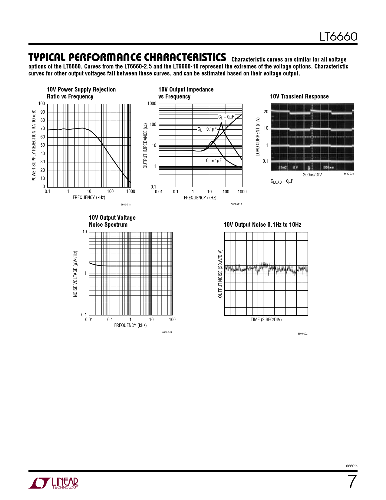

TYPICAL PERFOR A CE CHARACTERISTICS Characteristic curves are similar for all voltage
LT6660
W U TYPICAL PERFOR A CE CHARACTERISTICS Characteristic curves are similar for all voltage options of the LT6660. Curves from the LT6660-2.5 and the LT6660-10 represent the extremes of the voltage options. Characteristic curves for other output voltages fall between these curves, and can be estimated based on their voltage output. 10V Power Supply Rejection 10V Output Impedance Ratio vs Frequency vs Frequency 10V Transient Response
100 1000 90 20 C 80 L = 0µF ) 100 70 (Ω C 10 L = 0.1µF 60 50 10 1 40 LOAD CURRENT (mA) 30 CL = 1µF 0.1 OUTPUT IMPEDANCE 1 20 200µs/DIV 6660 G20 POWER SUPPLY REJECTION RATIO (dB) 10 CLOAD = 0µF 0 0.1 0.1 1 10 100 1000 0.01 0.1 1 10 100 1000 FREQUENCY (kHz) FREQUENCY (kHz) 6660 G18 6660 G19
10V Output Voltage Noise Spectrum 10V Output Noise 0.1Hz to 10Hz
10 √Hz) µV/DIV) (µV/ 1 NOISE VOLTAGE OUTPUT NOISE (20 0.10.01 0.1 1 10 100 TIME (2 SEC/DIV) FREQUENCY (kHz) 6660 G21 6660 G22 6660fa 7
