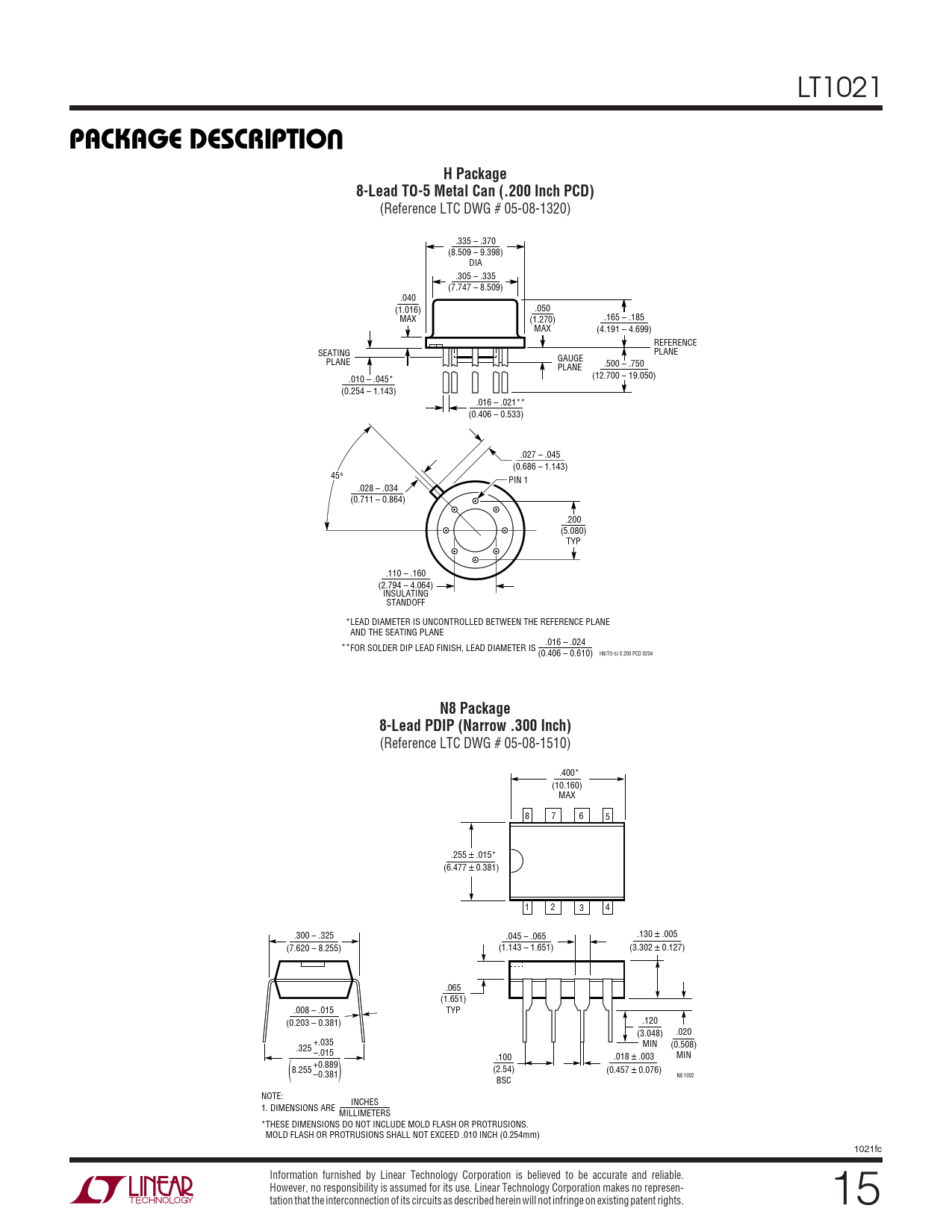

PACKAGE DESCRIPTION. H Package. 8-Lead TO-5 Metal Can (.200 Inch PCD). N8 Package. 8-Lead PDIP (Narrow .300 Inch)
PACKAGE DESCRIPTION H Package 8-Lead TO-5 Metal Can (.200 Inch PCD) N8 Package 8-Lead PDIP (Narrow .300 Inch)
LT1021
U PACKAGE DESCRIPTION H Package 8-Lead TO-5 Metal Can (.200 Inch PCD)
(Reference LTC DWG # 05-08-1320) .335 – .370 (8.509 – 9.398) DIA .305 – .335 (7.747 – 8.509) .040 (1.016) .050 MAX (1.270) .165 – .185 MAX (4.191 – 4.699) REFERENCE SEATING PLANE PLANE GAUGE PLANE .500 – .750 (12.700 – 19.050) .010 – .045* (0.254 – 1.143) .016 – .021** (0.406 – 0.533) .027 – .045 (0.686 – 1.143) 45° PIN 1 .028 – .034 (0.711 – 0.864) .200 (5.080) TYP .110 – .160 (2.794 – 4.064) INSULATING STANDOFF *LEAD DIAMETER IS UNCONTROLLED BETWEEN THE REFERENCE PLANE AND THE SEATING PLANE .016 – .024 **FOR SOLDER DIP LEAD FINISH, LEAD DIAMETER IS (0.406 – 0.610) H8(TO-5) 0.200 PCD 0204
(Reference LTC DWG # 05-08-1510) .400* (10.160) MAX 8 7 6 5 .255 ± .015* (6.477 ± 0.381) 1 2 3 4 .300 – .325 .045 – .065 .130 ± .005 (7.620 – 8.255) (1.143 – 1.651) (3.302 ± 0.127) .065 (1.651) .008 – .015 TYP .120 (0.203 – 0.381) (3.048) .020 +.035 MIN (0.508) .325 –.015 MIN .100 .018 ± .003 +0.889 8.255 (2.54) (0.457 ± 0.076) ( ) –0.381 N8 1002 BSC NOTE: INCHES 1. DIMENSIONS ARE MILLIMETERS *THESE DIMENSIONS DO NOT INCLUDE MOLD FLASH OR PROTRUSIONS. MOLD FLASH OR PROTRUSIONS SHALL NOT EXCEED .010 INCH (0.254mm) 1021fc Information furnished by Linear Technology Corporation is believed to be accurate and reliable. However, no responsibility is assumed for its use. Linear Technology Corporation makes no represen- tation that the interconnection of its circuits as described herein will not infringe on existing patent rights. 15
