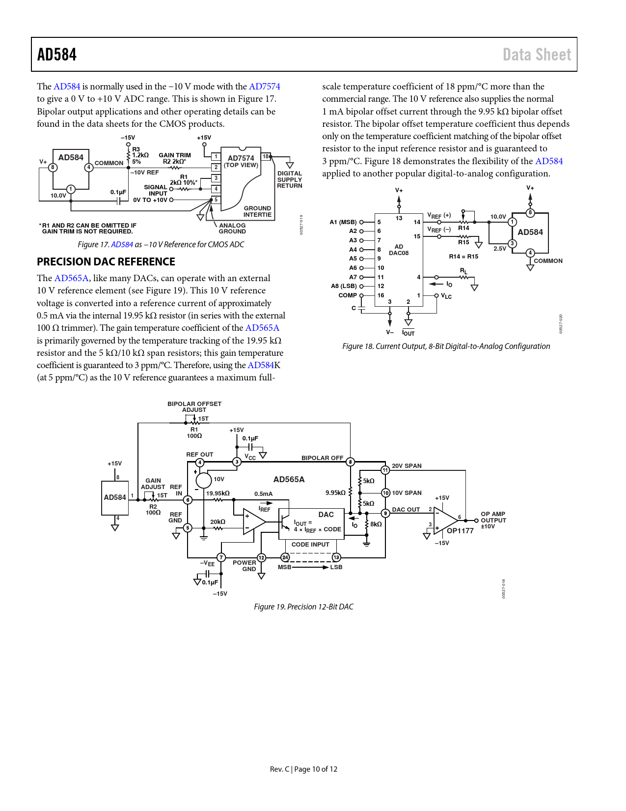

AD584 Data Sheet
The AD584 is normal y used in the −10 V mode with the AD7574 scale temperature coefficient of 18 ppm/°C more than the to give a 0 V to +10 V ADC range. This is shown in Figure 17. commercial range. The 10 V reference also supplies the normal Bipolar output applications and other operating details can be 1 mA bipolar offset current through the 9.95 kΩ bipolar offset found in the data sheets for the CMOS products. resistor. The bipolar offset temperature coefficient thus depends

AD584 1.2kΩ GAIN TRIM 1 18 AD7574 V+ COMMON 5% R2 2kΩ* (TOP VIEW)
3 ppm/°C. Figure 18 demonstrates the flexibility of the AD584
8 4 2 –10V REF DIGITAL R1
applied to another popular digital-to-analog configuration.
3 SUPPLY 2kΩ 10%* RETURN 1 SIGNAL 4 V+ 0.1µF V+ 10.0V INPUT 0V TO +10V 5 GROUND INTERTIE V 8 13 REF (+) 10.0V
019
A1 (MSB) 5 14 1 * R1 AND R2 CAN BE OMITTED IF ANALOG R14 GAIN TRIM IS NOT REQUIRED. GROUND A2 6 VREF (–)
00527-
AD584 15
Figure 17. AD584 as −10 V Reference for CMOS ADC

The AD565A, like many DACs, can operate with an external
L A7 11 4 I
10 V reference element (see Figure 19). This 10 V reference
O A8 (LSB) 12 COMP 16 1 V
voltage is converted into a reference current of approximately
LC 3 2 C
0.5 mA via the internal 19.95 kΩ resistor (in series with the external 020 100 Ω trimmer). The gain temperature coefficient of the AD565A

is primarily governed by the temperature tracking of the 19.95 kΩ Figure 18. Current Output, 8-Bit Digital-to-Analog Configuration resistor and the 5 kΩ/10 kΩ span resistors; this gain temperature coefficient is guaranteed to 3 ppm/°C. Therefore, using the AD584K (at 5 ppm/°C) as the 10 V reference guarantees a maximum ful -
BIPOLAR OFFSET ADJUST 15T R1 +15V 100Ω 0.1µF REF OUT VCC BIPOLAR OFF +15V 20V SPAN 8 10V GAIN AD565A 5kΩ ADJUST REF IN 19.95 1 15T kΩ 0.5mA 9.95kΩ 10V SPAN AD584 +15V 5kΩ R2 IREF DAC OUT 2 100Ω REF DAC OP AMP 6 4 GND 20kΩ I OUTPUT OUT = IO 8kΩ 3 4 × I ±10V REF × CODE OP1177 CODE INPUT –15V –VEE POWER MSB LSB GND 0.1µF
