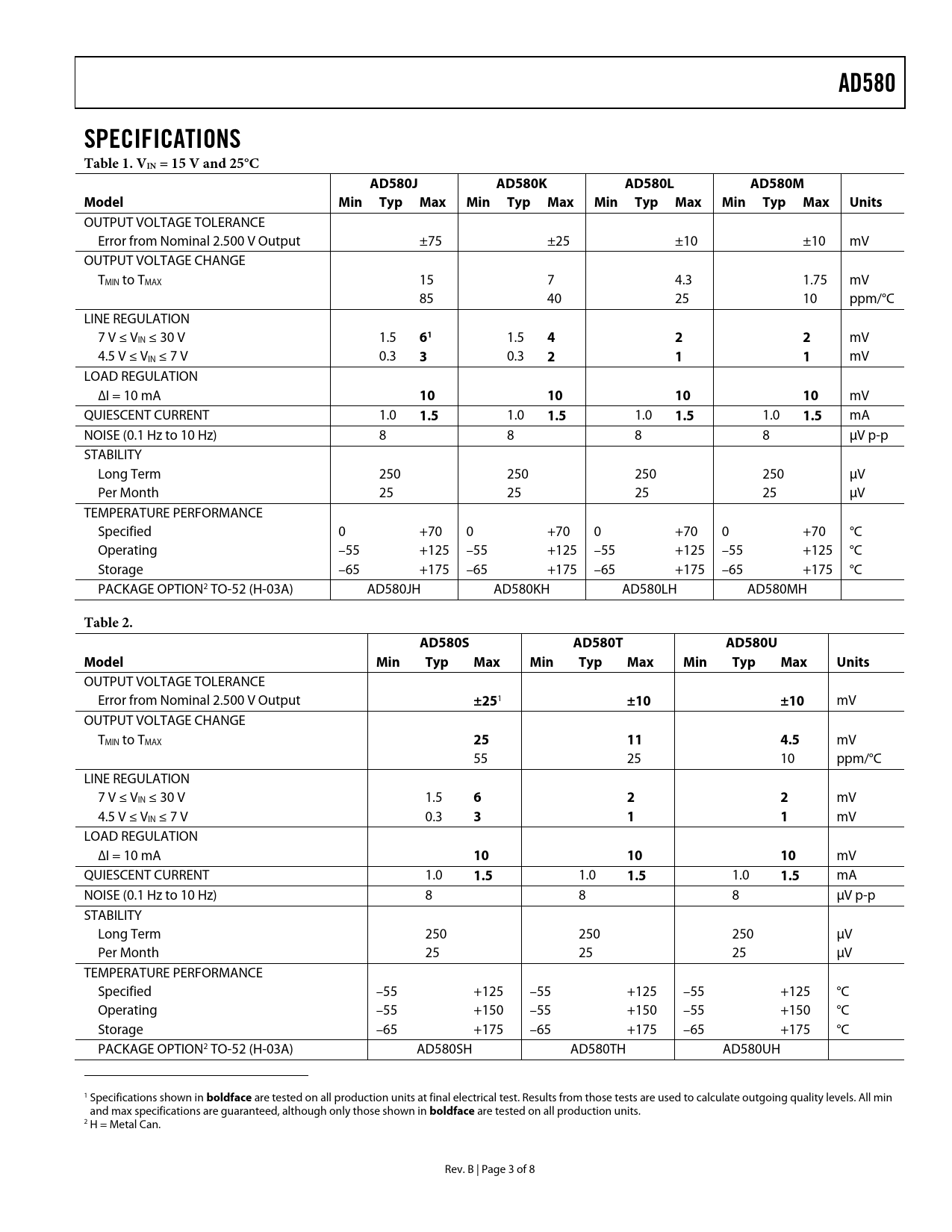

DescriptionHigh Precision 2.5 V IC Reference
Pages / Page8 / 3 — AD580. SPECIFICATIONS Table 1. VIN = 15 V and 25°C AD580J. AD580K. …
RevisionB
File Format / SizePDF / 194 Kb
AD580. SPECIFICATIONS Table 1. VIN = 15 V and 25°C AD580J. AD580K. AD580L. AD580M. Model. Min Typ Max Min Typ Max Min Typ Max
AD580 SPECIFICATIONS Table 1 VIN = 15 V and 25°C AD580J AD580K AD580L AD580M Model Min Typ Max Min Typ Max Min Typ Max
link to page 3 link to page 3 link to page 3 link to page 3
AD580 SPECIFICATIONS Table 1. VIN = 15 V and 25°C AD580J AD580K AD580L AD580M Model Min Typ Max Min Typ Max Min Typ Max Min Typ Max Units
OUTPUT VOLTAGE TOLERANCE Error from Nominal 2.500 V Output ±75 ±25 ±10 ±10 mV OUTPUT VOLTAGE CHANGE TMIN to TMAX 15 7 4.3 1.75 mV 85 40 25 10 ppm/°C LINE REGULATION 7 V ≤ VIN ≤ 30 V 1.5
61
1.5
4 2 2
mV 4.5 V ≤ VIN ≤ 7 V 0.3
3
0.3
2 1 1
mV LOAD REGULATION ∆I = 10 mA
10 10 10 10
mV QUIESCENT CURRENT 1.0
1.5
1.0
1.5
1.0
1.5
1.0
1.5
mA NOISE (0.1 Hz to 10 Hz) 8 8 8 8 µV p-p STABILITY Long Term 250 250 250 250 µV Per Month 25 25 25 25 µV TEMPERATURE PERFORMANCE Specified 0 +70 0 +70 0 +70 0 +70 °C Operating –55 +125 –55 +125 –55 +125 –55 +125 °C Storage –65 +175 –65 +175 –65 +175 –65 +175 °C PACKAGE OPTION2 TO-52 (H-03A) AD580JH AD580KH AD580LH AD580MH
Table 2. AD580S AD580T AD580U Model Min Typ Max Min Typ Max Min Typ Max Units
±25
1
±10 ±10
25 11 4.5
mV 55 25 10 ppm/°C LINE REGULATION 7 V ≤ VIN ≤ 30 V 1.5
6 2 2
3 1 1
10 10 10
1.5
1.0
1.5
1.0
1.5
mA NOISE (0.1 Hz to 10 Hz) 8 8 8 µV p-p STABILITY Long Term 250 250 250 µV Per Month 25 25 25 µV TEMPERATURE PERFORMANCE Specified –55 +125 –55 +125 –55 +125 °C Operating –55 +150 –55 +150 –55 +150 °C Storage –65 +175 –65 +175 –65 +175 °C PACKAGE OPTION2 TO-52 (H-03A) AD580SH AD580TH AD580UH 1 Specifications shown in
boldface
are tested on all production units at final electrical test. Results from those tests are used to calculate outgoing quality levels. All min and max specifications are guaranteed, although only those shown in
boldface
are tested on all production units. 2 H = Metal Can. Rev. B | Page 3 of 8 Document Outline FEATURES GENERAL DESCRIPTION FUNCTIONAL BLOCK DIAGRAM PRODUCT HIGHLIGHTS SPECIFICATIONS ABSOLUTE MAXIMUM RATINGS AD580 CHIP DIMENSIONS AND PAD LAYOUT ESD CAUTION THEORY OF OPERATION VOLTAGE VARIATION VERSUS TEMPERATURE NOISE PERFORMANCE THE AD580 AS A CURRENT LIMITER THE AD580 AS A LOW POWER, LOW VOLTAGE, PRECISION REFERENCE F OUTLINE DIMENSIONS ORDERING GUIDE
