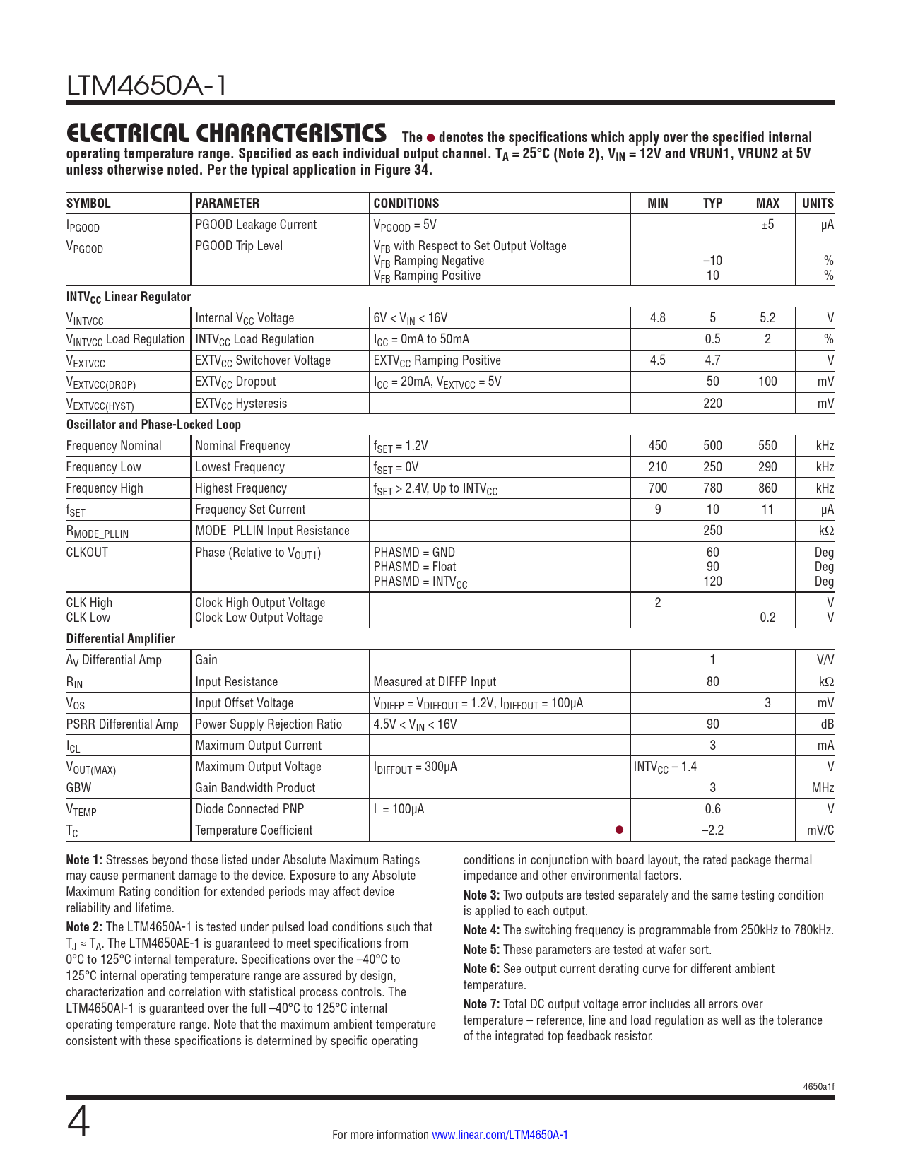

denotes the specifications which apply over the specified internal operating temperature range. Specified as each individual output channel. TA = 25°C (Note 2), VIN = 12V and VRUN1, VRUN2 at 5V unless otherwise noted. Per the typical application in Figure 34. SYMBOL PARAMETER CONDITIONS MIN TYP MAX UNITS
IPGOOD PGOOD Leakage Current VPGOOD = 5V ±5 µA VPGOOD PGOOD Trip Level VFB with Respect to Set Output Voltage VFB Ramping Negative –10 % VFB Ramping Positive 10 %
INTVCC Linear Regulator
VINTVCC Internal VCC Voltage 6V < VIN < 16V 4.8 5 5.2 V VINTVCC Load Regulation INTVCC Load Regulation ICC = 0mA to 50mA 0.5 2 % VEXTVCC EXTVCC Switchover Voltage EXTVCC Ramping Positive 4.5 4.7 V VEXTVCC(DROP) EXTVCC Dropout ICC = 20mA, VEXTVCC = 5V 50 100 mV VEXTVCC(HYST) EXTVCC Hysteresis 220 mV
Oscillator and Phase-Locked Loop
Frequency Nominal Nominal Frequency fSET = 1.2V 450 500 550 kHz Frequency Low Lowest Frequency fSET = 0V 210 250 290 kHz Frequency High Highest Frequency fSET > 2.4V, Up to INTVCC 700 780 860 kHz fSET Frequency Set Current 9 10 11 µA RMODE_PLLIN MODE_PLLIN Input Resistance 250 kΩ CLKOUT Phase (Relative to VOUT1) PHASMD = GND 60 Deg PHASMD = Float 90 Deg PHASMD = INTVCC 120 Deg CLK High Clock High Output Voltage 2 V CLK Low Clock Low Output Voltage 0.2 V
Differential Amplifier
AV Differential Amp Gain 1 V/V RIN Input Resistance Measured at DIFFP Input 80 kΩ VOS Input Offset Voltage VDIFFP = VDIFFOUT = 1.2V, IDIFFOUT = 100µA 3 mV PSRR Differential Amp Power Supply Rejection Ratio 4.5V < VIN < 16V 90 dB ICL Maximum Output Current 3 mA VOUT(MAX) Maximum Output Voltage IDIFFOUT = 300µA INTVCC – 1.4 V GBW Gain Bandwidth Product 3 MHz VTEMP Diode Connected PNP I = 100µA 0.6 V TC Temperature Coefficient l –2.2 mV/C
