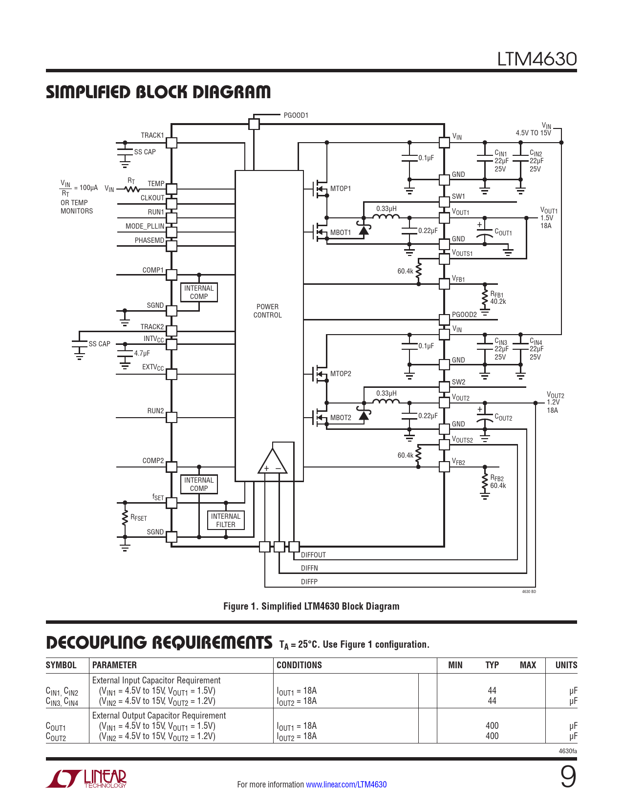

SIMPLIFIED BLOCK DIAGRAM. Figure 1. Simplified LTM4630 Block Diagram
LTM4630
PGOOD1 VIN TRACK1 V 4.5V TO 15V IN SS CAP C C 0.1µF IN1 IN2 22µF 22µF 25V 25V GND V R IN T TEMP = 100µA VIN MTOP1 RT CLKOUT SW1 OR TEMP MONITORS RUN1 0.33µH V VOUT1 OUT1 1.5V MODE_PLLIN + 18A MBOT1 0.22µF COUT1 PHASEMD GND VOUTS1 COMP1 60.4k VFB1 INTERNAL RFB1 COMP 40.2k SGND POWER CONTROL PGOOD2 TRACK2 VIN INTVCC C C SS CAP 0.1µF IN3 IN4 4.7µF 22µF 22µF GND 25V 25V EXTVCC MTOP2 SW2 0.33µH V V OUT2 OUT2 1.2V RUN2 + 18A MBOT2 0.22µF COUT2 GND VOUTS2 60.4k COMP2 + V – FB2 RFB2 INTERNAL 60.4k COMP fSET R INTERNAL FSET FILTER SGND DIFFOUT DIFFN DIFFP 4630 BD
Figure 1. Simplified LTM4630 Block Diagram DECOUPLING REQUIREMENTS TA = 25°C. Use Figure 1 configuration. SYMBOL PARAMETER CONDITIONS MIN TYP MAX UNITS
External Input Capacitor Requirement CIN1, CIN2 (VIN1 = 4.5V to 15V, VOUT1 = 1.5V) IOUT1 = 18A 44 µF CIN3, CIN4 (VIN2 = 4.5V to 15V, VOUT2 = 1.2V) IOUT2 = 18A 44 µF External Output Capacitor Requirement COUT1 (VIN1 = 4.5V to 15V, VOUT1 = 1.5V) IOUT1 = 18A 400 µF COUT2 (VIN2 = 4.5V to 15V, VOUT2 = 1.2V) IOUT2 = 18A 400 µF 4630fa For more information www.linear.com/LTM4630 9 Document Outline Description Typical Application Absolute Maximum Ratings Pin Configuration Electrical Characteristics Typical Performance Characteristics Pin Functions Operation Applications Information Package Description Related Parts
