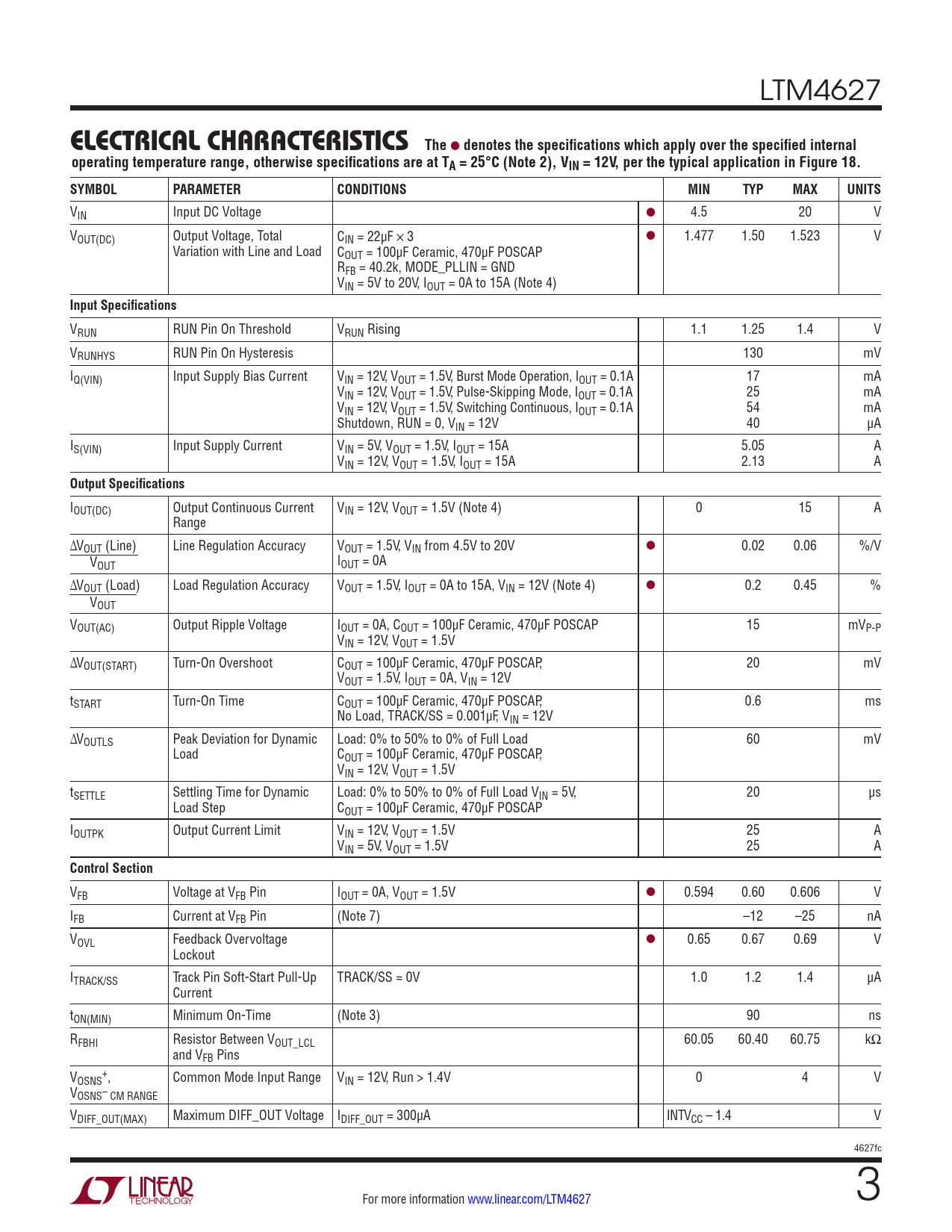

ELECTRICAL CHARACTERISTICS. The. denotes the specifications which apply over the specified internal
ELECTRICAL CHARACTERISTICS The denotes the specifications which apply over the specified internal
LTM4627
l
denotes the specifications which apply over the specified internal operating temperature range, otherwise specifications are at TA = 25°C (Note 2), VIN = 12V, per the typical application in Figure 18. SYMBOL PARAMETER CONDITIONS MIN TYP MAX UNITS
VIN Input DC Voltage l 4.5 20 V VOUT(DC) Output Voltage, Total CIN = 22µF × 3 l 1.477 1.50 1.523 V Variation with Line and Load COUT = 100µF Ceramic, 470µF POSCAP RFB = 40.2k, MODE_PLLIN = GND VIN = 5V to 20V, IOUT = 0A to 15A (Note 4)
Input Specifications
VRUN RUN Pin On Threshold VRUN Rising 1.1 1.25 1.4 V VRUNHYS RUN Pin On Hysteresis 130 mV IQ(VIN) Input Supply Bias Current VIN = 12V, VOUT = 1.5V, Burst Mode Operation, IOUT = 0.1A 17 mA VIN = 12V, VOUT = 1.5V, Pulse-Skipping Mode, IOUT = 0.1A 25 mA VIN = 12V, VOUT = 1.5V, Switching Continuous, IOUT = 0.1A 54 mA Shutdown, RUN = 0, VIN = 12V 40 µA IS(VIN) Input Supply Current VIN = 5V, VOUT = 1.5V, IOUT = 15A 5.05 A VIN = 12V, VOUT = 1.5V, IOUT = 15A 2.13 A
Output Specifications
IOUT(DC) Output Continuous Current VIN = 12V, VOUT = 1.5V (Note 4) 0 15 A Range ∆VOUT (Line) Line Regulation Accuracy VOUT = 1.5V, VIN from 4.5V to 20V l 0.02 0.06 %/V VOUT IOUT = 0A ∆VOUT (Load) Load Regulation Accuracy VOUT = 1.5V, IOUT = 0A to 15A, VIN = 12V (Note 4) l 0.2 0.45 % VOUT VOUT(AC) Output Ripple Voltage IOUT = 0A, COUT = 100µF Ceramic, 470µF POSCAP 15 mVP-P VIN = 12V, VOUT = 1.5V ∆VOUT(START) Turn-On Overshoot COUT = 100µF Ceramic, 470µF POSCAP, 20 mV VOUT = 1.5V, IOUT = 0A, VIN = 12V tSTART Turn-On Time COUT = 100µF Ceramic, 470µF POSCAP, 0.6 ms No Load, TRACK/SS = 0.001µF, VIN = 12V ∆VOUTLS Peak Deviation for Dynamic Load: 0% to 50% to 0% of Full Load 60 mV Load COUT = 100µF Ceramic, 470µF POSCAP, VIN = 12V, VOUT = 1.5V tSETTLE Settling Time for Dynamic Load: 0% to 50% to 0% of Full Load VIN = 5V, 20 µs Load Step COUT = 100µF Ceramic, 470µF POSCAP IOUTPK Output Current Limit VIN = 12V, VOUT = 1.5V 25 A VIN = 5V, VOUT = 1.5V 25 A
