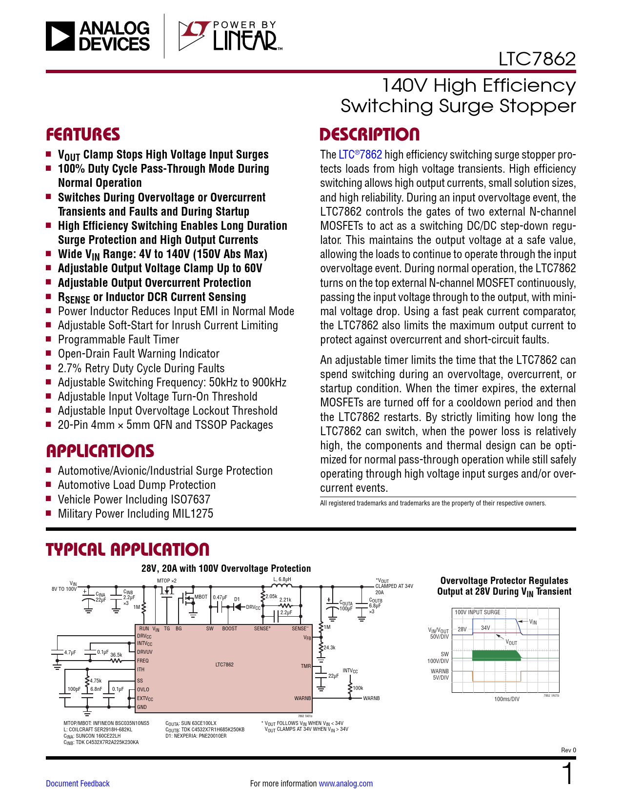

TYPICAL APPLICATION 28V, 20A with 100V Overvoltage Protection
MTOP ×2 L, 6.8µH V *VOUT IN
Overvoltage Protector Regulates
8V TO 100V CLAMPED AT 34V CINB C 20A INA
Output at 28V During V
2.2µF MBOT 0.47µF 2.05k
IN Transient
22µF D1 2.21k C ×3 OUTB COUTA 1M DRV 6.8µF CC 100µF 2.2µF ×3 100V INPUT SURGE VIN 1M RUN VIN TG BG SW BOOST SENSE+ SENSE– V 28V 34V IN/VOUT DRVCC VFB 50V/DIV INTV V CC OUT 24.3k 4.7µF 0.1µF 36.5k DRVUV SW FREQ 100V/DIV LTC7862 ITH TMR INTVCC WARNB 22µF 4.75k SS 5V/DIV 100pF 6.8nF 0.1µF 100k OVLO EXTV 7862 TA01b CC WARNB WARNB 100ms/DIV GND 7862 TA01a MTOP/MBOT: INFINEON BSC035N10NS5 COUTA: SUN 63CE100LX * VOUT FOLLOWS VIN WHEN VIN < 34V L: COILCRAFT SER2918H-682KL COUTB: TDK C4532X7R1H685K250KB VOUT CLAMPS AT 34V WHEN VIN > 34V CINA: SUNCON 160CE22LH D1: NEXPERIA: PNE20010ER CINB: TDK C4532X7R2A225K230KA Rev 0 Document Feedback For more information www.analog.com 1 Document Outline FEATURES DESCRIPTION APPLICATIONS TYPICAL APPLICATION ABSOLUTE MAXIMUM RATINGS PIN CONFIGURATION ORDER INFORMATION ELECTRICAL CHARACTERISTICS TYPICAL PERFORMANCE CHARACTERISTICS PIN FUNCTIONS TIMING DIAGRAM FUNCTIONAL DIAGRAM OPERATION APPLICATIONS INFORMATION TYPICAL APPLICATIONS PACKAGE DESCRIPTION TYPICAL APPLICATION RELATED PARTS
