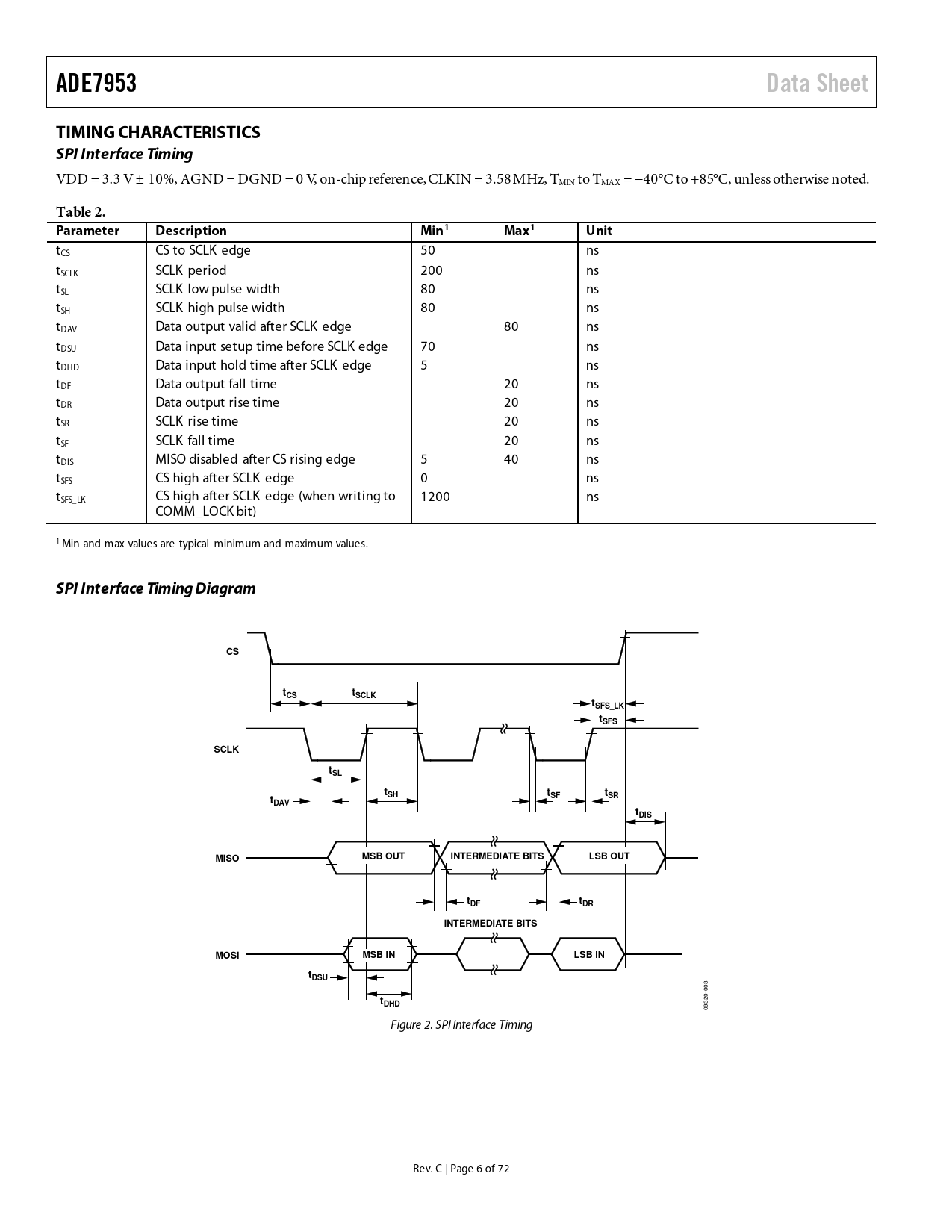

ADE7953. Data Sheet. TIMING CHARACTERISTICS SPI Interface Timing. Table 2. Parameter. Description. Min1. Max1. Unit
ADE7953 Data Sheet TIMING CHARACTERISTICS SPI Interface Timing Table 2 Parameter Description Min1 Max1 Unit
VDD = 3.3 V ± 10%, AGND = DGND = 0 V, on-chip reference, CLKIN = 3.58 MHz, TMIN to TMAX = −40°C to +85°C, unless otherwise noted.
Table 2. Parameter Description Min1 Max1 Unit
tCS CS to SCLK edge 50 ns tSCLK SCLK period 200 ns tSL SCLK low pulse width 80 ns tSH SCLK high pulse width 80 ns tDAV Data output valid after SCLK edge 80 ns tDSU Data input setup time before SCLK edge 70 ns tDHD Data input hold time after SCLK edge 5 ns tDF Data output fall time 20 ns tDR Data output rise time 20 ns tSR SCLK rise time 20 ns tSF SCLK fall time 20 ns tDIS MISO disabled after CS rising edge 5 40 ns tSFS CS high after SCLK edge 0 ns tSFS_LK CS high after SCLK edge (when writing to 1200 ns COMM_LOCK bit) 1 Min and max values are typical minimum and maximum values.
SPI Interface Timing Diagram CS tCS tSCLK tSFS_LK tSFS SCLK tSL tSH t t t SF SR DAV tDIS MSB OUT INTERMEDIATE BITS MISO LSB OUT tDF tDR INTERMEDIATE BITS MOSI MSB IN LSB IN tDSU
003
tDHD
09320- Figure 2. SPI Interface Timing Rev. C | Page 6 of 72 Document Outline FEATURES GENERAL DESCRIPTION FUNCTIONAL BLOCK DIAGRAM REVISION HISTORY SPECIFICATIONS TIMING CHARACTERISTICS SPI Interface Timing SPI Interface Timing Diagram I2C Interface Timing I2C Interface Timing Diagram ABSOLUTE MAXIMUM RATINGS ESD CAUTION PIN CONFIGURATION AND FUNCTION DESCRIPTIONS TYPICAL PERFORMANCE CHARACTERISTICS TEST CIRCUIT TERMINOLOGY ADE7953 POWER-UP PROCEDURE REQUIRED REGISTER SETTING THEORY OF OPERATION ANALOG INPUTS Current Channel A Current Channel B Voltage Channel ANALOG-TO-DIGITAL CONVERSION Oversampling Noise Shaping Antialiasing Filter CURRENT CHANNEL ADCS di/dt Current Sensor and Digital Integrator VOLTAGE CHANNEL ADC REFERENCE CIRCUIT ROOT MEAN SQUARE MEASUREMENT CURRENT CHANNEL RMS CALCULATION VOLTAGE CHANNEL RMS CALCULATION ACTIVE POWER CALCULATION SIGN OF ACTIVE POWER CALCULATION ACTIVE ENERGY CALCULATION Active Energy Integration Time Under Steady Load Active Energy Line Cycle Accumulation Mode ACTIVE ENERGY ACCUMULATION MODES Signed Accumulation Mode Positive-Only Accumulation Mode Absolute Accumulation Mode REACTIVE POWER CALCULATION SIGN OF REACTIVE POWER CALCULATION REACTIVE ENERGY CALCULATION Reactive Energy Integration Time Under Steady Load Reactive Energy Line Cycle Accumulation Mode REACTIVE ENERGY ACCUMULATION MODES Signed Accumulation Mode Antitamper Accumulation Mode Absolute Accumulation Mode APPARENT POWER CALCULATION APPARENT ENERGY CALCULATION Apparent Energy Integration Time Under Steady Load Apparent Energy Line Cycle Accumulation Mode AMPERE-HOUR ACCUMULATION ENERGY-TO-FREQUENCY CONVERSION PULSE OUTPUT CHARACTERISTICS ENERGY CALIBRATION GAIN CALIBRATION Current Channel Gain Adjustment PHASE CALIBRATION OFFSET CALIBRATION Power Offsets RMS Offsets PERIOD MEASUREMENT INSTANTANEOUS POWERS AND WAVEFORM SAMPLING POWER FACTOR USING THE LINE CYCLE ACCUMULATION MODE TO DETERMINE THE POWER FACTOR POWER FACTOR WITH NO-LOAD DETECTION ANGLE MEASUREMENT NO-LOAD DETECTION SETTING THE NO-LOAD THRESHOLDS ACTIVE ENERGY NO-LOAD DETECTION Active Energy No-Load Interrupt Active Energy No-Load Status Bits REACTIVE ENERGY NO-LOAD DETECTION Reactive Energy No-Load Interrupt Reactive Energy No-Load Status Bits APPARENT ENERGY NO-LOAD DETECTION Apparent Energy No-Load Interrupt Apparent Energy No-Load Status Bits ZERO-CROSSING DETECTION ZERO-CROSSING OUTPUT PINS Voltage Channel Zero Crossing Current Channel Zero Crossing ZERO-CROSSING INTERRUPTS ZERO-CROSSING TIMEOUT ZERO-CROSSING THRESHOLD VOLTAGE SAG DETECTION SETTING THE SAGCYC REGISTER SETTING THE SAGLVL REGISTER VOLTAGE SAG INTERRUPT PEAK DETECTION INDICATION OF POWER DIRECTION REVERSE POWER SIGN INDICATION OVERCURRENT AND OVERVOLTAGE DETECTION SETTING THE OVLVL AND OILVL REGISTERS OVERVOLTAGE AND OVERCURRENT INTERRUPTS ALTERNATIVE OUTPUT FUNCTIONS ADE7953 INTERRUPTS PRIMARY INTERRUPTS (VOLTAGE CHANNEL AND CURRENT CHANNEL A) CURRENT CHANNEL B INTERRUPTS COMMUNICATING WITH THE ADE7953 COMMUNICATION AUTODETECTION LOCKING THE COMMUNICATION INTERFACE SPI INTERFACE I2C INTERFACE I2C Write Operations I2C Read Operations UART INTERFACE UART Read UART Write COMMUNICATION VERIFICATION AND SECURITY WRITE PROTECTION COMMUNICATION VERIFICATION CHECKSUM REGISTER ADE7953 REGISTERS ADE7953 REGISTER DESCRIPTIONS Interrupt Enable and Interrupt Status Registers Current Channel A and Voltage Channel Registers Current Channel B Registers LAYOUT GUIDELINES OUTLINE DIMENSIONS ORDERING GUIDE
