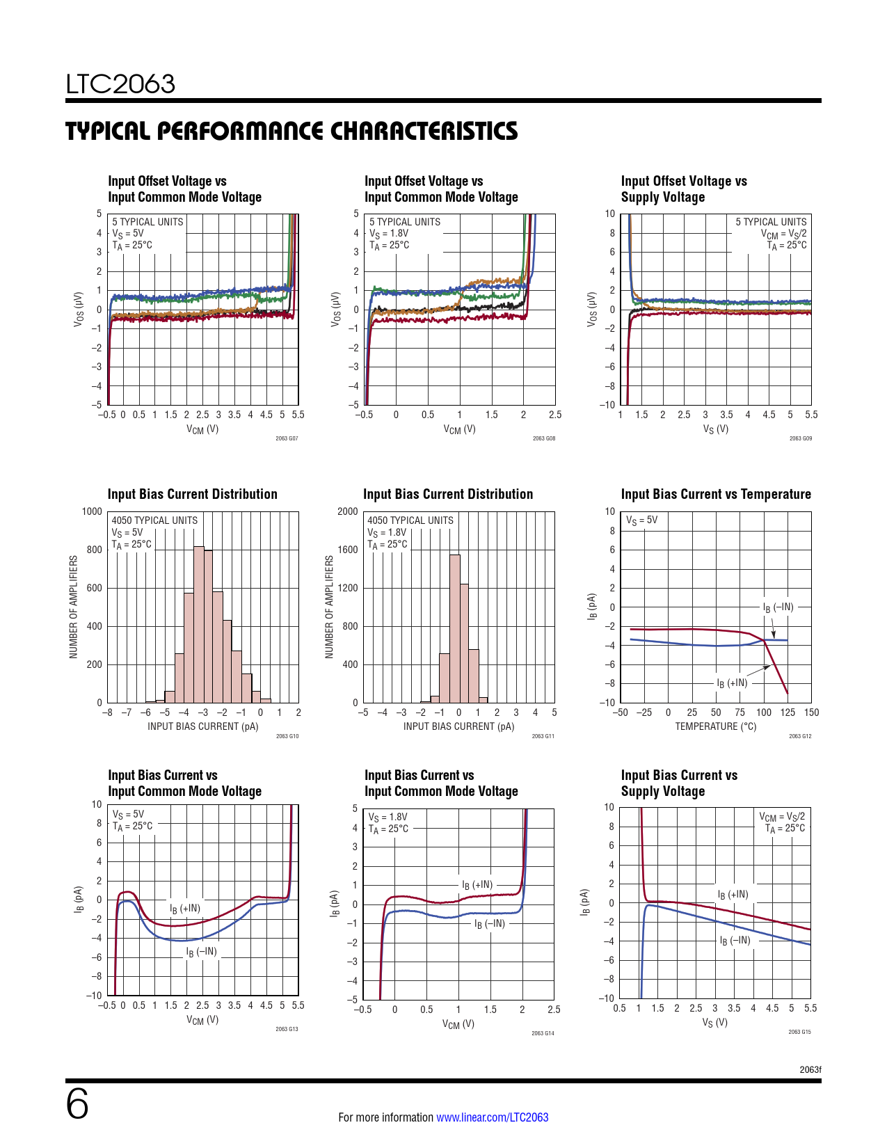

Typical perForMance characTerisTics. Input Offset Voltage vs. Input Common Mode Voltage. Supply Voltage
LTC2063
Typical perForMance characTerisTics Input Offset Voltage vs Input Offset Voltage vs Input Offset Voltage vs Input Common Mode Voltage Input Common Mode Voltage Supply Voltage
5 5 10 5 TYPICAL UNITS 5 TYPICAL UNITS 5 TYPICAL UNITS 4 VS = 5V 4 VS = 1.8V 8 VCM = VS/2 TA = 25°C T T 3 A = 25°C 3 A = 25°C 6 2 2 4 1 1 2 V) V) V) (µ 0 (µ 0 (µ 0 V OS –1 V OS –1 V OS –2 –2 –2 –4 –3 –3 –6 –4 –4 –8 –5 –5 –10 –0.5 0 0.5 1 1.5 2 2.5 3 3.5 4 4.5 5 5.5 –0.5 0 0.5 1 1.5 2 2.5 1 1.5 2 2.5 3 3.5 4 4.5 5 5.5 VCM (V) VCM (V) VS (V) 2063 G07 2063 G08 2063 G09
Input Bias Current Distribution Input Bias Current Distribution Input Bias Current vs Temperature
1000 2000 10 4050 TYPICAL UNITS 4050 TYPICAL UNITS VS = 5V VS = 5V VS = 1.8V 8 800 TA = 25°C 1600 TA = 25°C 6 4 600 1200 2 0 I (pA) B (–IN) I B 400 800 –2 –4 NUMBER OF AMPLIFIERS NUMBER OF AMPLIFIERS 200 400 –6 –8 IB (+IN) 0 0 –10 –8 –7 –6 –5 –4 –3 –2 –1 0 1 2 –5 –4 –3 –2 –1 0 1 2 3 4 5 –50 –25 0 25 50 75 100 125 150 INPUT BIAS CURRENT (pA) INPUT BIAS CURRENT (pA) TEMPERATURE (°C) 2063 G10 2063 G11 2063 G12
Input Bias Current vs Input Bias Current vs Input Bias Current vs Input Common Mode Voltage Input Common Mode Voltage Supply Voltage
10 10 V 5 S = 5V V V 8 CM = VS/2 T S = 1.8V A = 25°C 4 TA = 25°C 8 TA = 25°C 6 3 6 4 2 4 2 1 IB (+IN) 2 0 I (pA) B (+IN) 0 I B I 0 (pA) B (+IN) (pA) –2 I B I B –1 IB (–IN) –2 –4 –2 –4 IB (–IN) IB (–IN) –6 –3 –6 –8 –4 –8 –10 –10 –0.5 0 0.5 1 1.5 2 2.5 3 3.5 4 4.5 5 5.5 –5–0.5 0 0.5 1 1.5 2 2.5 0.5 1 1.5 2 2.5 3 3.5 4 4.5 5 5.5 VCM (V) V VS (V) 2063 G13 CM (V) 2063 G14 2063 G15 2063f 6 For more information www.linear.com/LTC2063 Document Outline Features Applications Typical Application Description Absolute Maximum Ratings Pin Configuration Order Information Electrical Characteristics Typical Performance Characteristics Pin Functions Block Diagram Typical Applications Typical Application Related Parts
