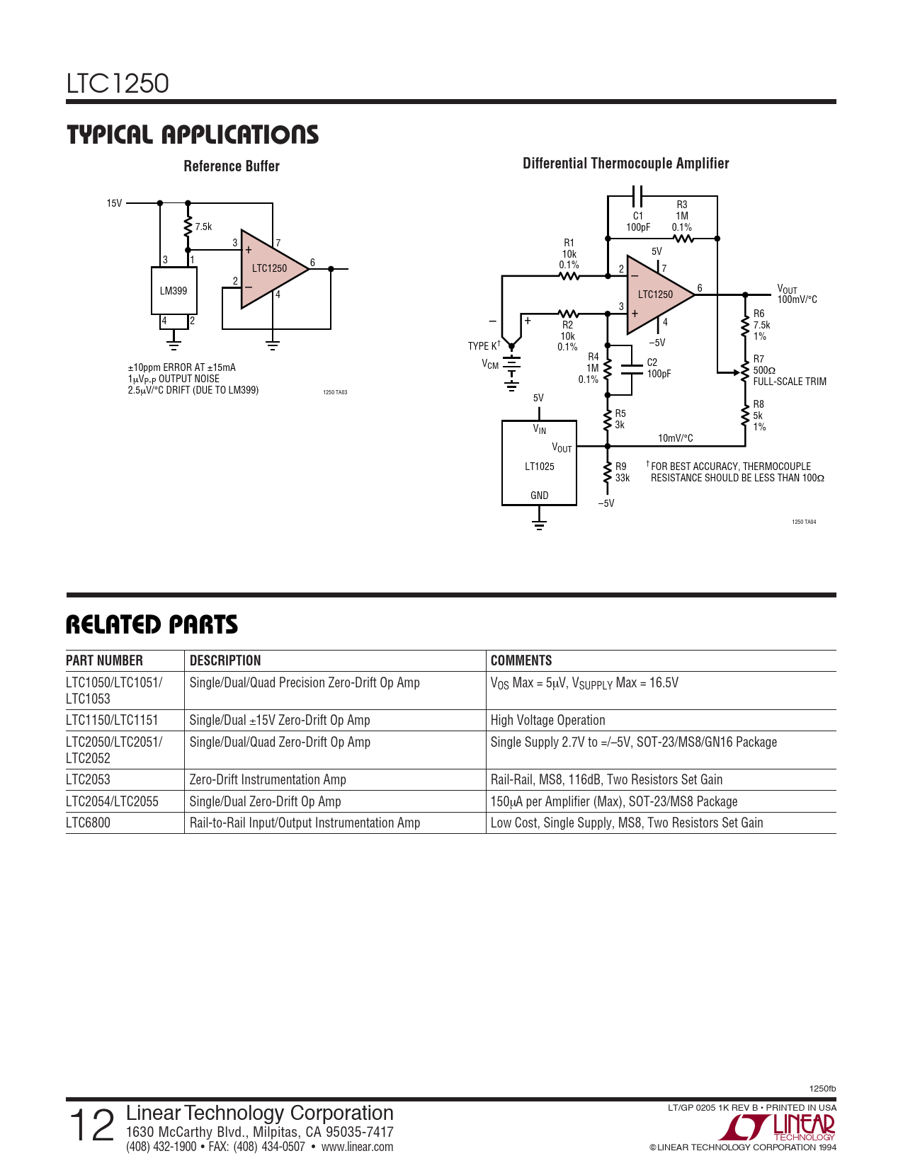

O U TYPICAL APPLICATI S Reference Buffer Differential Thermocouple Amplifier
15V R3 C1 1M 7.5k 100pF 0.1% 3 7 R1 + 5V 10k 3 1 6 0.1% LTC1250 2 7 – 2 LM399 – 6 VOUT 4 LTC1250 100mV/°C 3 + R6 4 2 – + 4 R2 7.5k 10k 1% TYPE K† –5V 0.1% R4 R7 V C2 CM ±10ppm ERROR AT ±15mA 1M 500Ω 100pF 1µVP-P OUTPUT NOISE 0.1% FULL-SCALE TRIM 2.5µV/°C DRIFT (DUE TO LM399) 1250 TA03 5V R8 R5 5k 3k 1% VIN 10mV/°C VOUT LT1025 R9 † FOR BEST ACCURACY, THERMOCOUPLE 33k RESISTANCE SHOULD BE LESS THAN 100Ω GND –5V 1250 TA04
