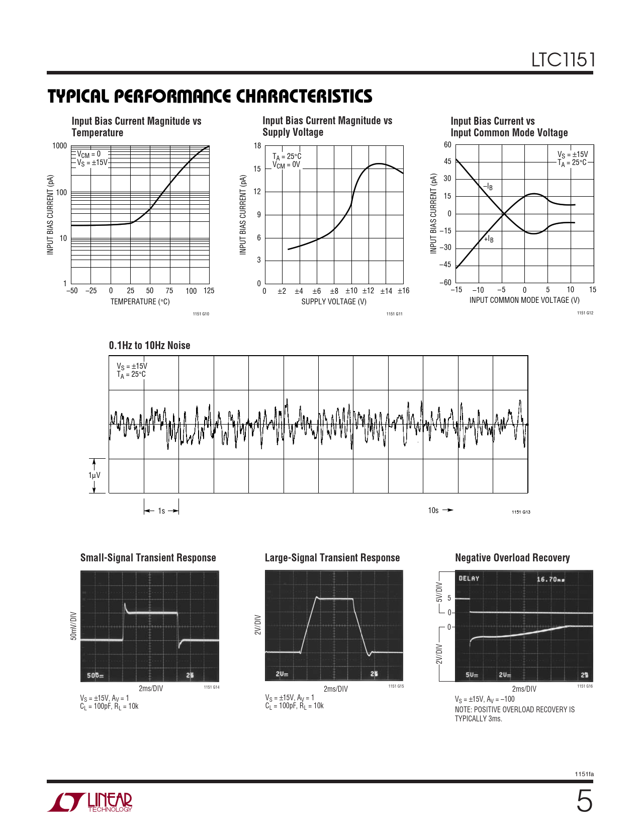

TYPICAL PERFOR A CE CHARACTERISTICS. Input Bias Current Magnitude vs. Input Bias Current vs. Temperature. Supply Voltage
LTC1151
W U TYPICAL PERFOR A CE CHARACTERISTICS Input Bias Current Magnitude vs Input Bias Current Magnitude vs Input Bias Current vs Temperature Supply Voltage Input Common Mode Voltage
1000 18 60 VCM = 0 T V A = 25°C S = ±15V VS = ±15V V 45 TA = 25°C 15 CM = 0V 30 –IB 100 12 15 9 0 –15 10 6 +IB –30 INPUT BIAS CURRENT (pA) INPUT BIAS CURRENT (pA) INPUT BIAS CURRENT (pA) 3 –45 1 0 –60 –50 –25 0 25 50 75 100 125 0 ±2 ±4 ±6 ±8 ±10 ±12 ±14 ±16 –15 –10 –5 0 5 10 15 TEMPERATURE (°C) SUPPLY VOLTAGE (V) INPUT COMMON MODE VOLTAGE (V) 1151 G10 1151 G11 1151 G12
0.1Hz to 10Hz Noise
VS = ±15V TA = 25°C 1µV 1s 10s 1151 G13
Small-Signal Transient Response Large-Signal Transient Response Negative Overload Recovery
/DIV 5 5V 0 /DIV /DIV 0 2V 50mV /DIV 2V 2ms/DIV 1151 G14 2ms/DIV 1151 G15 2ms/DIV 1151 G16 VS = ±15V, AV = 1 VS = ±15V, AV = 1 VS = ±15V, AV = –100 CL = 100pF, RL = 10k CL = 100pF, RL = 10k NOTE: POSITIVE OVERLOAD RECOVERY IS TYPICALLY 3ms. 1151fa 5
