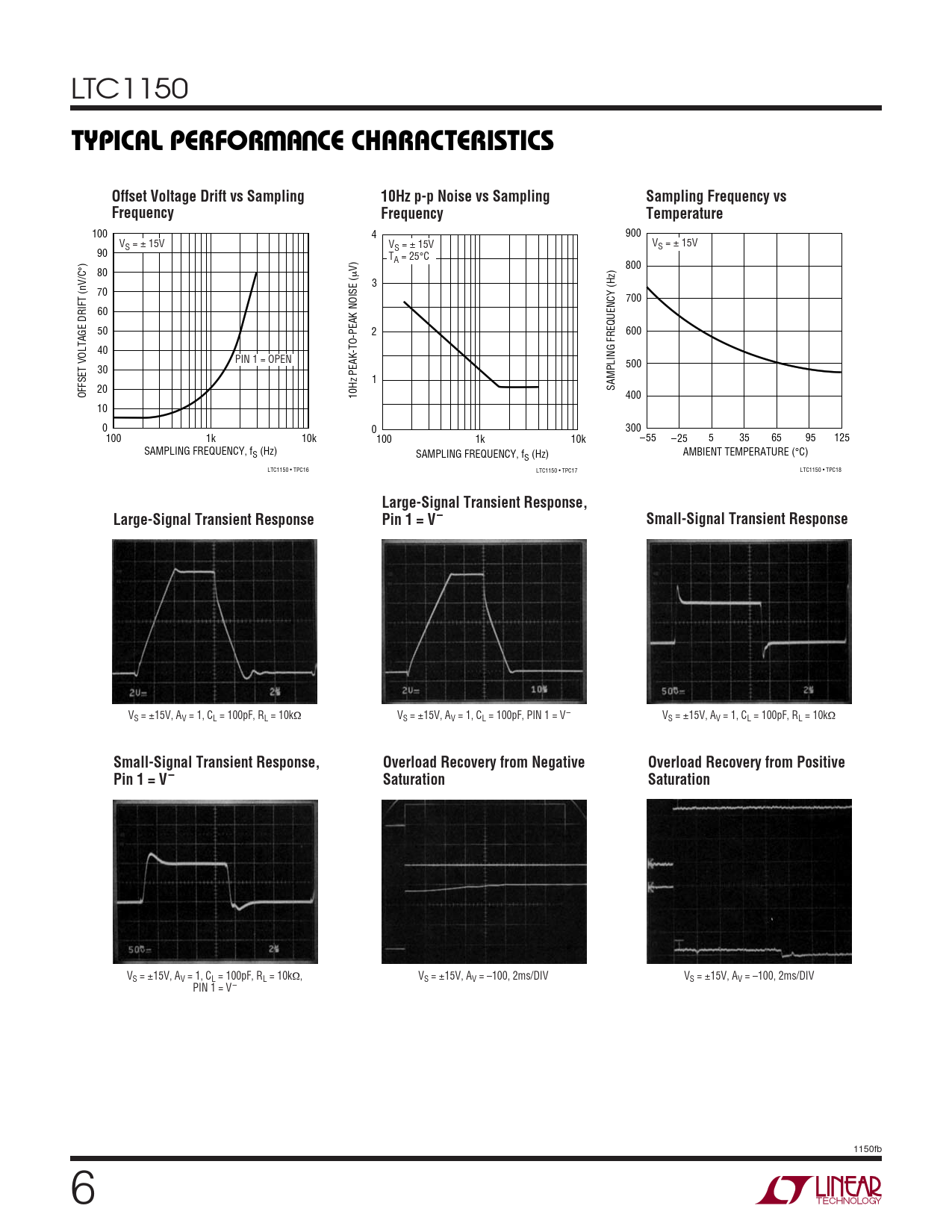

TYPICAL PERFOR A CE CHARACTERISTICS. Offset Voltage Drift vs Sampling. 10Hz p-p Noise vs Sampling. Sampling Frequency vs
LTC1150
W U TYPICAL PERFOR A CE CHARACTERISTICS Offset Voltage Drift vs Sampling 10Hz p-p Noise vs Sampling Sampling Frequency vs Frequency Frequency Temperature
100 4 900 V V V S = ± 15V S = ± 15V S = ± 15V 90 TA = 25°C 800 °) V) 80 µ 3 70 700 60 50 2 600 40 PIN 1 = OPEN 500 30 1 SAMPLING FREQUENCY (Hz) 20 OFFSET VOLTAGE DRIFT (nV/C 10Hz PEAK-TO-PEAK NOISE ( 400 10 0 0 300 100 1k 10k 100 1k 10k –55 –25 5 35 65 95 125 SAMPLING FREQUENCY, f SAMPLING FREQUENCY, f AMBIENT TEMPERATURE ( S (Hz) °C) S (Hz) LTC1150 • TPC16 LTC1150 • TPC17 LTC1150 • TPC18
Large-Signal Transient Response, Large-Signal Transient Response Pin 1 = V– Small-Signal Transient Response
VS = ±15V, AV = 1, CL = 100pF, RL = 10kΩ VS = ±15V, AV = 1, CL = 100pF, PIN 1 = V– VS = ±15V, AV = 1, CL = 100pF, RL = 10kΩ
Small-Signal Transient Response, Overload Recovery from Negative Overload Recovery from Positive Pin 1 = V– Saturation Saturation
VS = ±15V, AV = 1, CL = 100pF, RL = 10kΩ, VS = ±15V, AV = –100, 2ms/DIV VS = ±15V, AV = –100, 2ms/DIV PIN 1 = V– 1150fb 6
