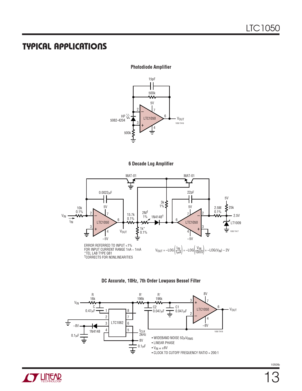

TYPICAL APPLICATI. Photodiode Amplifier. 6 Decade Log Amplifier. DC Accurate, 10Hz, 7th Order Lowpass Bessel Filter
TYPICAL APPLICATI Photodiode Amplifier 6 Decade Log Amplifier DC Accurate, 10Hz, 7th Order Lowpass Bessel Filter
LTC1050
O U TYPICAL APPLICATI S Photodiode Amplifier
15pF 500k 5V 2 – 7 HP 6 LTC1050 VOUT 5082-4204 3 + 1050 TA16 4 500k
MAT-01 MAT-01 0.0022µF 22pF 5V 3k 5V 1% 10k 5V 2.5M 25k 0.1% 2 2M† 0.1% 7 V 15.7k IN – 7 2 1% – 2.5V 0.1% 1N4148† I 6 6 IN LTC1050 LTC1050 LT1009 3 + 3 1k* + 4 VOUT 4 1050 TA17 0.1% –5V –5V ERROR REFERRED TO INPUT <1% IIN FOR INPUT CURRENT RANGE 1nA ~ 1mA VOUT = –LOG = –LOG = –LOG(V ( ) VIN ( ) 1µA IN) – 2V *TEL LAB TYPE Q81 10mV †CORRECTS FOR NONLINEARITIES
