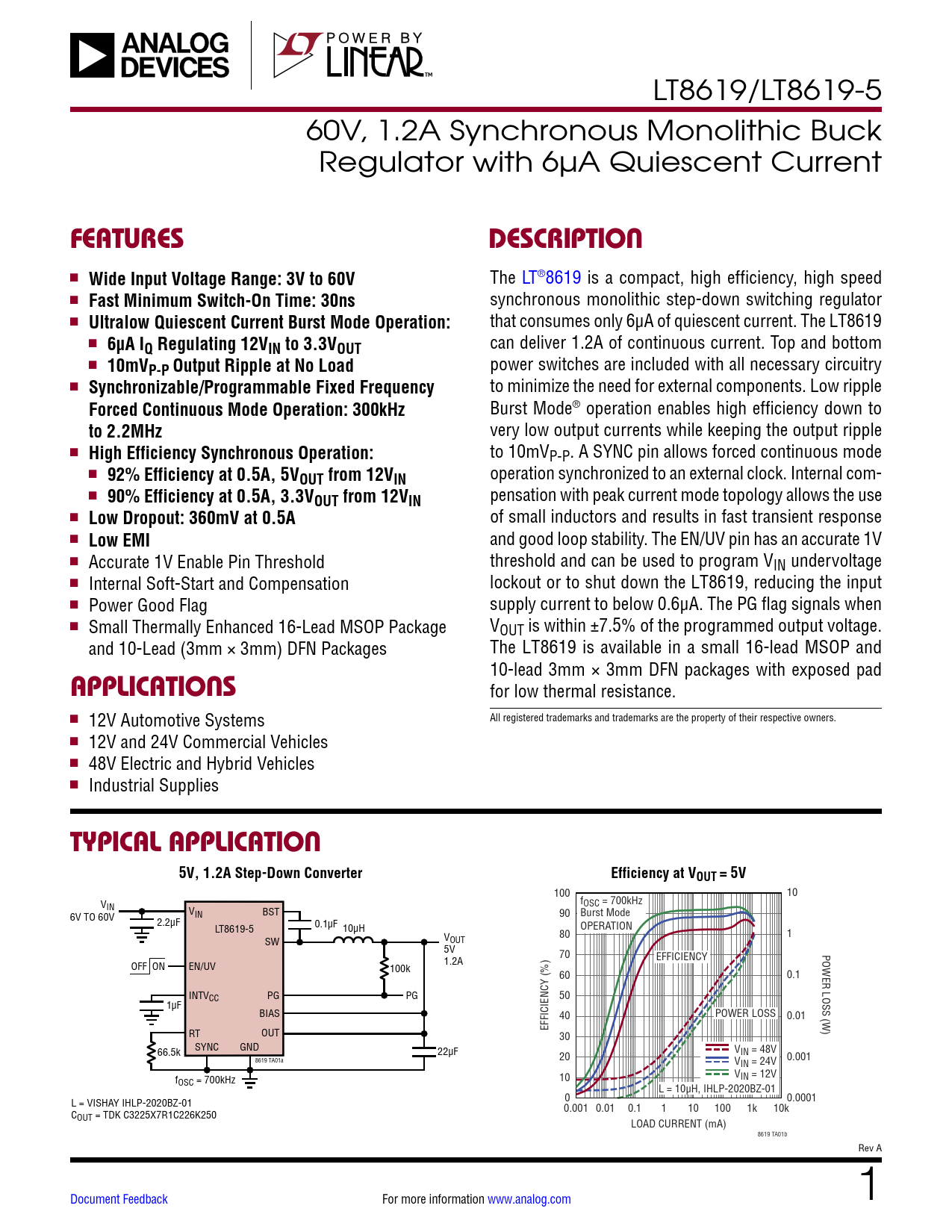

TYPICAL APPLICATION 5V, 1.2A Step-Down Converter Efficiency at V Efficiency at VOUT OUT = 5V = 5V
100 10 V OSC f = 700kHz IN VIN BST 90 Burst Mode 6V TO 60V 2.2µF 0.1µF OPERATION LT8619-5 10µH 80 1 VOUT SW 5V 70 EFFICIENCY POWER LOSS (W) OFF ON 1.2A EN/UV 100k 60 0.1 INTVCC PG PG 50 1µF BIAS 40 POWER LOSS 0.01 EFFICIENCY (%) RT OUT 30 SYNC GND 22µF V = 48V 66.5k IN 8619 TA01a 20 V = 24V 0.001 IN V = 12V f 10 IN OSC = 700kHz L = 10µH, IHLP-2020BZ-01 0 0.0001 L = VISHAY IHLP-2020BZ-01 0.001 0.01 0.1 1 10 100 1k 10k COUT = TDK C3225X7R1C226K250 LOAD CURRENT (mA) 8619 TA01b Rev A Document Feedback For more information www.analog.com 1 Document Outline Features Applications Typical Application Description Absolute Maximum Ratings Order Information Electrical Characteristics Typical Performance Characteristics Pin Functions Block Diagram Operation Applications Information Revision History Typical Application Related Parts
