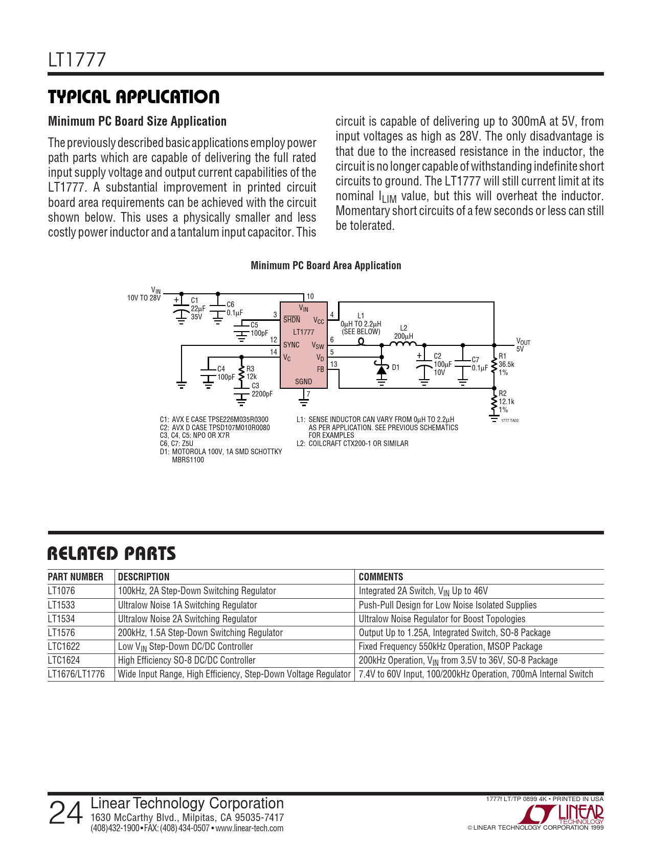

U TYPICAL APPLICATION Minimum PC Board Size Application
circuit is capable of delivering up to 300mA at 5V, from input voltages as high as 28V. The only disadvantage is The previously described basic applications employ power that due to the increased resistance in the inductor, the path parts which are capable of delivering the full rated circuit is no longer capable of withstanding indefinite short input supply voltage and output current capabilities of the circuits to ground. The LT1777 will still current limit at its LT1777. A substantial improvement in printed circuit nominal ILIM value, but this will overheat the inductor. board area requirements can be achieved with the circuit Momentary short circuits of a few seconds or less can still shown below. This uses a physically smaller and less be tolerated. costly power inductor and a tantalum input capacitor. This
Minimum PC Board Area Application
VIN 10 10V TO 28V + C1 C6 22 V µF IN 0.1µF 3 4 35V L1 SHDN VCC C5 0µH TO 2.2µH L2 100pF LT1777 (SEE BELOW) 200µH 12 6 V SYNC V OUT SW 5V 14 5 V V + C D C2 R1 C7 13 C4 R3 D1 100µF 36.5k FB 0.1µF 10V 1% 100pF 12k SGND C3 2200pF 7 R2 12.1k 1% C1: AVX E CASE TPSE226M035R0300 L1: SENSE INDUCTOR CAN VARY FROM 0µH TO 2.2µH 1777 TA03 C2: AVX D CASE TPSD107M010R0080 AS PER APPLICATION. SEE PREVIOUS SCHEMATICS C3, C4, C5: NPO OR X7R FOR EXAMPLES C6, C7: Z5U L2: COILCRAFT CTX200-1 OR SIMILAR D1: MOTOROLA 100V, 1A SMD SCHOTTKY MBRS1100
