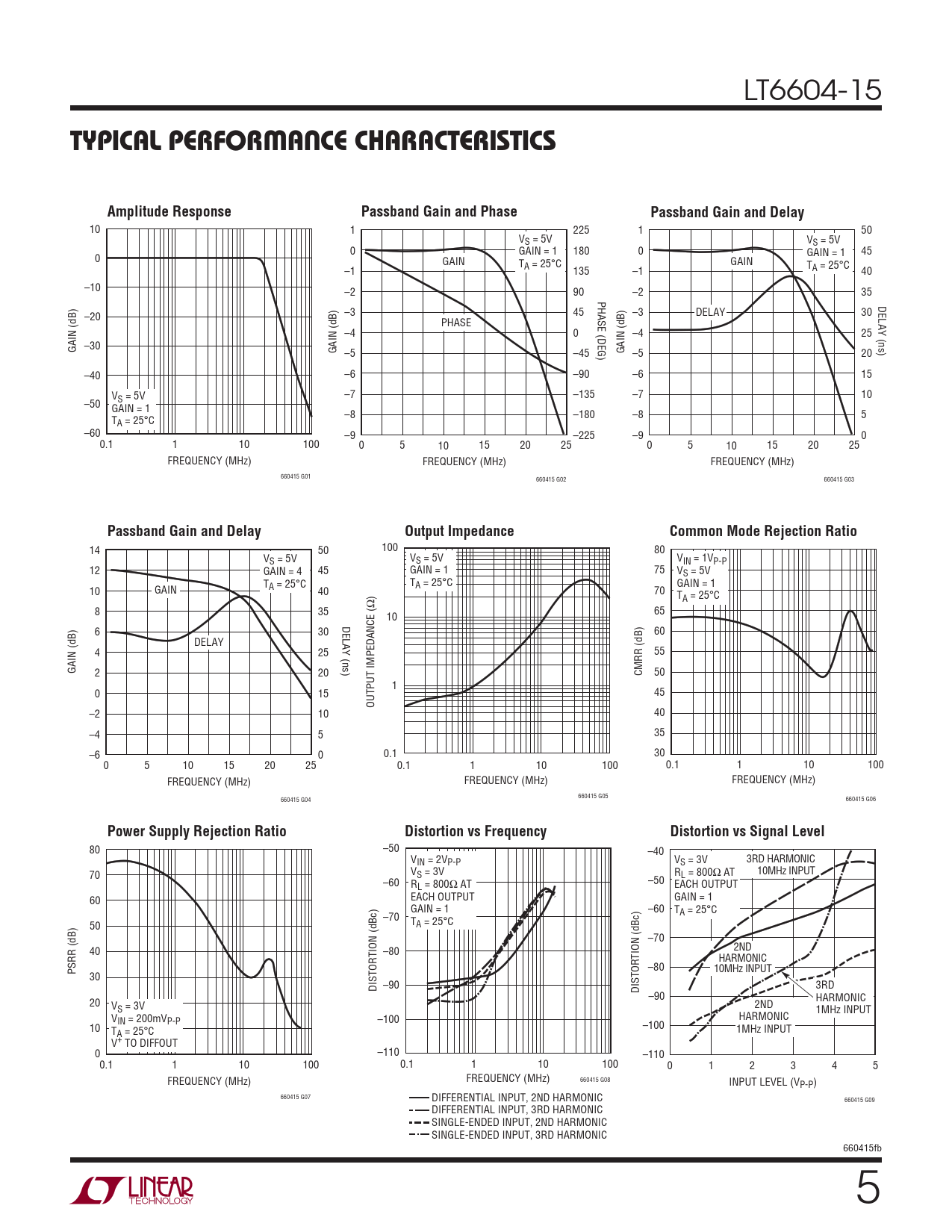

TYPICAL PERFORMANCE CHARACTERISTICS. Amplitude Response. Passband Gain and Phase. Passband Gain and Delay. Output Impedance
TYPICAL PERFORMANCE CHARACTERISTICS Amplitude Response Passband Gain and Phase Passband Gain and Delay Output Impedance
LT6604-15
10 1 225 1 50 VS = 5V VS = 5V 0 GAIN = 1 180 0 GAIN = 1 45 0 GAIN T GAIN T –1 A = 25°C 135 –1 A = 25°C 40 –10 –2 90 –2 35 PHASE (DEG) DELAY (ns) –20 –3 45 –3 DELAY 30 PHASE –4 0 –4 25 GAIN (dB) –30 GAIN (dB) –5 –45 GAIN (dB) –5 20 –40 –6 –90 –6 15 V –7 –135 –7 10 –50 S = 5V GAIN = 1 –8 –180 –8 5 TA = 25°C –60 –9 –225 –9 0 0.1 1 10 100 0 5 10 15 20 25 0 5 10 15 20 25 FREQUENCY (MHz) FREQUENCY (MHz) FREQUENCY (MHz) 660415 G01 660415 G02 660415 G03
Passband Gain and Delay Output Impedance Common Mode Rejection Ratio
14 50 100 80 VS = 5V VS = 5V VIN = 1VP-P 12 GAIN = 4 45 GAIN = 1 75 VS = 5V T TA = 25°C GAIN = 1 10 A = 25°C GAIN 40 70 TA = 25°C 8 35 65 10 DELAY 6 30 60 DELAY 4 25 ( 55 ns GAIN (dB) 2 20 CMRR (dB) 50 1 0 15 45 OUTPUT IMPEDANCE (Ω) –2 10 40 –4 5 35 –6 0 0.1 30 0 5 10 15 20 25 0.1 1 10 100 0.1 1 10 100 FREQUENCY (MHz) FREQUENCY (MHz) FREQUENCY (MHz) 660415 G05 660415 G04 660415 G06
Power Supply Rejection Ratio Distortion vs Frequency Distortion vs Signal Level
80 –50 –40 VIN = 2VP-P VS = 3V 3RD HARMONIC 70 VS = 3V RL = 800Ω AT 10MHz INPUT –60 R –50 L = 800Ω AT EACH OUTPUT 60 EACH OUTPUT GAIN = 1 GAIN = 1 –60 T –70 A = 25°C 50 TA = 25°C –70 40 –80 2ND TION (dBc) HARMONIC PSRR (dB) –80 10MHz INPUT 30 DISTORTION (dBc) –90 DISTOR 3RD –90 20 HARMONIC V 2ND S = 3V 1MHz INPUT V HARMONIC IN = 200mVP-P –100 10 –100 T 1MHz INPUT A = 25°C V+ TO DIFFOUT 0 –110 –110 0.1 1 10 100 0.1 1 10 100 0 1 2 3 4 5 FREQUENCY (MHz) FREQUENCY (MHz) 660415 G08 INPUT LEVEL (VP-P) 660415 G07 DIFFERENTIAL INPUT, 2ND HARMONIC 660415 G09 DIFFERENTIAL INPUT, 3RD HARMONIC SINGLE-ENDED INPUT, 2ND HARMONIC SINGLE-ENDED INPUT, 3RD HARMONIC 660415fb 5
