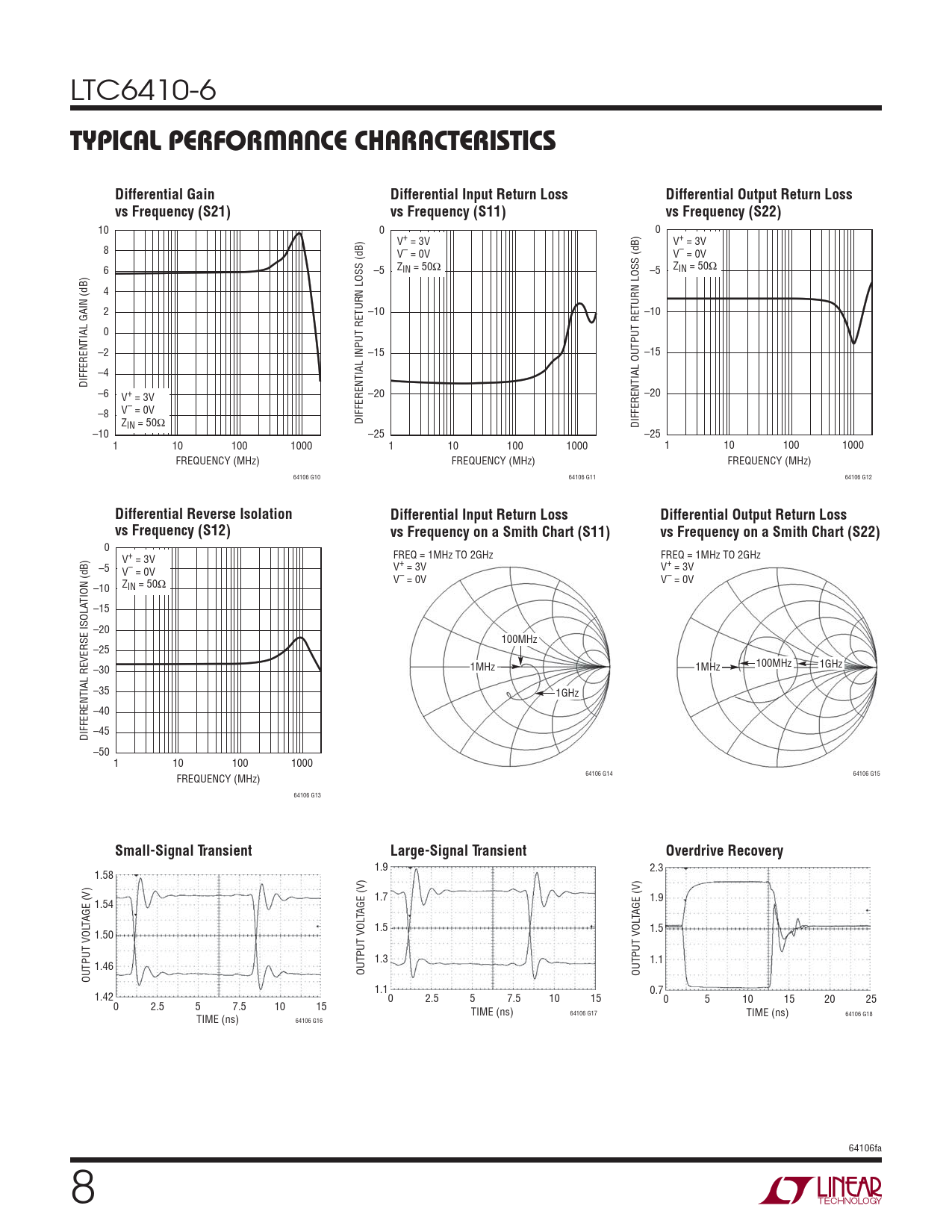

TYPICAL PERFORMANCE CHARACTERISTICS. Differential Gain. Differential Input Return Loss. Differential Output Return Loss
LTC6410-6
TYPICAL PERFORMANCE CHARACTERISTICS Differential Gain Differential Input Return Loss Differential Output Return Loss vs Frequency (S21) vs Frequency (S11) vs Frequency (S22)
10 0 0 V+ = 3V V+ = 3V 8 V– = 0V V– = 0V 6 –5 ZIN = 50Ω –5 ZIN = 50Ω 4 2 –10 –10 0 –2 –15 –15 –4 DIFFERENTIAL GAIN (dB) –6 V+ = 3V –20 –20 –8 V– = 0V Z DIFFERENTIAL INPUT RETURN LOSS (dB) IN = 50Ω DIFFERENTIAL OUTPUT RETURN LOSS (dB) –10 –25 –25 1 10 100 1000 1 10 100 1000 1 10 100 1000 FREQUENCY (MHz) FREQUENCY (MHz) FREQUENCY (MHz) 64106 G10 64106 G11 64106 G12
Differential Reverse Isolation Differential Input Return Loss Differential Output Return Loss vs Frequency (S12) vs Frequency on a Smith Chart (S11) vs Frequency on a Smith Chart (S22)
0 V+ = 3V FREQ = 1MHz TO 2GHz FREQ = 1MHz TO 2GHz –5 V– = 0V V+ = 3V V+ = 3V V– = 0V V– = 0V –10 ZIN = 50Ω TION (dB) –15 –20 100MHz –25 100MHz 1GHz –30 1MHz 1MHz –35 1GHz –40 –45 DIFFERENTIAL REVERSE ISOLA –50 1 10 100 1000 FREQUENCY (MHz) 64106 G14 64106 G15 64106 G13
Small-Signal Transient Large-Signal Transient Overdrive Recovery
1.9 2.3 1.58 1.7 1.9 1.54 TAGE (V) TAGE (V) TAGE (V) 1.5 1.5 1.50 1.3 1.1 1.46 OUTPUT VOL OUTPUT VOL OUTPUT VOL 1.1 0.7 1.42 0 2.5 5 7.5 10 15 0 5 10 15 20 25 0 2.5 5 7.5 10 15 TIME (ns) 64106 G17 TIME (ns) 64106 G18 TIME (ns) 64106 G16 64106fa 8
