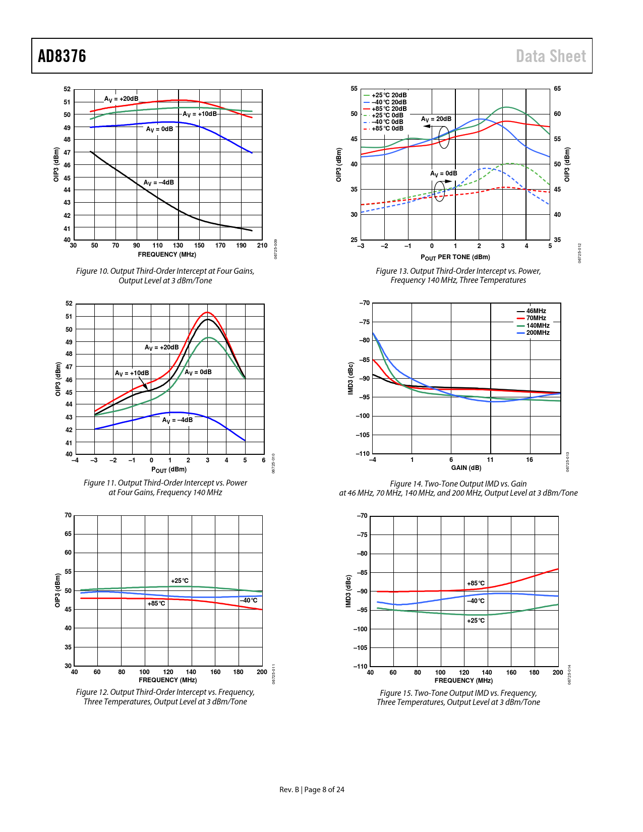

AD8376. Data Sheet. +25°C 20dB. V = +20dB. –40°C 20dB +85°C 20dB. AV = +10dB. +25°C 0dB. –40°C 0dB. V = 20dB. AV = 0dB. +85°C 0dB. m 47. ( 46
AD8376 Data Sheet 52 55 65 +25°C 20dB A 51 V = +20dB –40°C 20dB +85°C 20dB 50 AV = +10dB 50 60 +25°C 0dB A –40°C 0dB V = 20dB 49 AV = 0dB +85°C 0dB 48 45 55 ) ) ) m 47 m m B B B d d d ( 46 40 50 ( ( 3 3 3 P P AV = 0dB 45 OI A OI OIP V = –4dB 44 35 45 43 42 30 40 41 40 25 35

72 06 Figure 10. Output Third-Order Intercept at Four Gains, Figure 13. Output Third-Order Intercept vs. Power, Output Level at 3 dBm/Tone Frequency 140 MHz, Three Temperatures
52 –70 46MHz 51 70MHz –75 140MHz 50 200MHz 49 –80 AV = +20dB 48 ) –85 m 47 B Bc) A A d V = +10dB V = 0dB d ( 46 –90 3 D3 ( 45 OIP IM –95 44 43 –100 AV = –4dB 42 –105 41 40

06 06 Figure 11. Output Third-Order Intercept vs. Power Figure 14. Two-Tone Output IMD vs. Gain at Four Gains, Frequency 140 MHz at 46 MHz, 70 MHz, 140 MHz, and 200 MHz, Output Level at 3 dBm/Tone
70 –70 65 –75 60 –80 55 ) –85 m +25°C B Bc) +85°C d d ( 50 –90 3 P D3 ( +85°C –40°C –40°C OI IM 45 –95 +25°C 40 –100 35 –105 30

06 Figure 12. Output Third-Order Intercept vs. Frequency, Figure 15. Two-Tone Output IMD vs. Frequency, Three Temperatures, Output Level at 3 dBm/Tone Three Temperatures, Output Level at 3 dBm/Tone Rev. B | Page 8 of 24 Document Outline Features Applications Functional Block Diagram General Description Revision History Specifications Absolute Maximum Ratings ESD Caution Pin Configuration and Function Descriptions Typical Performance Characteristics Circuit Description Basic Structure Input System Output Amplifier Gain Control Applications Basic Connections Single-Ended-to-Differential Conversion Broadband Operation ADC Interfacing Layout Considerations Characterization Test Circuits Differential-to-Differential Characterization Evaluation Board Outline Dimensions Ordering Guide
