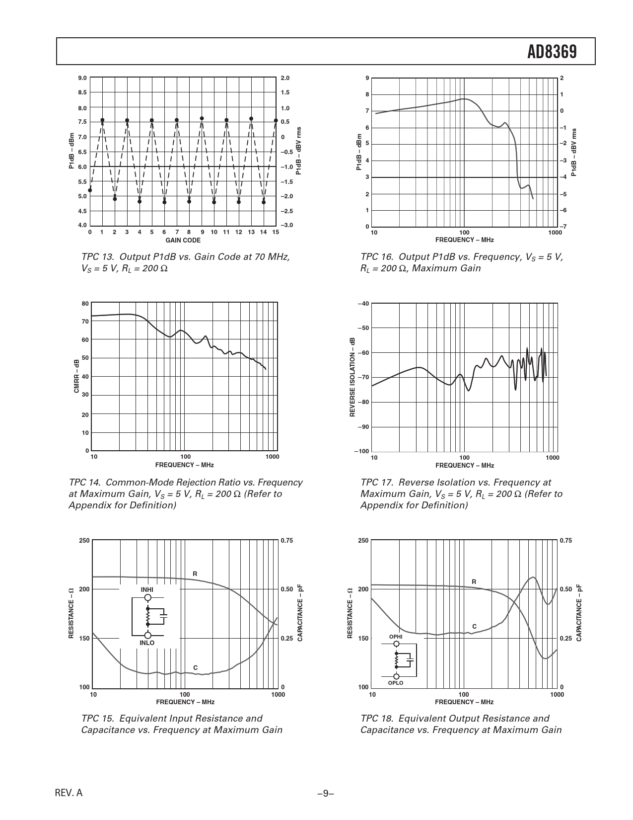

AD8369. 9.0. 2.0. 8.5. 1.5. 8.0. 1.0. 7.5. 0.5. 7.0. 6.5. –0.5. P1dB – dBm 6.0. –1.0. P1dB – dBm. P1dB – dBV rms. 5.5. –1.5. 5.0. –2.0. 4.5. –2.5. 4.0. –3.0. 10 11 12
AD8369 9.0 2.0 8.5 1.5 8.0 1.0 7.5 0.5 7.0 6.5 –0.5 P1dB – dBm 6.0 –1.0 P1dB – dBm P1dB – dBV rms 5.5 –1.5 5.0 –2.0 4.5 –2.5 4.0 –3.0 10 11 12
AD8369 9.0 2.0 9 2 8.5 1.5 8 1 8.0 1.0 7 0 7.5 0.5 6 –1 7.0 0 5 –2 6.5 –0.5 4 –3 P1dB – dBm 6.0 –1.0 P1dB – dBm P1dB – dBV rms 3 P1dB – dBV rms –4 5.5 –1.5 5.0 –2.0 2 –5 4.5 –2.5 1 –6 4.0 –3.0 0 –7 0 1 2 3 4 5 6 7 8 9 10 11 12 13 14 15 10 100 1000 GAIN CODE FREQUENCY – MHz
TPC 13. Output P1dB vs. Gain Code at 70 MHz, TPC 16. Output P1dB vs. Frequency, VS = 5 V, VS = 5 V, RL = 200 W RL = 200 W, Maximum Gain

100 10 100 1000 10 100 1000 FREQUENCY – MHz FREQUENCY – MHz
TPC 14. Common-Mode Rejection Ratio vs. Frequency TPC 17. Reverse Isolation vs. Frequency at at Maximum Gain, VS = 5 V, RL = 200 W (Refer to Maximum Gain, VS = 5 V, RL = 200 W (Refer to Appendix for Definition) Appendix for Definition)

200 0.50 ANCE – ANCE – pF ANCE – ANCE – pF CIT CIT A C A RESIST 150 0.25 RESIST CAP OPHI 150 0.25 CAP INLO C OPLO 100 0 100 0 10 100 1000 10 100 1000 FREQUENCY – MHz FREQUENCY – MHz
TPC 15. Equivalent Input Resistance and TPC 18. Equivalent Output Resistance and Capacitance vs. Frequency at Maximum Gain Capacitance vs. Frequency at Maximum Gain REV. A –9– Document Outline Features Applications Functional Block Diagram Product Description Specifications Timing Specifications Absolute Maximum Ratings Pin Configuration Typical Performance Characteristics Theroy of Operation Input Attentuator and Output 3 dB Step Fixed Gain Amplifier Input and Output Interfaces Noise and Distortion Offset Control Loop Digital Control Basic Connections Input-Output Interface Reducing Gain Sensitivity to Input and Output Impedance Variation Operation from a Single-Sided Source Interfacing to an ADC PCB Layout Considerations Evaluation Board Evaluation Board Software Appendix Characterization Equipment Definitions of Selected Parameters Composite Waveform Assumption Outline Dimensions Ordering Guide Revision History
