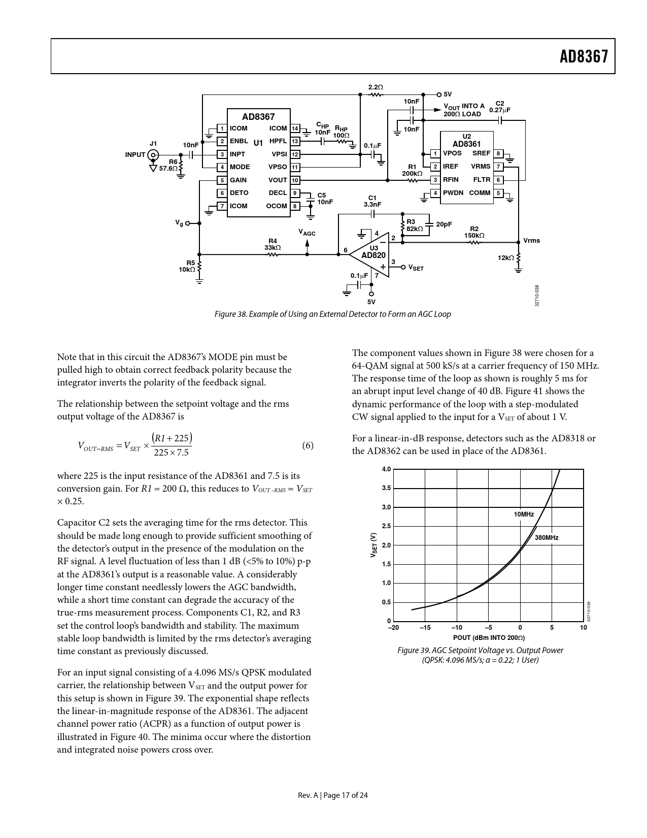

5V
2710- 0 Figure 38. Example of Using an External Detector to Form an AGC Loop Note that in this circuit the AD8367’s MODE pin must be The component values shown in Figure 38 were chosen for a pulled high to obtain correct feedback polarity because the 64-QAM signal at 500 kS/s at a carrier frequency of 150 MHz. integrator inverts the polarity of the feedback signal. The response time of the loop as shown is roughly 5 ms for an abrupt input level change of 40 dB. Figure 41 shows the The relationship between the setpoint voltage and the rms dynamic performance of the loop with a step-modulated output voltage of the AD8367 is CW signal applied to the input for a VSET of about 1 V. (R1+ 225) For a linear-in-dB response, detectors such as the AD8318 or V (6) OUT − = V × RMS SET 225 × 7.5 the AD8362 can be used in place of the AD8361.
4.0
where 225 is the input resistance of the AD8361 and 7.5 is its conversion gain. For R1 = 200 Ω, this reduces to VOUT –RMS = VSET
3.5
× 0.25.
3.0 10MHz
Capacitor C2 sets the averaging time for the rms detector. This
2.5
should be made long enough to provide sufficient smoothing of
) 380MHz (V
the detector’s output in the presence of the modulation on the
2.0 SETV
RF signal. A level fluctuation of less than 1 dB (<5% to 10%) p-p
1.5
at the AD8361’s output is a reasonable value. A considerably longer time constant needlessly lowers the AGC bandwidth,
1.0
while a short time constant can degrade the accuracy of the
0.5
true-rms measurement process. Components C1, R2, and R3 02710-039 set the control loop’s bandwidth and stability. The maximum
