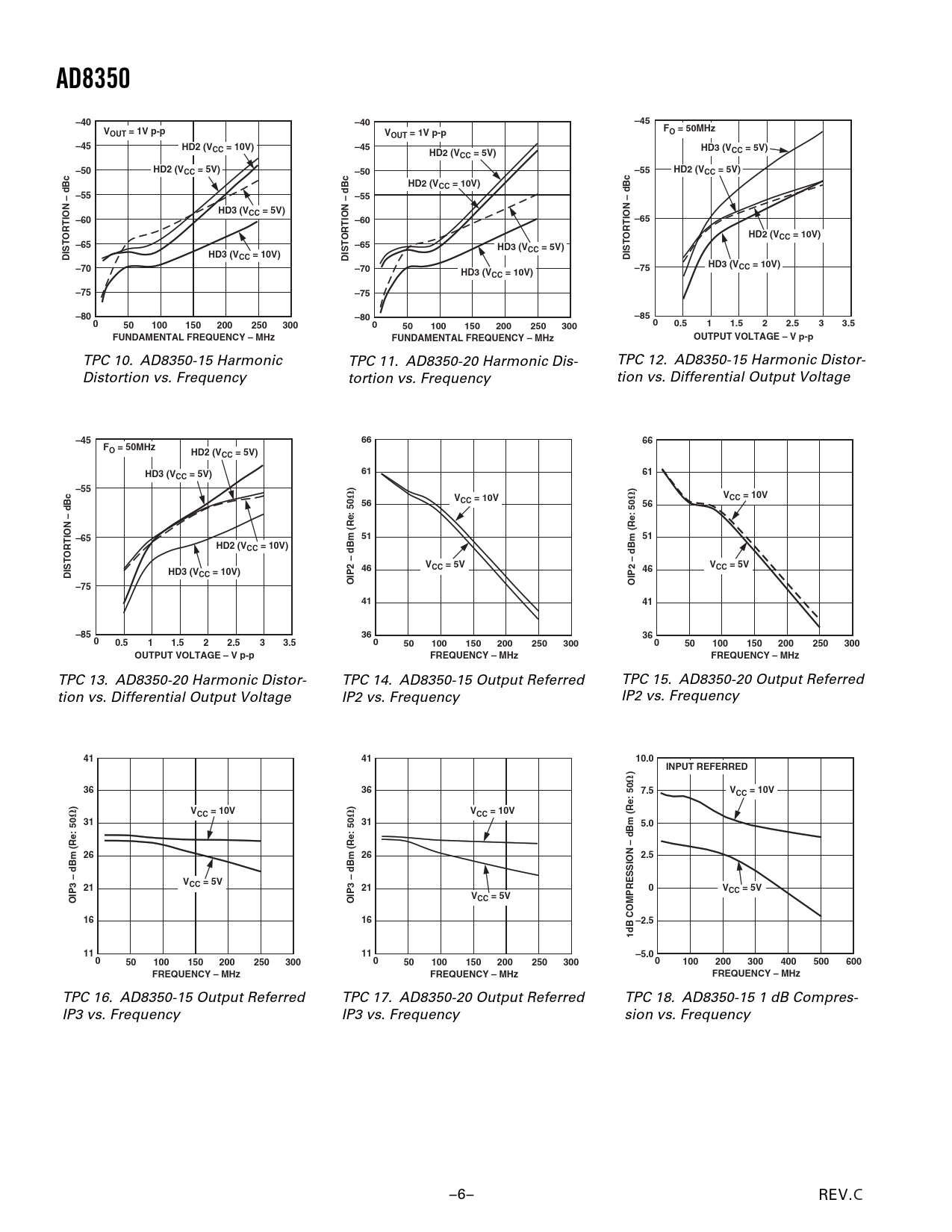

AD8350. –40. –45. OUT = 1V p-p. O = 50MHz. HD2 (VCC = 10V). HD3 (V. HD2 (V. CC = 5V). –50. HD2 (VCC = 5V). –55. HD3 (VCC = 5V). –60. –65
AD8350 –40 –40 –45 V F OUT = 1V p-p V O = 50MHz OUT = 1V p-p –45 HD2 (VCC = 10V) –45 HD3 (V HD2 (V CC = 5V) CC = 5V) –50 HD2 (VCC = 5V) –50 –55 HD2 (VCC = 5V) HD2 (VCC = 10V) –55 –55 HD3 (VCC = 5V) –60 –60 –65 HD2 (VCC = 10V) –65 –65 HD3 (VCC = 5V) DISTORTION – dBc HD3 (VCC = 10V) DISTORTION – dBc DISTORTION – dBc –70 HD3 (V –70 CC = 10V) HD3 (V –75 CC = 10V) –75 –75 –80 –80 –85 0 50 100 150 200 250 300 0 50 100 150 200 250 300 0 0.5 1 1.5 2 2.5 3 3.5 FUNDAMENTAL FREQUENCY – MHz FUNDAMENTAL FREQUENCY – MHz OUTPUT VOLTAGE – V p-p
TPC 10. AD8350-15 Harmonic TPC 11. AD8350-20 Harmonic Dis- TPC 12. AD8350-15 Harmonic Distor- Distortion vs. Frequency tortion vs. Frequency tion vs. Differential Output Voltage
–45 66 66 FO = 50MHz HD2 (VCC = 5V) HD3 (V 61 61 CC = 5V) –55 ) ) V VCC = 10V 56 CC = 10V 56 –65 51 51 HD2 (VCC = 10V) 46 VCC = 5V V 46 CC = 5V DISTORTION – dBc HD3 (VCC = 10V) OIP2 – dBm (Re: 50 OIP2 – dBm (Re: 50 –75 41 41 –85 36 36 0 0.5 1 1.5 2 2.5 3 3.5 0 50 100 150 200 250 300 0 50 100 150 200 250 300 OUTPUT VOLTAGE – V p-p FREQUENCY – MHz FREQUENCY – MHz
TPC 13. AD8350-20 Harmonic Distor- TPC 14. AD8350-15 Output Referred TPC 15. AD8350-20 Output Referred tion vs. Differential Output Voltage IP2 vs. Frequency IP2 vs. Frequency
41 41 10.0 INPUT REFERRED ) 36 36 7.5 VCC = 10V ) ) VCC = 10V VCC = 10V 31 31 5.0 26 26 2.5 V 21 CC = 5V 21 0 VCC = 5V V OIP3 – dBm (Re: 50 OIP3 – dBm (Re: 50 CC = 5V 16 16 –2.5 1dB COMPRESSION – dBm (Re: 50 11 11 –5.0 0 50 100 150 200 250 300 0 50 100 150 200 250 300 0 100 200 300 400 500 600 FREQUENCY – MHz FREQUENCY – MHz FREQUENCY – MHz
TPC 16. AD8350-15 Output Referred TPC 17. AD8350-20 Output Referred TPC 18. AD8350-15 1 dB Compres- IP3 vs. Frequency IP3 vs. Frequency sion vs. Frequency –6– REV. C
