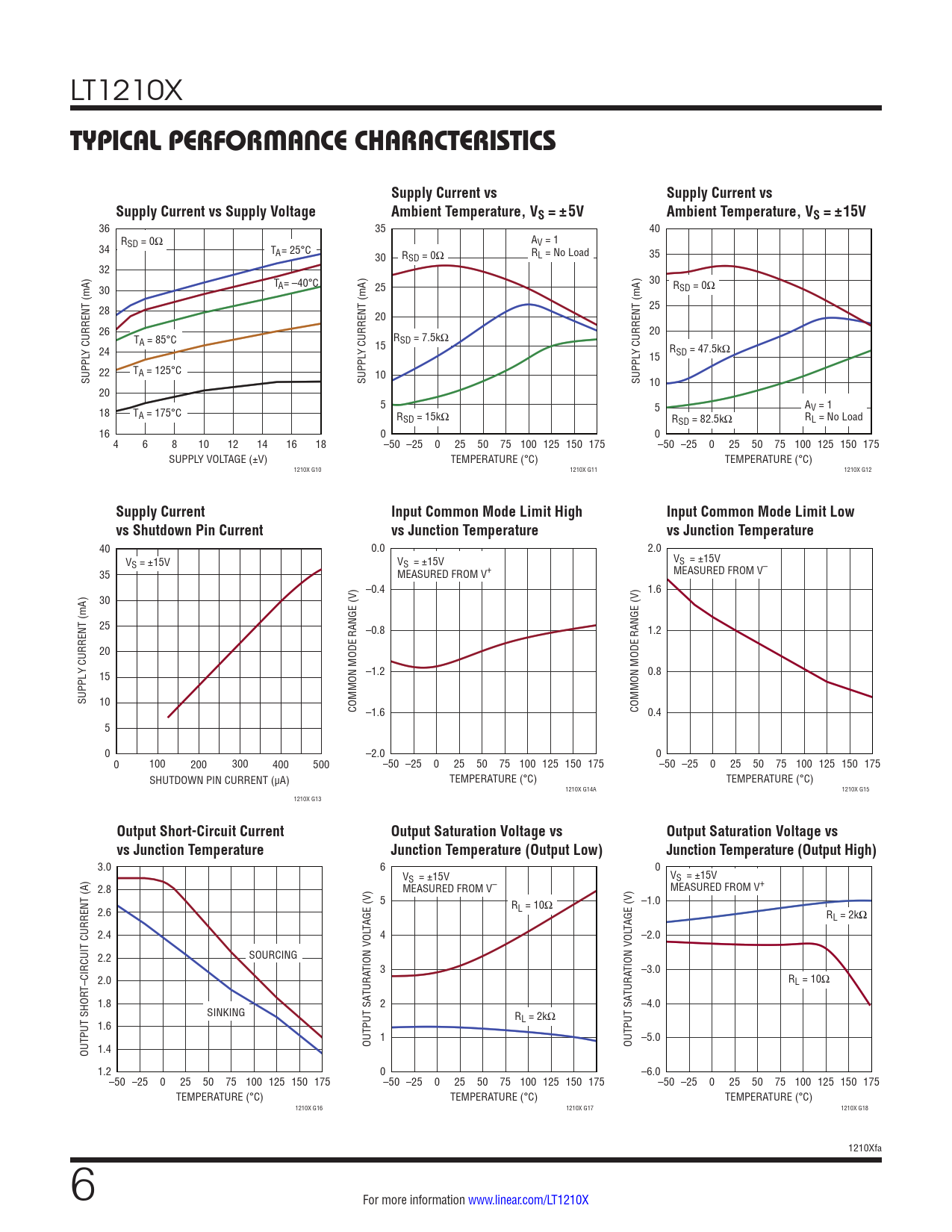

Supply Current vs. Supply Current vs Supply Voltage. Ambient Temperature, VS = ±5V. Ambient Temperature, VS = ±15V
LT1210X TYPICAL PERFORMANCE CHARACTERISTICS
Supply Current vs Supply Current vs Supply Current vs Supply Voltage Ambient Temperature, VS = ±5V Ambient Temperature, VS = ±15V
36 35 40 RSD = 0Ω A 34 V = 1 TA = 25°C R 30 SD = 0Ω RL = No Load 35 32 TA = –40°C 30 30 25 RSD = 0Ω 28 25 20 26 20 TA = 85°C RSD = 7.5kΩ Y CURRENT (mA) 24 15 Y CURRENT (mA) Y CURRENT (mA) RSD = 47.5kΩ 15 22 TA = 125°C SUPPL 10 SUPPL SUPPL 10 20 5 A 18 T 5 V = 1 A = 175°C RSD = 15kΩ RSD = 82.5kΩ RL = No Load 16 0 0 4 6 8 10 12 14 16 18 –50 –25 0 25 50 75 100 125 150 175 –50 –25 0 25 50 75 100 125 150 175 SUPPLY VOLTAGE (±V) TEMPERATURE (°C) TEMPERATURE (°C) 1210X G10 1210X G11 1210X G12
Supply Current Input Common Mode Limit High Input Common Mode Limit Low vs Shutdown Pin Current vs Junction Temperature vs Junction Temperature
40 0.0 2.0 V V S = ±15V VS = ±15V S = ±15V 35 MEASURED FROM V+ MEASURED FROM V– –0.4 1.6 30 25 –0.8 1.2 20 15 –1.2 0.8 SUPPLY CURRENT (mA) 10 COMMON MODE RANGE (V) –1.6 COMMON MODE RANGE (V) 0.4 5 0 –2.0 0 0 100 200 300 400 500 –50 –25 0 25 50 75 100 125 150 175 –50 –25 0 25 50 75 100 125 150 175 SHUTDOWN PIN CURRENT (µA) TEMPERATURE (°C) TEMPERATURE (°C) 1210X G14A 1210X G15 1210X G13
Output Short-Circuit Current Output Saturation Voltage vs Output Saturation Voltage vs vs Junction Temperature Junction Temperature (Output Low) Junction Temperature (Output High)
3.0 6 0 VS = ±15V VS = ±15V 2.8 MEASURED FROM V– MEASURED FROM V+ 5 R –1.0 2.6 L = 10Ω RL = 2kΩ TAGE (V) TAGE (V) 2.4 4 –2.0 2.2 SOURCING TION VOL 3 TION VOL –3.0 2.0 R T–CIRCUIT CURRENT (A) L = 10Ω TURA TURA 1.8 2 –4.0 SINKING RL = 2kΩ 1.6 1 –5.0 1.4 OUTPUT SA OUTPUT SA OUTPUT SHOR 1.2 0 –6.0 –50 –25 0 25 50 75 100 125 150 175 –50 –25 0 25 50 75 100 125 150 175 –50 –25 0 25 50 75 100 125 150 175 TEMPERATURE (°C) TEMPERATURE (°C) TEMPERATURE (°C) 1210X G16 1210X G17 1210X G18 1210Xfa 6 For more information www.linear.com/LT1210X
