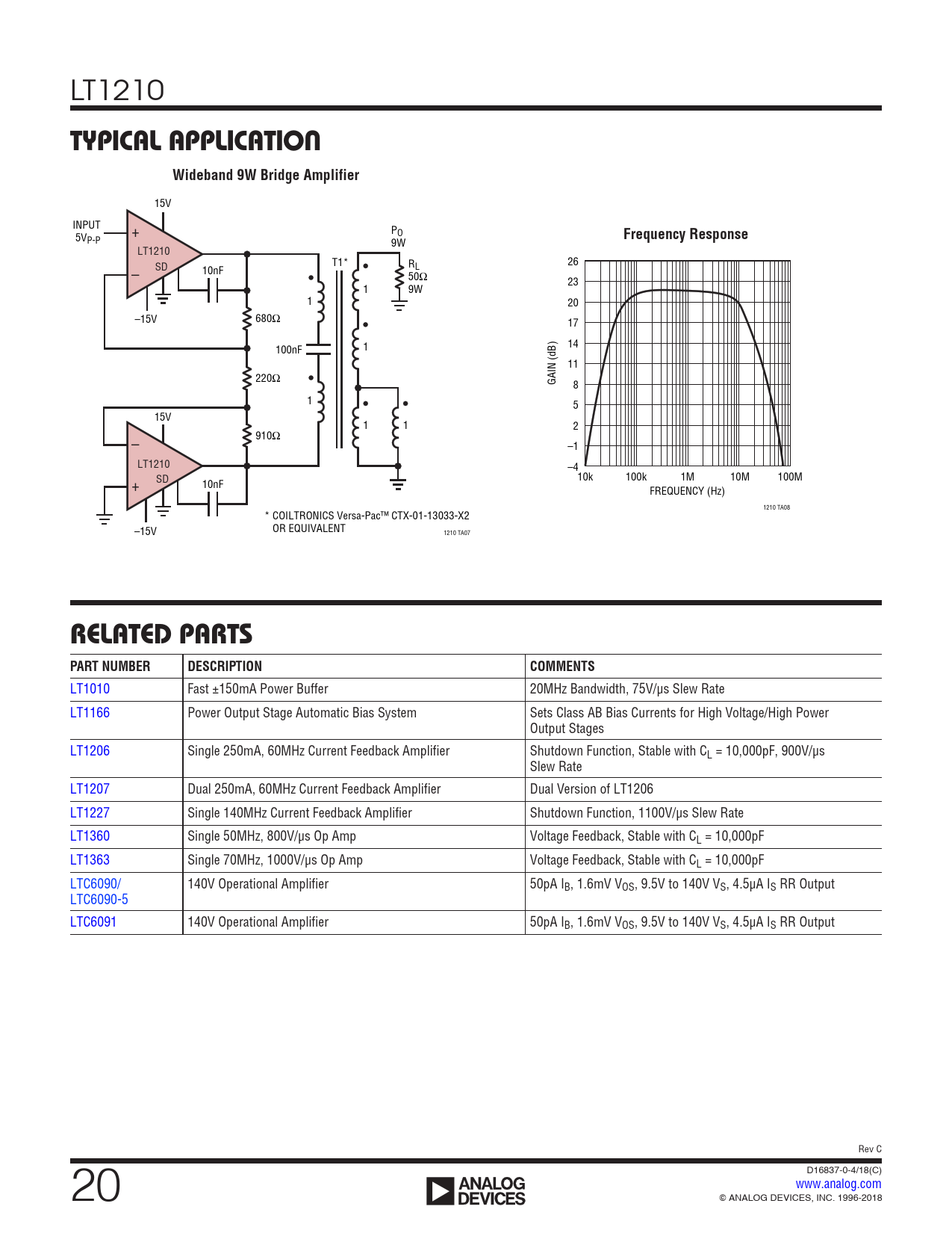

TYPICAL APPLICATION. Wideband 9W Bridge Amplifier. Frequency Response. RELATED PARTS PART NUMBER. DESCRIPTION. COMMENTS
TYPICAL APPLICATION Wideband 9W Bridge Amplifier Frequency Response RELATED PARTS PART NUMBER DESCRIPTION COMMENTS
LT1210
15V INPUT + PO 5V
Frequency Response
P-P 9W LT1210 T1* R 26 – SD 10nF L 50Ω 23 1 9W 1 20 –15V 680Ω 17 1 100nF 14 11 220Ω GAIN (dB) 8 1 5 15V 1 1 2 910Ω – –1 LT1210 –4 + SD 10k 100k 1M 10M 100M 10nF FREQUENCY (Hz) 1210 TA08 * COILTRONICS Versa-Pac™ CTX-01-13033-X2 OR EQUIVALENT –15V 1210 TA07
