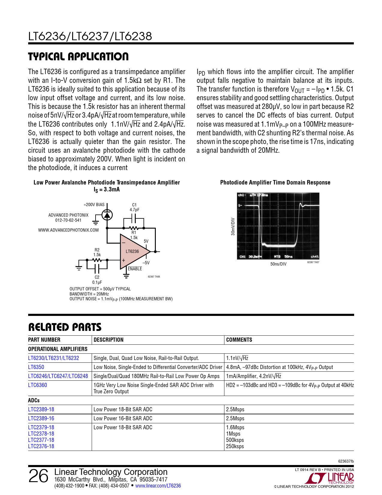

Typical applicaTion
The LT6236 is configured as a transimpedance amplifier IPD which flows into the amplifier circuit. The amplifier with an I-to-V conversion gain of 1.5kΩ set by R1. The output falls negative to maintain balance at its inputs. LT6236 is ideally suited to this application because of its The transfer function is therefore VOUT = –IPD • 1.5k. C1 low input offset voltage and current, and its low noise. ensures stability and good settling characteristics. Output This is because the 1.5k resistor has an inherent thermal offset was measured at 280µV, so low in part because R2 noise of 5nV/√Hz or 3.4pA/√Hz at room temperature, while serves to cancel the DC effects of bias current. Output the LT6236 contributes only 1.1nV/√Hz and 2.4pA/√Hz. noise was measured at 1.1mVP–P on a 100MHz measure- So, with respect to both voltage and current noises, the ment bandwidth, with C2 shunting R2’s thermal noise. As LT6236 is actually quieter than the gain resistor. The shown in the scope photo, the rise time is 17ns, indicating circuit uses an avalanche photodiode with the cathode a signal bandwidth of 20MHz. biased to approximately 200V. When light is incident on the photodiode, it induces a current
Low Power Avalanche Photodiode Transimpedance Amplifier Photodiode Amplifier Time Domain Response IS = 3.3mA
≈200V BIAS C1 4.7pF ADVANCED PHOTONIX 012-70-62-541 /DIV WWW.ADVANCEDPHOTONIX.COM R1 30mV 1.5k – 5V R2 LT6236 1.5k + –5V 50ns/DIV 62367 TA07 ENABLE C2 62367 TA06 0.1µF OUTPUT OFFSET = 500µV TYPICAL BANDWIDTH = 20MHz OUTPUT NOISE = 1.1mVP-P (100MHz MEASUREMENT BW)
