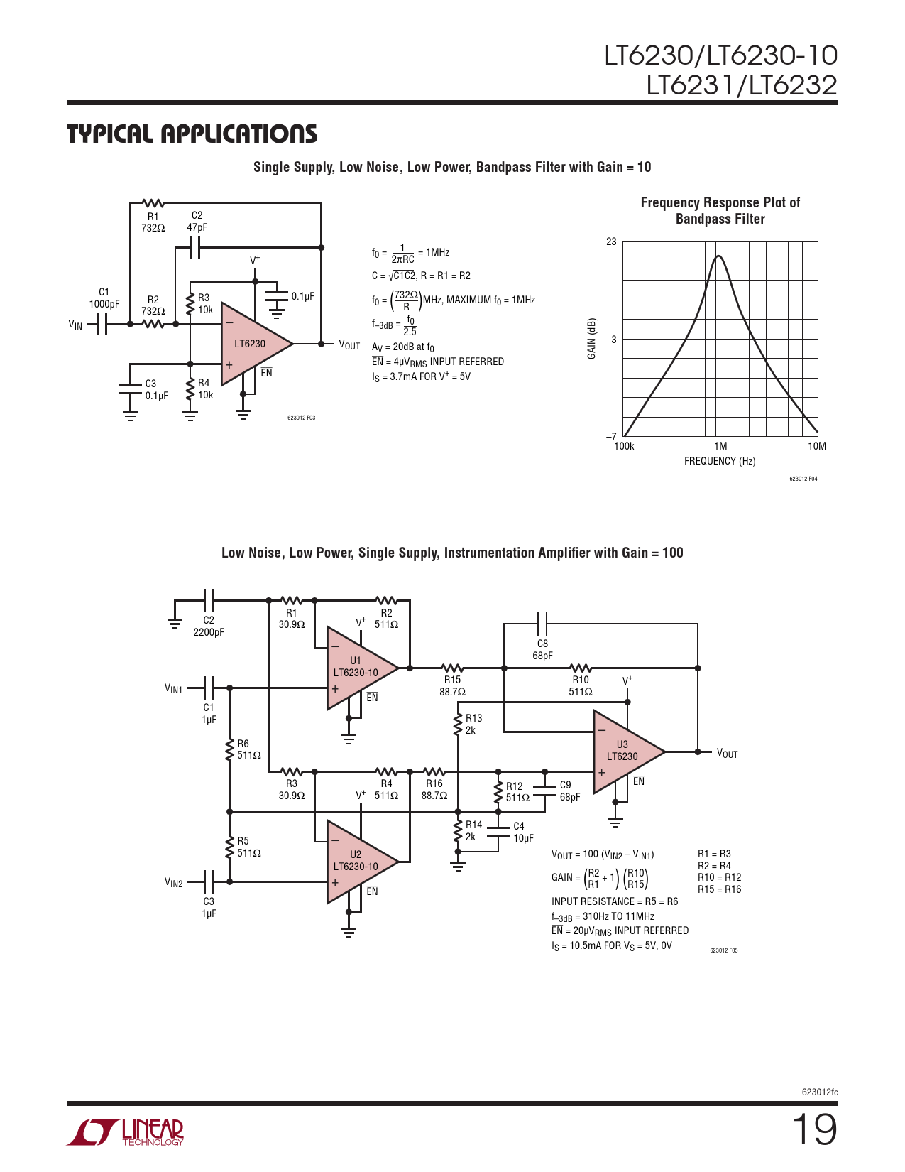

Typical applicaTions. Single Supply, Low Noise, Low Power, Bandpass Filter with Gain = 10. Frequency Response Plot of
Typical applicaTions Single Supply, Low Noise, Low Power, Bandpass Filter with Gain = 10 Frequency Response Plot of
LT6230/LT6230-10 LT6231/LT6232
R1 C2
Bandpass Filter
732Ω 47pF 23 f0 = 1 = 1MHz V+ 2πRC C = √C1C2, R = R1 = R2 C1 R2 0.1µF f 1000pF R3 0 = (732Ω R )MHz, MAXIMUM f0 = 1MHz 732Ω 10k VIN – f–3dB = f0 2.5 LT6230 V 3 OUT AV = 20dB at f0 + EN = 4µV GAIN (dB) RMS INPUT REFERRED EN I C3 R4 S = 3.7mA FOR V+ = 5V 0.1µF 10k 623012 F03 –7100k 1M 10M FREQUENCY (Hz) 623012 F04
Low Noise, Low Power, Single Supply, Instrumentation Amplifier with Gain = 100
R1 R2 C2 30.9Ω V+ 511Ω 2200pF C8 – 68pF U1 LT6230-10 R15 R10 V+ VIN1 + 88.7Ω 511Ω EN C1 1µF R13 2k – R6 U3 511Ω LT6230 VOUT + R3 R4 R16 EN R12 C9 30.9Ω V+ 511Ω 88.7Ω 511Ω 68pF R14 C4 2k R5 – 10µF 511Ω U2 VOUT = 100 (VIN2 – VIN1) R1 = R3 LT6230-10 R2 = R4 GAIN = V R10 = R12 IN2 + (R2 + 1 R1 ) (R10 R15) EN R15 = R16 C3 INPUT RESISTANCE = R5 = R6 1µF f–3dB = 310Hz TO 11MHz EN = 20µVRMS INPUT REFERRED IS = 10.5mA FOR VS = 5V, 0V 623012 F05 623012fc 19 Document Outline Features Applications Description Typical Application Absolute Maximum Ratings Pin Configuration Order Information Electrical Characteristics Typical Performance Characteristics Applications Information Typical Applications Package Description Revision History Typical Applications Related Parts
