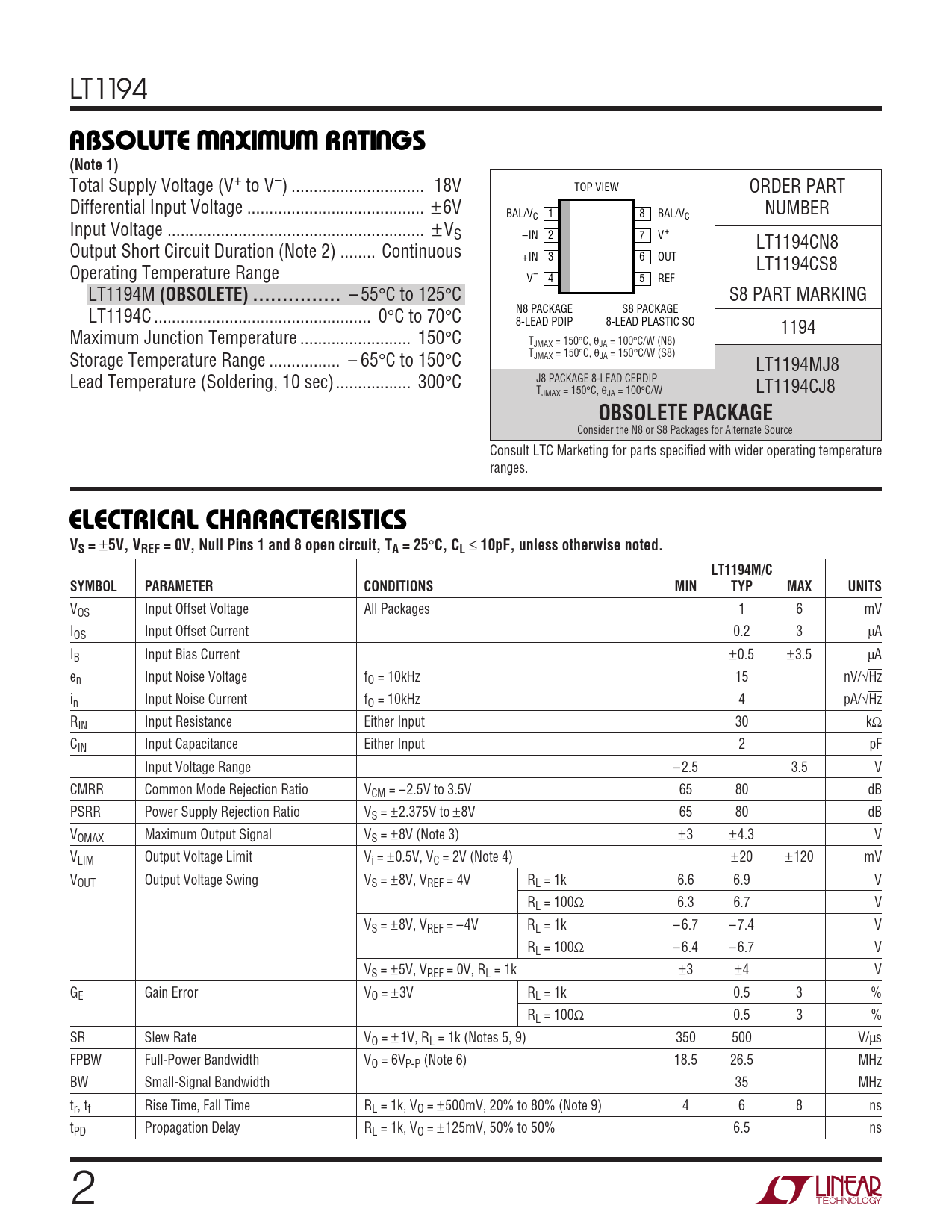

LT1194
W W W U ABSOLUTE AXI U RATI GS (Note 1)
Total Supply Voltage (V+ to V–) .. 18V TOP VIEW ORDER PART Differential Input Voltage .. ± 6V BAL/V 1 8 BAL/V NUMBER C C Input Voltage .. ± VS –IN 2 7 V+ Output Short Circuit Duration (Note 2) .. Continuous LT1194CN8 +IN 3 6 OUT Operating Temperature Range LT1194CS8 V– 4 5 REF LT1194M
(OBSOLETE) ...
– 55°C to 125°C S8 PART MARKING LT1194C ... 0°C to 70°C N8 PACKAGE S8 PACKAGE 8-LEAD PDIP 8-LEAD PLASTIC SO 1194 Maximum Junction Temperature ... 150°C TJMAX = 150°C, θJA = 100°C/W (N8) Storage Temperature Range .. – 65°C to 150°C TJMAX = 150°C, θJA = 150°C/W (S8) LT1194MJ8 Lead Temperature (Soldering, 10 sec)... 300°C J8 PACKAGE 8-LEAD CERDIP T LT1194CJ8 JMAX = 150°C, θJA = 100°C/W
OBSOLETE PACKAGE
Consider the N8 or S8 Packages for Alternate Source Consult LTC Marketing for parts specified with wider operating temperature ranges.
ELECTRICAL CHARACTERISTICS VS =
5V, VREF = 0V, Null Pins 1 and 8 open circuit, TA = 25
C, CL
10pF, unless otherwise noted. LT1194M/C SYMBOL PARAMETER CONDITIONS MIN TYP MAX UNITS
VOS Input Offset Voltage All Packages 1 6 mV IOS Input Offset Current 0.2 3 µA IB Input Bias Current ±0.5 ±3.5 µA en Input Noise Voltage fO = 10kHz 15 nV/√Hz in Input Noise Current fO = 10kHz 4 pA/√Hz RIN Input Resistance Either Input 30 kΩ CIN Input Capacitance Either Input 2 pF Input Voltage Range – 2.5 3.5 V CMRR Common Mode Rejection Ratio VCM = –2.5V to 3.5V 65 80 dB PSRR Power Supply Rejection Ratio VS = ±2.375V to ±8V 65 80 dB VOMAX Maximum Output Signal VS = ±8V (Note 3) ±3 ±4.3 V VLIM Output Voltage Limit Vi = ±0.5V, VC = 2V (Note 4) ±20 ±120 mV VOUT Output Voltage Swing VS = ±8V, VREF = 4V RL = 1k 6.6 6.9 V RL = 100Ω 6.3 6.7 V VS = ±8V, VREF = –4V RL = 1k – 6.7 – 7.4 V RL = 100Ω – 6.4 – 6.7 V VS = ±5V, VREF = 0V, RL = 1k ±3 ±4 V GE Gain Error VO = ±3V RL = 1k 0.5 3 % RL = 100Ω 0.5 3 % SR Slew Rate VO = ± 1V, RL = 1k (Notes 5, 9) 350 500 V/µs FPBW Full-Power Bandwidth VO = 6VP-P (Note 6) 18.5 26.5 MHz BW Small-Signal Bandwidth 35 MHz tr, tf Rise Time, Fall Time RL = 1k, VO = ±500mV, 20% to 80% (Note 9) 4 6 8 ns tPD Propagation Delay RL = 1k, VO = ±125mV, 50% to 50% 6.5 ns 2
