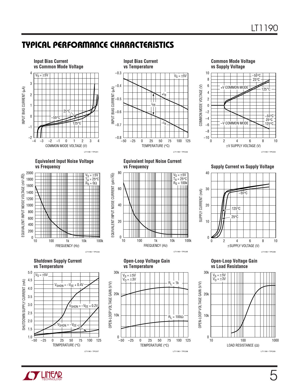

TYPICAL PERFOR A CE CHARACTERISTICS. Input Bias Current. Common Mode Voltage. vs Common Mode Voltage. vs Temperature
TYPICAL PERFOR A CE CHARACTERISTICS Input Bias Current Common Mode Voltage vs Common Mode Voltage vs Temperature
LT1190
W U TYPICAL PERFOR A CE CHARACTERISTICS Input Bias Current Input Bias Current Common Mode Voltage vs Common Mode Voltage vs Temperature vs Supply Voltage
4 –0.3 10 VS = ±5V VS = ±5V –55°C 8 25°C 3 –0.4 6 +V COMMON MODE µA) µA) 125 C ° 4 2 +IB TAGE (V) –0.5 2 1 IOS 0 25°C –0.6 –2 0 –55°C –55°C –4 25°C INPUT BIAS CURRENT ( 125°C INPUT BIAS CURRENT ( –I –0.7 B COMMON MODE VOL –6 –V COMMON MODE 125°C –1 –8 –2 –0.8 –10 –4 –3 –2 –1 0 1 2 3 4 –50 –25 0 25 50 75 100 125 0 2 4 6 8 10 COMMON MODE VOLTAGE (V) TEMPERATURE (°C) ±V SUPPLY VOLTAGE (V) LT1190 • TPC01 LT1190 • TPC02 LT1190 • TPC03
Equivalent Input Noise Voltage Equivalent Input Noise Current vs Frequency vs Frequency Supply Current vs Supply Voltage
2000 80 40 V VS = ±5V √ S = ±5V 1800 T √ A = 25°C TA = 25°C RS = 0Ω RS = 100k 1600 60 30 TAGE (nV/ Hz) 1400 –55°C 1200 1000 40 20 125°C 800 Y CURRENT (mA) 600 25°C 20 SUPPL 10 400 ALENT INPUT NOISE VOL ALENT INPUT NOISE CURRENT (pA/ Hz) 200 EQUIV 0 EQUIV 0 0 10 100 1k 10k 100k 10 100 1k 10k 100k 0 2 4 6 8 10 FREQUENCY (Hz) FREQUENCY (Hz) ±SUPPLY VOLTAGE (V) LT1190 • TPC04 LT1190 • TPC05 LT1190 • TPC06
Shutdown Supply Current Open-Loop Voltage Gain Open-Loop Voltage Gain vs Temperature vs Temperature vs Load Resistance
5.0 30k 30k VS = ±5V V V S = ± 5V S = ± 5V 4.5 V V O = ± 3V O = ±3V R V L = 1k SHDN = –VEE + 0.4V 4.0 20k 20k 3.5 Y CURRENT (mA) 3.0 VSHDN = –VEE + 0.2V 2.5 10k R 10k L = 100Ω 2.0 VSHDN = –VEE OPEN-LOOP VOLTAGE GAIN (V/V) OPEN-LOOP VOLTAGE GAIN (V/V) SHUTDOWN SUPPL 1.5 1.0 0 0 –50 –25 0 25 50 75 100 125 –50 –25 0 25 50 75 100 125 10 100 1000 TEMPERATURE (°C) TEMPERATURE (°C) LOAD RESISTANCE (Ω) LT1190 • TPC07 LT1190 • TPC08 LT1190 • TPC09 5
