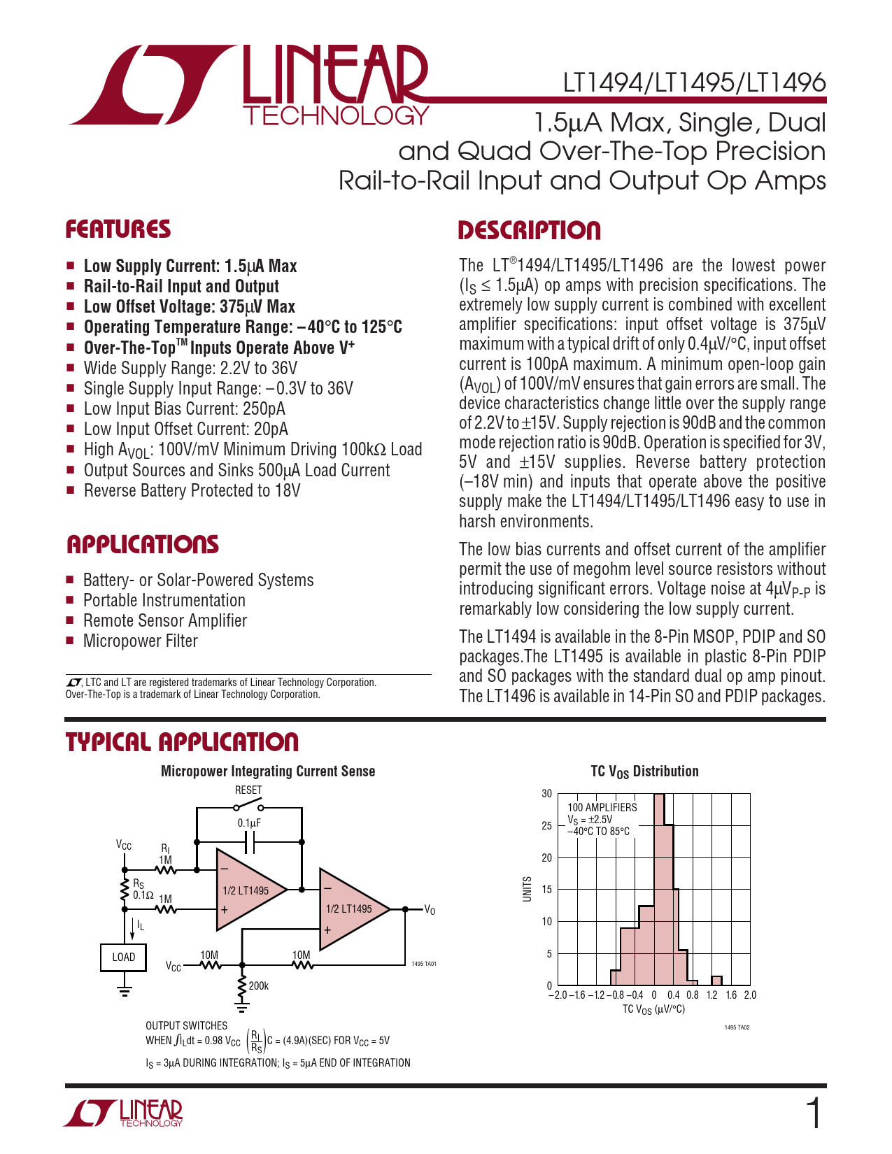

LT1494/LT1495/LT1496 1.5µA Max, Single, Dual and Quad Over-The-Top Precision Rail-to-Rail Input and Output Op Amps
U FEATURES DESCRIPTIO
Low Supply Current: 1.5
µ
A Max
The LT®1494/LT1495/LT1496 are the lowest power ■
(IS ≤ 1.5µA) op amps with precision specifications. The ■
Low Offset Voltage: 375
µ
V Max
extremely low supply current is combined with excellent ■
Operating Temperature Range: – 40
C to 125
C
amplifier specifications: input offset voltage is 375µV ■
Over-The-TopTM Inputs Operate Above V+
maximum with a typical drift of only 0.4µV/°C, input offset ■ Wide Supply Range: 2.2V to 36V current is 100pA maximum. A minimum open-loop gain ■ Single Supply Input Range: – 0.3V to 36V (AVOL) of 100V/mV ensures that gain errors are small. The ■ Low Input Bias Current: 250pA device characteristics change little over the supply range ■ Low Input Offset Current: 20pA of 2.2V to ±15V. Supply rejection is 90dB and the common mode rejection ratio is 90dB. Operation is specified for 3V, ■ High AVOL: 100V/mV Minimum Driving 100kΩ Load 5V and ±15V supplies. Reverse battery protection ■ Output Sources and Sinks 500µA Load Current (–18V␣ min) and inputs that operate above the positive ■ Reverse Battery Protected to 18V supply make the LT1494/LT1495/LT1496 easy to use in
U
harsh environments.
APPLICATIO S
The low bias currents and offset current of the amplifier permit the use of megohm level source resistors without ■ Battery- or Solar-Powered Systems introducing significant errors. Voltage noise at 4µVP-P is ■ Portable Instrumentation remarkably low considering the low supply current. ■ Remote Sensor Amplifier ■ The LT1494 is available in the 8-Pin MSOP, PDIP and SO Micropower Filter packages.The LT1495 is available in plastic 8-Pin PDIP and SO packages with the standard dual op amp pinout. , LTC and LT are registered trademarks of Linear Technology Corporation. Over-The-Top is a trademark of Linear Technology Corporation. The LT1496 is available in 14-Pin SO and PDIP packages.
U TYPICAL APPLICATION Micropower Integrating Current Sense TC VOS Distribution
