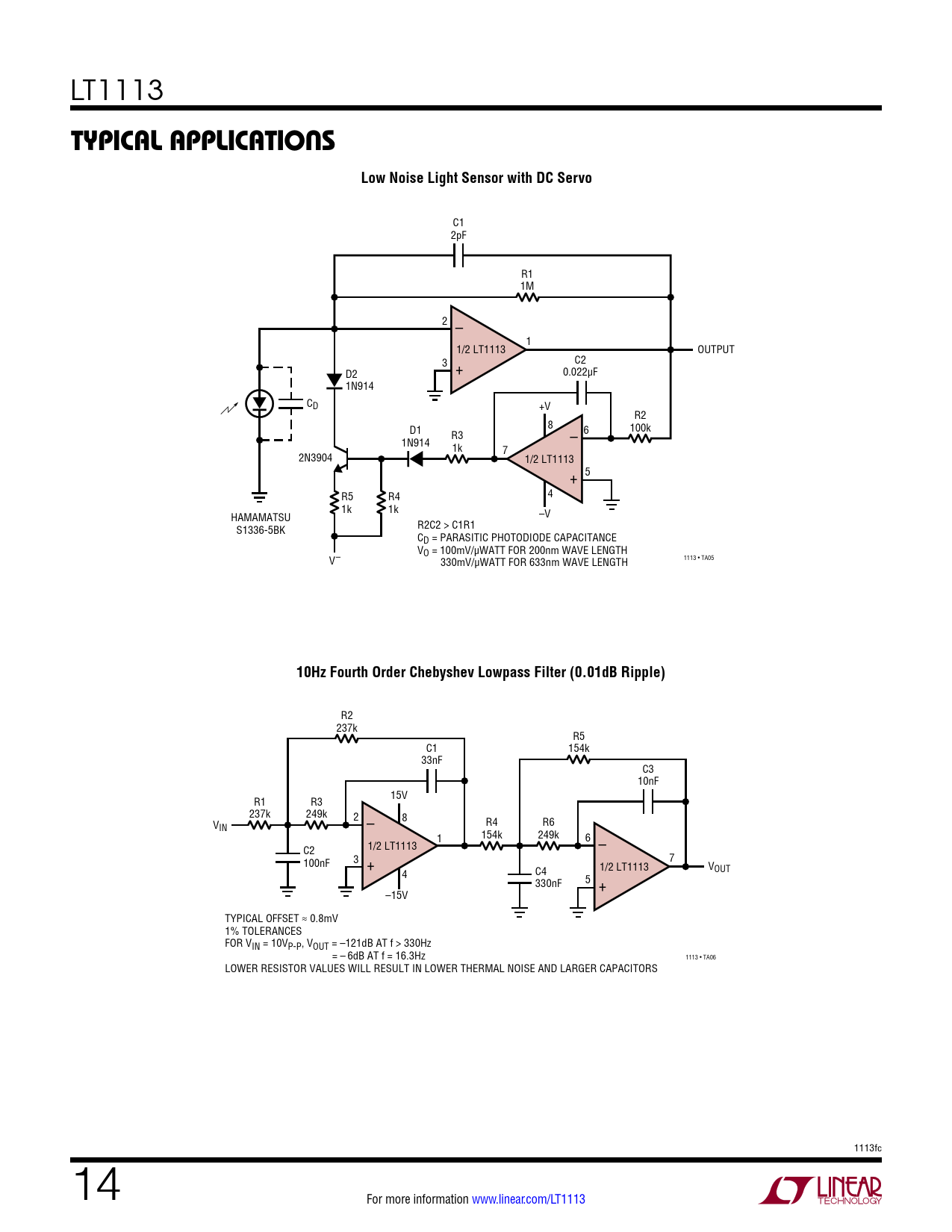

Typical applicaTions. Low Noise Light Sensor with DC Servo. 10Hz Fourth Order Chebyshev Lowpass Filter (0.01dB Ripple)
Typical applicaTions Low Noise Light Sensor with DC Servo 10Hz Fourth Order Chebyshev Lowpass Filter (0.01dB Ripple)
LT1113
C1 2pF R1 1M 2 – 1 1/2 LT1113 OUTPUT 3 + C2 D2 0.022µF 1N914 CD +V R2 8 D1 – 6 100k R3 1N914 1k 7 2N3904 1/2 LT1113 + 5 4 R5 R4 1k 1k –V HAMAMATSU R2C2 > C1R1 S1336-5BK CD = PARASITIC PHOTODIODE CAPACITANCE VO = 100mV/µWATT FOR 200nm WAVE LENGTH 1113 • TA05 V– 330mV/µWATT FOR 633nm WAVE LENGTH
R2 237k R5 C1 154k 33nF C3 10nF R1 R3 15V 237k 249k 2 – 8 VIN R4 R6 154k 249k 1 6 – C2 1/2 LT1113 100nF 3 + 7 1/2 LT1113 VOUT C4 4 330nF 5 + –15V TYPICAL OFFSET ≈ 0.8mV 1% TOLERANCES FOR VIN = 10VP-P, VOUT = –121dB AT f > 330Hz = – 6dB AT f = 16.3Hz 1113 • TA06 LOWER RESISTOR VALUES WILL RESULT IN LOWER THERMAL NOISE AND LARGER CAPACITORS 1113fc 14 For more information www.linear.com/LT1113
