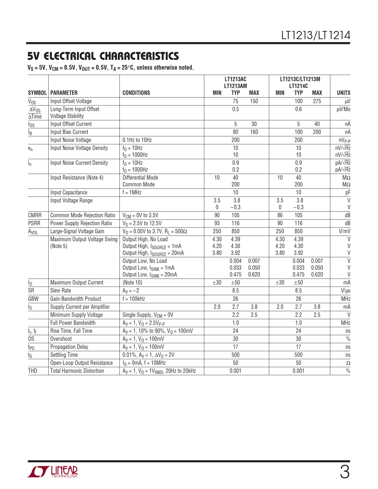

5V ELECTRICAL CH. ARA TERISTICS. VS = 5V, VCM = 0.5V, VOUT = 0.5V, TA = 25. C, unless otherwise noted. LT1213AC. LT1213C/LT1213M
5V ELECTRICAL CH ARA TERISTICS VS = 5V, VCM = 0.5V, VOUT = 0.5V, TA = 25 C, unless otherwise noted LT1213AC LT1213C/LT1213M
LT1213/LT1214
5V ELECTRICAL CH C ARA TERISTICS VS = 5V, VCM = 0.5V, VOUT = 0.5V, TA = 25
C, unless otherwise noted. LT1213AC LT1213C/LT1213M LT1213AM LT1214C SYMBOL PARAMETER CONDITIONS MIN TYP MAX MIN TYP MAX UNITS
VOS Input Offset Voltage 75 150 100 275 µV ∆VOS Long-Term Input Offset 0.5 0.6 µV/Mo ∆Time Voltage Stability IOS Input Offset Current 5 30 5 40 nA IB Input Bias Current 80 160 100 200 nA Input Noise Voltage 0.1Hz to 10Hz 200 200 nVP-P en Input Noise Voltage Density fO = 10Hz 10 10 nV/√Hz fO = 1000Hz 10 10 nV/√Hz in Input Noise Current Density fO = 10Hz 0.9 0.9 pA/√Hz fO = 1000Hz 0.2 0.2 pA/√Hz Input Resistance (Note 4) Differential Mode 10 40 10 40 MΩ Common Mode 200 200 MΩ Input Capacitance f = 1MHz 10 10 pF Input Voltage Range 3.5 3.8 3.5 3.8 V 0 – 0.3 0 – 0.3 V CMRR Common Mode Rejection Ratio VCM = 0V to 3.5V 90 105 86 105 dB PSRR Power Supply Rejection Ratio VS = 2.5V to 12.5V 93 116 90 116 dB AVOL Large-Signal Voltage Gain VO = 0.05V to 3.7V, RL = 500Ω 250 850 250 850 V/mV Maximum Output Voltage Swing Output High, No Load 4.30 4.39 4.30 4.39 V (Note 5) Output High, ISOURCE = 1mA 4.20 4.30 4.20 4.30 V Output High, ISOURCE = 20mA 3.80 3.92 3.80 3.92 V Output Low, No Load 0.004 0.007 0.004 0.007 V Output Low, ISINK = 1mA 0.033 0.050 0.033 0.050 V Output Low, ISINK = 20mA 0.475 0.620 0.475 0.620 V IO Maximum Output Current (Note 10) ±30 ±50 ±30 ±50 mA SR Slew Rate AV = – 2 8.5 8.5 V/µs GBW Gain-Bandwidth Product f = 100kHz 26 26 MHz IS Supply Current per Amplifier 2.0 2.7 3.8 2.0 2.7 3.8 mA Minimum Supply Voltage Single Supply, VCM = 0V 2.2 2.5 2.2 2.5 V Full Power Bandwidth AV = 1, VO = 2.5VP-P 1.0 1.0 MHz tr, tf Rise Time, Fall Time AV = 1, 10% to 90%, VO = 100mV 24 24 ns OS Overshoot AV = 1, VO = 100mV 30 30 % tPD Propagation Delay AV = 1, VO = 100mV 17 17 ns tS Settling Time 0.01%, AV = 1, ∆VO = 2V 500 500 ns Open-Loop Output Resistance IO = 0mA, f = 10MHz 50 50 Ω THD Total Harmonic Distortion AV = 1, VO = 1VRMS, 20Hz to 20kHz 0.001 0.001 % 3
