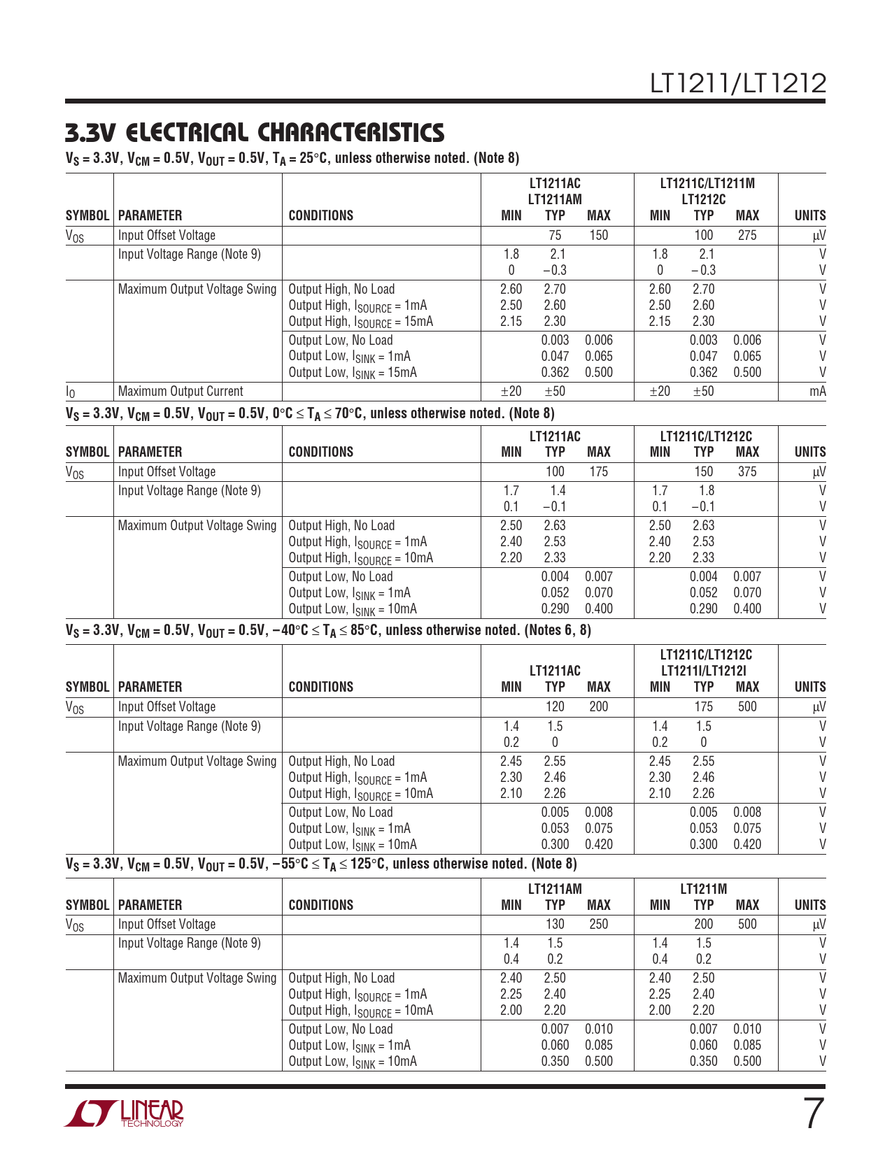

| Description | 14MHz, 7V/µs, Single Supply Dual and Quad Precision Op Amps |
| Pages / Page | 20 / 7 — 3.3V ELECTRICAL CH. ARA TERISTICS. VS = 3.3V, VCM = 0.5V, VOUT = 0.5V, TA … |
| File Format / Size | PDF / 394 Kb |
3.3V ELECTRICAL CH. ARA TERISTICS. VS = 3.3V, VCM = 0.5V, VOUT = 0.5V, TA = 25. C, unless otherwise noted. (Note 8). LT1211AC
LT1211/LT1212
3.3V ELECTRICAL CH C ARA TERISTICS VS = 3.3V, VCM = 0.5V, VOUT = 0.5V, TA = 25
C, unless otherwise noted. (Note 8) LT1211AC LT1211C/LT1211M LT1211AM LT1212C SYMBOL PARAMETER CONDITIONS MIN TYP MAX MIN TYP MAX UNITS
VOS Input Offset Voltage 75 150 100 275 µV Input Voltage Range (Note 9) 1.8 2.1 1.8 2.1 V 0 – 0.3 0 – 0.3 V Maximum Output Voltage Swing Output High, No Load 2.60 2.70 2.60 2.70 V Output High, ISOURCE = 1mA 2.50 2.60 2.50 2.60 V Output High, ISOURCE = 15mA 2.15 2.30 2.15 2.30 V Output Low, No Load 0.003 0.006 0.003 0.006 V Output Low, ISINK = 1mA 0.047 0.065 0.047 0.065 V Output Low, ISINK = 15mA 0.362 0.500 0.362 0.500 V IO Maximum Output Current ±20 ±50 ±20 ±50 mA
VS = 3.3V, VCM = 0.5V, VOUT = 0.5V, 0
C
TA
70
C, unless otherwise noted. (Note 8) LT1211AC LT1211C/LT1212C SYMBOL PARAMETER CONDITIONS MIN TYP MAX MIN TYP MAX UNITS
VOS Input Offset Voltage 100 175 150 375 µV Input Voltage Range (Note 9) 1.7 1.4 1.7 1.8 V 0.1 – 0.1 0.1 – 0.1 V Maximum Output Voltage Swing Output High, No Load 2.50 2.63 2.50 2.63 V Output High, ISOURCE = 1mA 2.40 2.53 2.40 2.53 V Output High, ISOURCE = 10mA 2.20 2.33 2.20 2.33 V Output Low, No Load 0.004 0.007 0.004 0.007 V Output Low, ISINK = 1mA 0.052 0.070 0.052 0.070 V Output Low, ISINK = 10mA 0.290 0.400 0.290 0.400 V
VS = 3.3V, VCM = 0.5V, VOUT = 0.5V, – 40
C
TA
85
C, unless otherwise noted. (Notes 6, 8) LT1211C/LT1212C LT1211AC LT1211I/LT1212I SYMBOL PARAMETER CONDITIONS MIN TYP MAX MIN TYP MAX UNITS
VOS Input Offset Voltage 120 200 175 500 µV Input Voltage Range (Note 9) 1.4 1.5 1.4 1.5 V 0.2 0 0.2 0 V Maximum Output Voltage Swing Output High, No Load 2.45 2.55 2.45 2.55 V Output High, ISOURCE = 1mA 2.30 2.46 2.30 2.46 V Output High, ISOURCE = 10mA 2.10 2.26 2.10 2.26 V Output Low, No Load 0.005 0.008 0.005 0.008 V Output Low, ISINK = 1mA 0.053 0.075 0.053 0.075 V Output Low, ISINK = 10mA 0.300 0.420 0.300 0.420 V
VS = 3.3V, VCM = 0.5V, VOUT = 0.5V, – 55
C
TA
125
C, unless otherwise noted. (Note 8) LT1211AM LT1211M SYMBOL PARAMETER CONDITIONS MIN TYP MAX MIN TYP MAX UNITS
VOS Input Offset Voltage 130 250 200 500 µV Input Voltage Range (Note 9) 1.4 1.5 1.4 1.5 V 0.4 0.2 0.4 0.2 V Maximum Output Voltage Swing Output High, No Load 2.40 2.50 2.40 2.50 V Output High, ISOURCE = 1mA 2.25 2.40 2.25 2.40 V Output High, ISOURCE = 10mA 2.00 2.20 2.00 2.20 V Output Low, No Load 0.007 0.010 0.007 0.010 V Output Low, ISINK = 1mA 0.060 0.085 0.060 0.085 V Output Low, ISINK = 10mA 0.350 0.500 0.350 0.500 V 7
