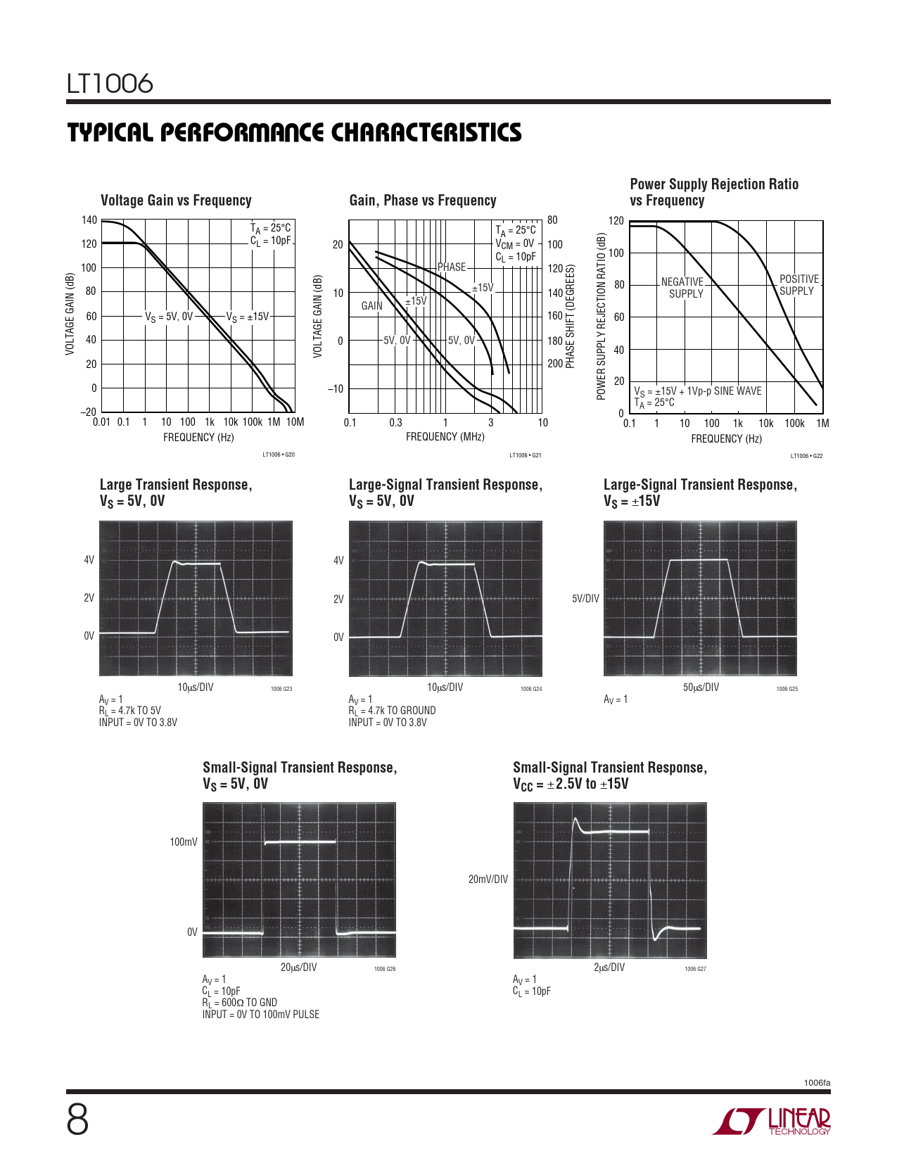

TYPICAL PERFOR A CE CHARACTERISTICS. Power Supply Rejection Ratio. Voltage Gain vs Frequency. Gain, Phase vs Frequency
LT1006
W U TYPICAL PERFOR A CE CHARACTERISTICS Power Supply Rejection Ratio Voltage Gain vs Frequency Gain, Phase vs Frequency vs Frequency
140 80 120 TA = 25°C TA = 25°C 120 CL = 10pF 20 VCM = 0V 100 C 100 L = 10pF 100 PHASE 120 POSITIVE 80 NEGATIVE 80 ±15V 10 140 SUPPLY SUPPLY ±15V GAIN 60 VS = 5V, 0V VS = ±15V 160 60 40 0 5V, 0V 5V, 0V 180 VOLTAGE GAIN (dB) VOLTAGE GAIN (dB) 40 20 200 PHASE SHIFT (DEGREES) 20 0 –10 V POWER SUPPLY REJECTION RATIO (dB) S = ±15V + 1Vp-p SINE WAVE TA = 25°C –20 0 0.01 0.1 1 10 100 1k 10k 100k 1M 10M 0.1 0.3 1 3 10 0.1 1 10 100 1k 10k 100k 1M FREQUENCY (Hz) FREQUENCY (MHz) FREQUENCY (Hz) LT1006 • G20 LT1006 • G21 LT1006 • G22
Large Transient Response, Large-Signal Transient Response, Large-Signal Transient Response, VS = 5V, 0V V V S = 5V, 0V S =
15V
4V 4V 2V 2V 5V/DIV 0V 0V 10µs/DIV 1006 G23 10µs/DIV 1006 G24 50µs/DIV 1006 G25 AV = 1 AV = 1 AV = 1 RL = 4.7k TO 5V RL = 4.7k TO GROUND INPUT = 0V TO 3.8V INPUT = 0V TO 3.8V
Small-Signal Transient Response, Small-Signal Transient Response, V V S = 5V, 0V CC =
2.5V to
15V
100mV 20mV/DIV 0V 20µs/DIV 1006 G26 2µs/DIV 1006 G27 AV = 1 AV = 1 CL = 10pF CL = 10pF RL = 600Ω TO GND INPUT = 0V TO 100mV PULSE 1006fa 8
