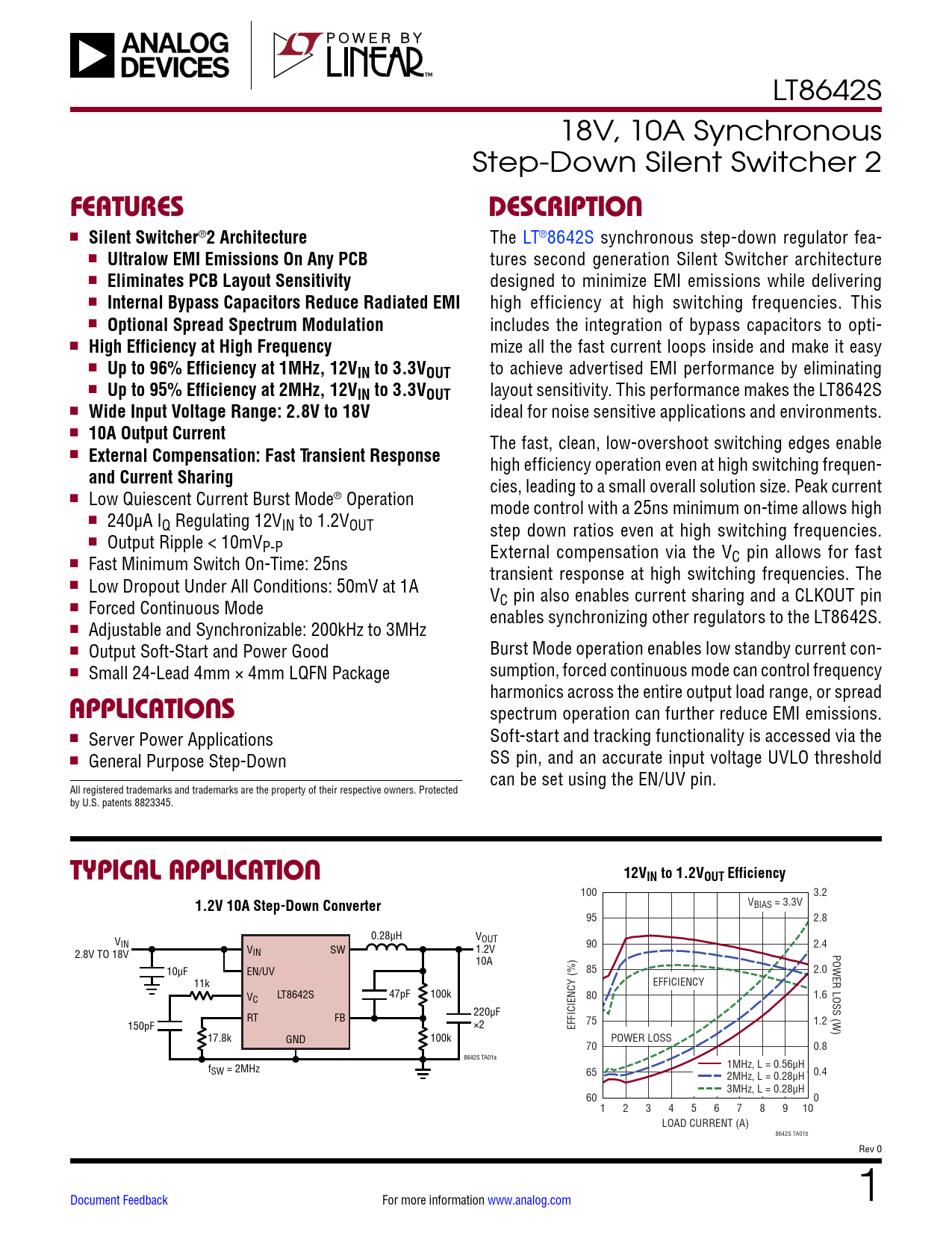

The LT®8642S synchronous step-down regulator fea- n
Ultralow EMI Emissions On Any PCB
tures second generation Silent Switcher architecture n
Eliminates PCB Layout Sensitivity
designed to minimize EMI emissions while delivering n
Internal Bypass Capacitors Reduce Radiated EMI
high efficiency at high switching frequencies. This n
Optional Spread Spectrum Modulation
includes the integration of bypass capacitors to opti- n
High Efficiency at High Frequency
mize all the fast current loops inside and make it easy n
Up to 96% Efficiency at 1MHz, 12VIN to 3.3VOUT
to achieve advertised EMI performance by eliminating n
Up to 95% Efficiency at 2MHz, 12VIN to 3.3VOUT
layout sensitivity. This performance makes the LT8642S n
Wide Input Voltage Range: 2.8V to 18V
ideal for noise sensitive applications and environments. n
10A Output Current
The fast, clean, low-overshoot switching edges enable n
External Compensation: Fast Transient Response
high efficiency operation even at high switching frequen-
and Current Sharing
cies, leading to a small overall solution size. Peak current n Low Quiescent Current Burst Mode® Operation mode control with a 25ns minimum on-time al ows high n 240µA IQ Regulating 12VIN to 1.2VOUT step down ratios even at high switching frequencies. n Output Ripple < 10mVP-P External compensation via the VC pin al ows for fast n Fast Minimum Switch On-Time: 25ns transient response at high switching frequencies. The n Low Dropout Under All Conditions: 50mV at 1A VC pin also enables current sharing and a CLKOUT pin n Forced Continuous Mode enables synchronizing other regulators to the LT8642S. n Adjustable and Synchronizable: 200kHz to 3MHz n Output Soft-Start and Power Good Burst Mode operation enables low standby current con- n Small 24-Lead 4mm × 4mm LQFN Package sumption, forced continuous mode can control frequency harmonics across the entire output load range, or spread

TYPICAL APPLICATION 12VIN to 1.2VOUT Efficiency
