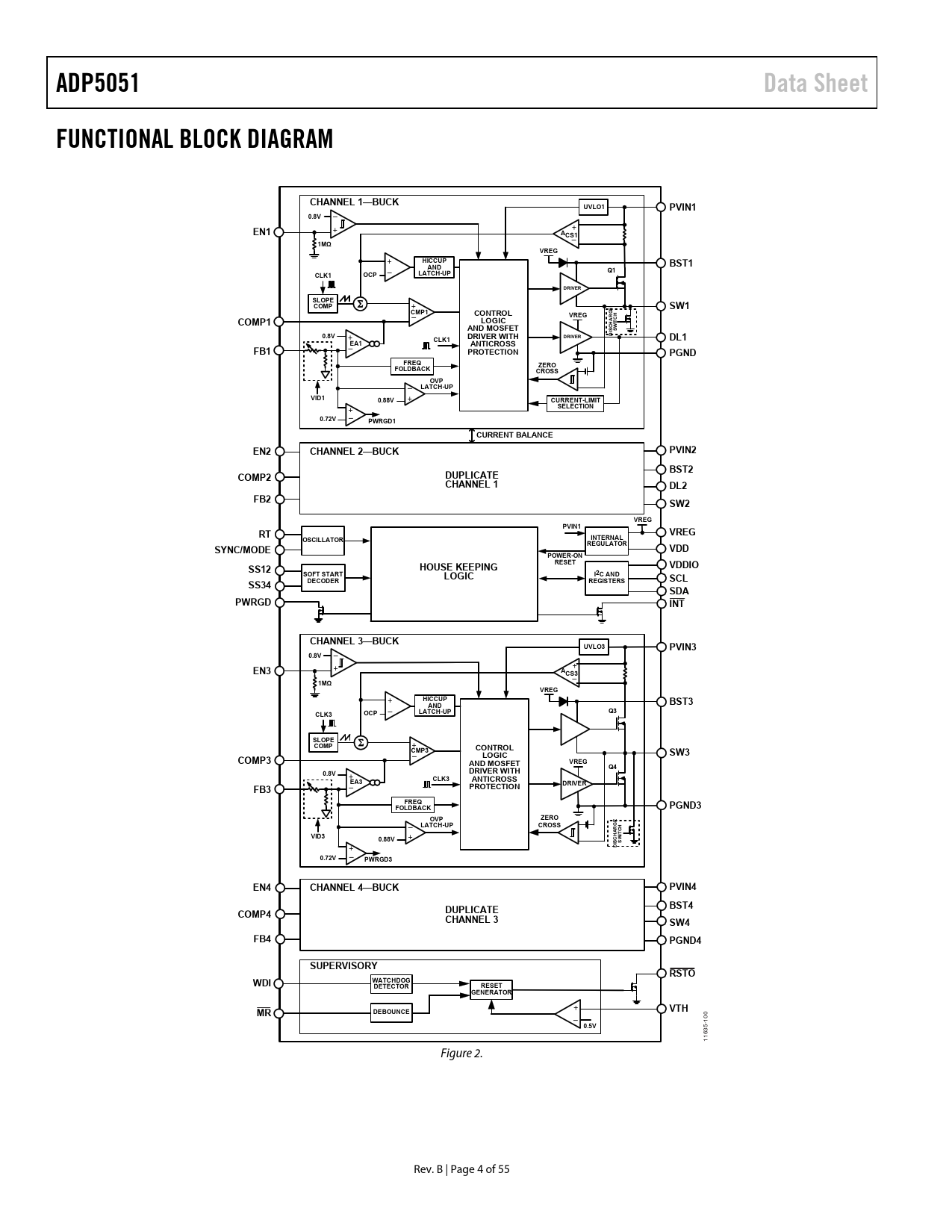

ADP5051. Data Sheet. FUNCTIONAL BLOCK DIAGRAM. CHANNEL 1—BUCK. UVLO1. PVIN1. 0.8V. EN1. CS1. 1MΩ. VREG. HICCUP. BST1. AND. CLK1. OCP. LATCH-UP. DRIVER
ADP5051 Data Sheet FUNCTIONAL BLOCK DIAGRAM CHANNEL 1—BUCK UVLO1 PVIN1 0.8V EN1 CS1 1MΩ VREG HICCUP BST1 AND CLK1 OCP LATCH-UP DRIVER
EN1
A
CS1 1MΩ VREG
HICCUP BST1 AND Q1 CLK1 OCP
LATCH-UP DRIVER SLOPE COMP
E SW1 CMP1 CONTROL VREG G H COMP1
LOGIC C HAR IT AND MOSFET C S SW DI 0.8V
DRIVER WITH DRIVER DL1 EA1 CLK1 ANTICROSS
FB1 PROTECTION PGND FREQ ZERO FOLDBACK CROSS OVP
LATCH-UP VID1
0.88V CURRENT-LIMIT
SELECTION 0.72V
PWRGD1 CURRENT BALANCE EN2 CHANNEL 2—BUCK PVIN2 BST2 DUPLICATE COMP2 CHANNEL 1 DL2 FB2 SW2 VREG PVIN1 RT VREG OSCILLATOR INTERNAL REGULATOR SYNC/MODE VDD POWER-ON RESET SS12 HOUSE KEEPING VDDIO SOFT START LOGIC I2C AND DECODER REGISTERS SCL SS34 SDA PWRGD INT CHANNEL 3—BUCK UVLO3 PVIN3 0.8V
EN3
A
CS3 1MΩ VREG
HICCUP BST3 AND OCP
LATCH-UP Q3 CLK3 DRIVER SLOPE COMP
CONTROL CMP3 SW3 COMP3
LOGIC AND MOSFET VREG Q4 0.8V DRIVER WITH
CLK3 ANTICROSS EA3 DRIVER
FB3 PROTECTION FREQ FOLDBACK PGND3 OVP ZERO E LATCH-UP CROSS
RG CHIT VID3
CHA 0.88V IS SW
D 0.72V
PWRGD3 EN4 CHANNEL 4—BUCK PVIN4 DUPLICATE BST4 COMP4 CHANNEL 3 SW4 FB4 PGND4 SUPERVISORY RSTO WDI WATCHDOG DETECTOR RESET GENERATOR
MR DEBOUNCE VTH
– -100
0.5V
