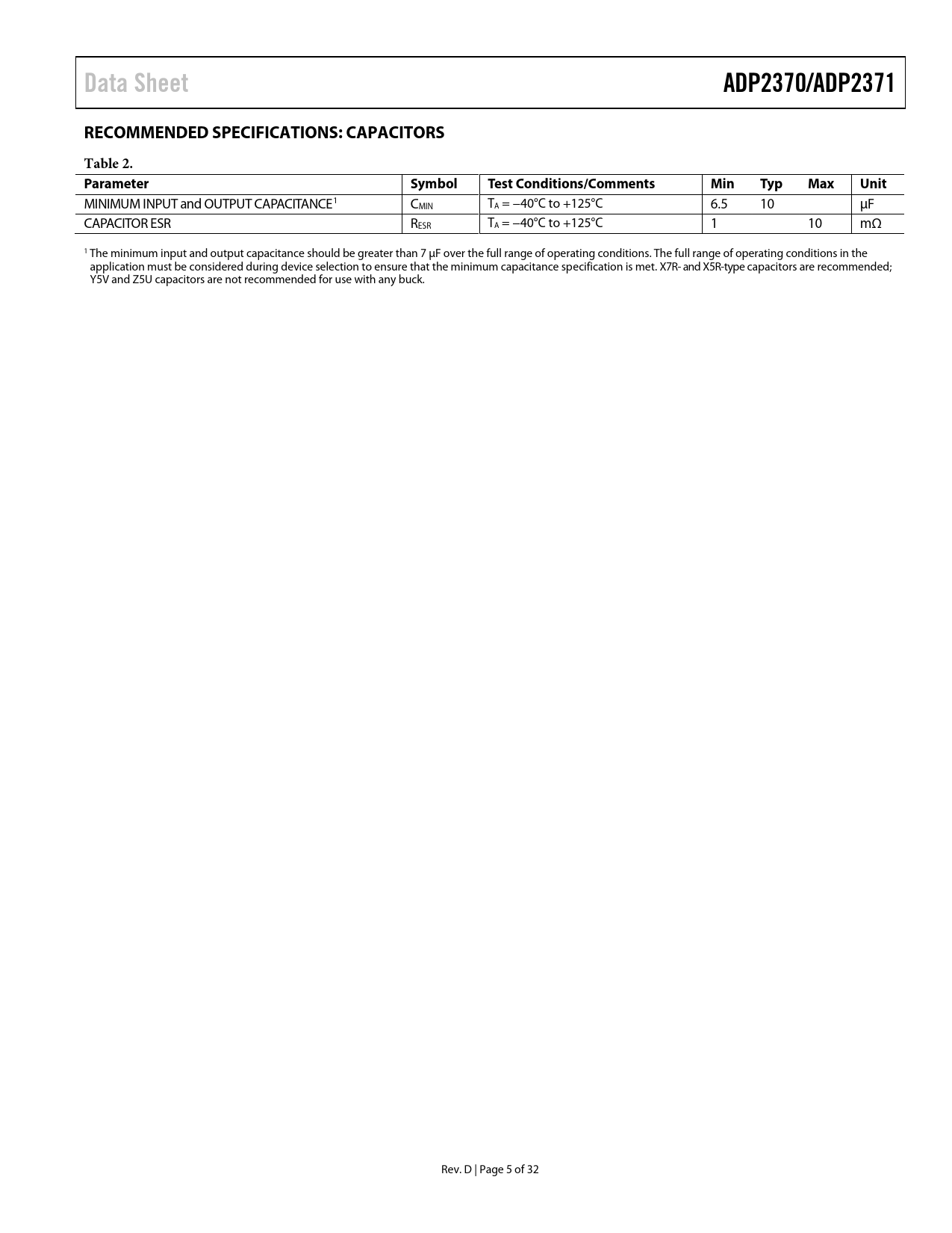

Data Sheet. ADP2370/ADP2371. RECOMMENDED SPECIFICATIONS: CAPACITORS. Table 2. Parameter. Symbol. Test Conditions/Comments. Min. Typ
Data Sheet ADP2370/ADP2371 RECOMMENDED SPECIFICATIONS: CAPACITORS Table 2 Parameter Symbol Test Conditions/Comments Min Typ
link to page 5
Data Sheet ADP2370/ADP2371 RECOMMENDED SPECIFICATIONS: CAPACITORS Table 2. Parameter Symbol Test Conditions/Comments Min Typ Max Unit
MINIMUM INPUT and OUTPUT CAPACITANCE1 CMIN TA = −40°C to +125°C 6.5 10 µF CAPACITOR ESR RESR TA = −40°C to +125°C 1 10 mΩ 1 The minimum input and output capacitance should be greater than 7 μF over the full range of operating conditions. The full range of operating conditions in the application must be considered during device selection to ensure that the minimum capacitance specification is met. X7R- and X5R-type capacitors are recommended; Y5V and Z5U capacitors are not recommended for use with any buck. Rev. D | Page 5 of 32 Document Outline Features Applications Typical Application Circuit General Description Table of Contents Revision History Specifications Recommended Specifications: Capacitors Absolute Maximum Ratings Thermal Data Thermal Resistance ESD Caution Pin Configuration and Function Descriptions Typical Performance Characteristics Buck Output Theory of Operation PWM Operation PSM Operation Features Descriptions Precision Enable Forced PWM or PWM/PSM Selection Quick Output Discharge (QOD) Function Short-Circuit Protection Undervoltage Lockout Thermal Protection Soft Start Current Limit 100% Duty Cycle Synchronizing Power Good Applications Information ADIsimPower Design Tool External Component Selection Selecting the Inductor Output Capacitor Input Capacitor Adjustable Output Voltage Programming Efficiency Power Switch Conduction Losses Inductor Losses Switching Losses Transition Losses Recommended Buck External Components Capacitor Selection Output Capacitor Input Bypass Capacitor Input and Output Capacitor Properties Thermal Considerations PCB Layout Considerations Packaging and Ordering Information Outline Dimensions Ordering Guide
