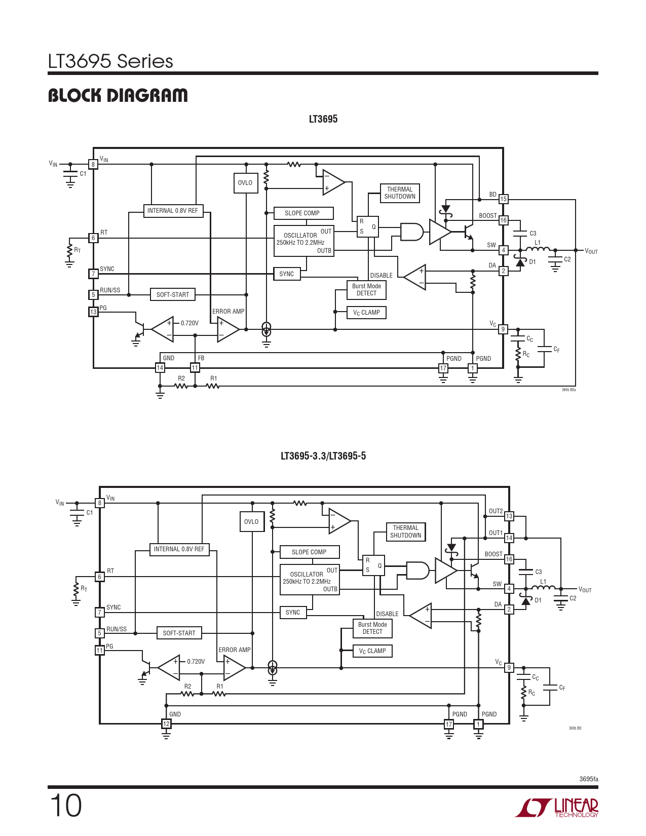

BLOCK DIAGRAM. LT3695. LT3695-3.3/LT3695-5
BLOCK DIAGRAM LT3695 LT3695-3.3/LT3695-5
LT3695 Series
VIN VIN 8 – C1 OVLO + THERMAL SHUTDOWN BD 15 INTERNAL 0.8V REF SLOPE COMP BOOST R 16 Q RT OUT S OSCILLATOR C3 6 250kHz TO 2.2MHz SW L1 RT OUTB 4 VOUT D1 C2 DA SYNC + 7 SYNC 2 DISABLE – Burst Mode RUN/SS 5 SOFT-START DETECT PG 13 ERROR AMP VC CLAMP + 0.720V + VC 9 – – CC CF R GND FB C PGND PGND 14 11 17 1 R2 R1 3695 BDa
LT3695-3.3/LT3695-5
VIN VIN 8 – C1 OUT2 13 OVLO + THERMAL SHUTDOWN OUT1 14 INTERNAL 0.8V REF SLOPE COMP BOOST R 16 Q RT OUT S OSCILLATOR C3 6 250kHz TO 2.2MHz SW L1 RT OUTB 4 VOUT D1 C2 DA SYNC + 7 SYNC 2 DISABLE – Burst Mode RUN/SS 5 SOFT-START DETECT PG 11 ERROR AMP VC CLAMP + 0.720V + VC 9 – – CC R2 R1 CF RC GND PGND PGND 12 17 1 3695 BD 3695fa 10
