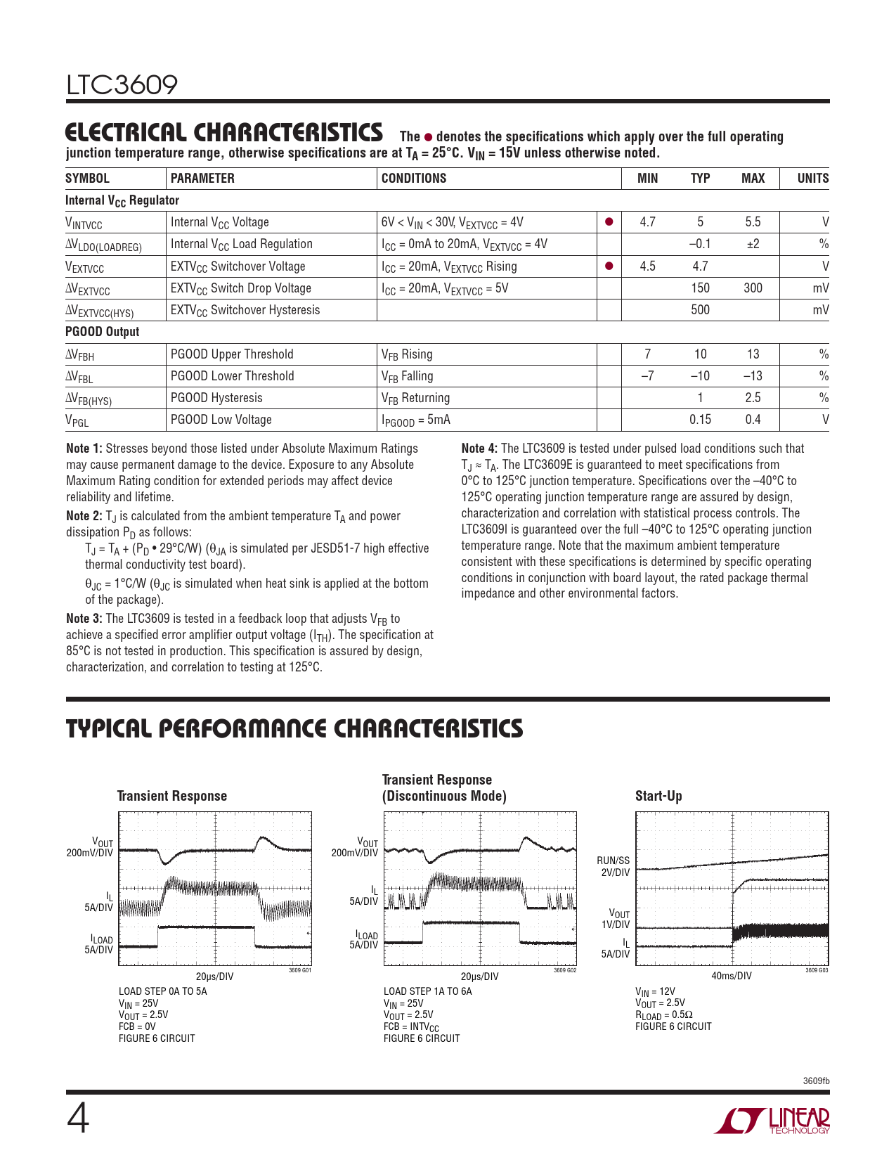

LTC3609 e
lecTrical characTerisTics
The
l
denotes the specifications which apply over the full operating junction temperature range, otherwise specifications are at TA = 25°C. VIN = 15V unless otherwise noted. SYMBOL PARAMETER CONDITIONS MIN TYP MAX UNITS Internal VCC Regulator
VINTVCC Internal VCC Voltage 6V < VIN < 30V, VEXTVCC = 4V l 4.7 5 5.5 V ∆VLDO(LOADREG) Internal VCC Load Regulation ICC = 0mA to 20mA, VEXTVCC = 4V –0.1 ±2 % VEXTVCC EXTVCC Switchover Voltage ICC = 20mA, VEXTVCC Rising l 4.5 4.7 V ∆VEXTVCC EXTVCC Switch Drop Voltage ICC = 20mA, VEXTVCC = 5V 150 300 mV ∆VEXTVCC(HYS) EXTVCC Switchover Hysteresis 500 mV
PGOOD Output
∆VFBH PGOOD Upper Threshold VFB Rising 7 10 13 % ∆VFBL PGOOD Lower Threshold VFB Falling –7 –10 –13 % ∆VFB(HYS) PGOOD Hysteresis VFB Returning 1 2.5 % VPGL PGOOD Low Voltage IPGOOD = 5mA 0.15 0.4 V

Transient Response Transient Response (Discontinuous Mode) Start-Up
