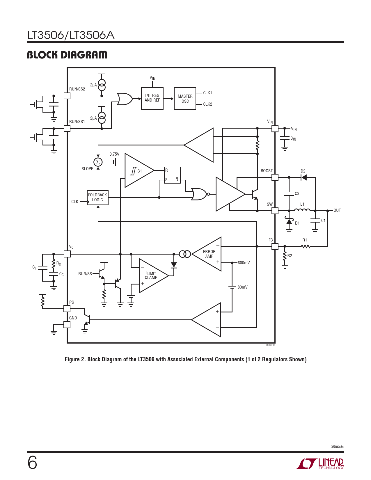

BLOCK DIAGRAM. Figure 2. Block Diagram of the LT3506 with Associated External Components (1 of 2 Regulators Shown)
LT3506/LT3506A
BLOCK DIAGRAM
VIN 2μA RUN/SS2 CLK1 INT REG MASTER AND REF OSC CLK2 2μA RUN/SS1 VIN VIN CIN 0.75V ¤ SLOPE R C1 BOOST D2 S Q FOLDBACK C3 LOGIC CLK SW L1 OUT C1 D1 – FB R1 VC ERROR AMP + R2 RC – 800mV CF I C RUN/SS LIMIT C + CLAMP 80mV PG + GND – 3506 F02
