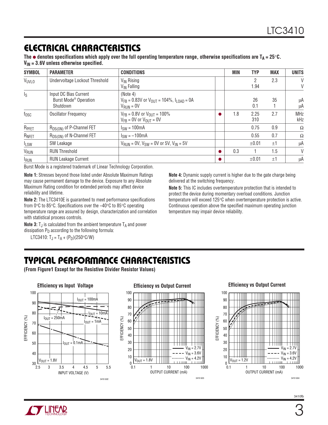

Description2.25MHz, 300mA Synchronous Step-Down Regulator in SC70
Pages / Page16 / 3 — ELECTRICAL CHARACTERISTICS The
File Format / SizePDF / 340 Kb
LTC3410
denotes specifications which apply over the full operating temperature range, otherwise specifications are TA = 25
C. VIN = 3.6V unless otherwise specified. SYMBOL PARAMETER CONDITIONS MIN TYP MAX UNITS
VUVLO Undervoltage Lockout Threshold VIN Rising 2 2.3 V VIN Falling 1.94 V IS Input DC Bias Current (Note 4) Burst Mode® Operation VFB = 0.83V or VOUT = 104%, ILOAD = 0A 26 35 µA Shutdown VRUN = 0V 0.1 1 µA fOSC Oscillator Frequency VFB = 0.8V or VOUT = 100% ● 1.8 2.25 2.7 MHz VFB = 0V or VOUT = 0V 310 kHz RPFET RDS(ON) of P-Channel FET ISW = 100mA 0.75 0.9 Ω RNFET RDS(ON) of N-Channel FET ISW = –100mA 0.55 0.7 Ω ILSW SW Leakage VRUN = 0V, VSW = 0V or 5V, VIN = 5V ±0.01 ±1 µA VRUN RUN Threshold ● 0.3 1 1.5 V IRUN RUN Leakage Current ● ±0.01 ±1 µA Burst Mode is a registered trademark of Linear Technology Corporation.

TJ is calculated from the ambient temperature TA and power dissipation PD according to the following formula: LTC3410: TJ = TA + (PD)(250°C/W)
W U TYPICAL PERFOR A CE CHARACTERISTICS (From Figure1 Except for the Resistive Divider Resistor Values) Efficiency vs Input Voltage Efficiency vs Output Current Efficiency vs Output Current
100 100 100 IOUT = 100mA 90 90 90 80 80 80 IOUT = 10mA 70 70 IOUT = 250mA 60 60 70 IOUT = 1mA 50 50 60 40 40 EFFFICIENCY (%) EFFICIENCY (%) EFFICIENCY (%) 50 IOUT = 0.1mA 30 30 20 VIN = 2.7V 20 VIN = 2.7V 40 VIN = 3.6V VIN = 3.6V 10 V 10 V V IN = 4.2V IN = 4.2V OUT = 1.8V VOUT = 1.8V VOUT = 1.2V 30 0 0 2.5 3 3.5 4 4.5 5 5.5 0.1 1 10 100 1000 0.1 1 10 100 1000 INPUT VOLTAGE (V) OUTPUT CURRENT (mA) OUTPUT CURRENT (mA) 3410 G02 3410 G03 3410 G04 3410fb 3
