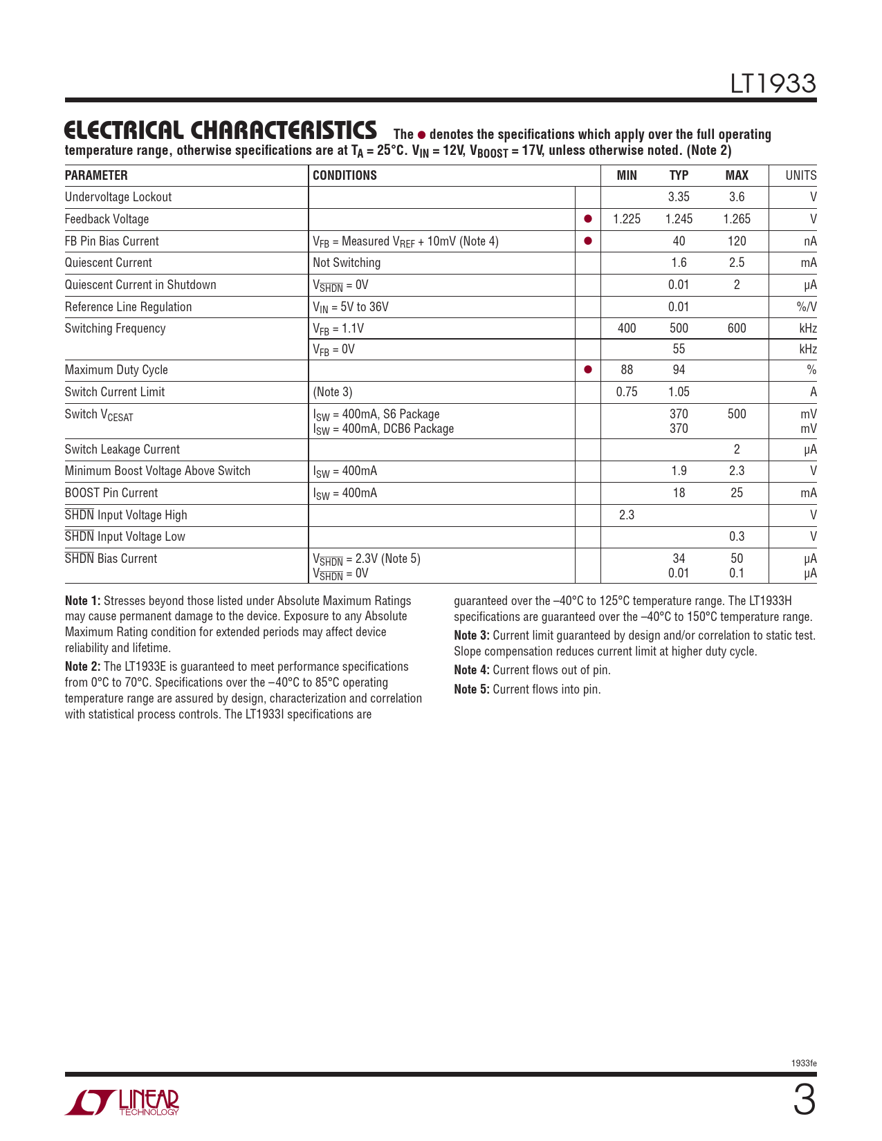

ELECTRICAL CHARACTERISTICS. The. denotes the specifi cations which apply over the full operating
ELECTRICAL CHARACTERISTICS The denotes the specifi cations which apply over the full operating
LT1933
l
denotes the specifi cations which apply over the full operating temperature range, otherwise specifi cations are at TA = 25°C. VIN = 12V, VBOOST = 17V, unless otherwise noted. (Note 2) PARAMETER CONDITIONS MIN TYP MAX
UNITS Undervoltage Lockout 3.35 3.6 V Feedback Voltage l 1.225 1.245 1.265 V FB Pin Bias Current VFB = Measured VREF + 10mV (Note 4) l 40 120 nA Quiescent Current Not Switching 1.6 2.5 mA Quiescent Current in Shutdown VSHDN = 0V 0.01 2 μA Reference Line Regulation VIN = 5V to 36V 0.01 %/V Switching Frequency VFB = 1.1V 400 500 600 kHz VFB = 0V 55 kHz Maximum Duty Cycle l 88 94 % Switch Current Limit (Note 3) 0.75 1.05 A Switch VCESAT ISW = 400mA, S6 Package 370 500 mV ISW = 400mA, DCB6 Package 370 mV Switch Leakage Current 2 μA Minimum Boost Voltage Above Switch ISW = 400mA 1.9 2.3 V BOOST Pin Current ISW = 400mA 18 25 mA SHDN Input Voltage High 2.3 V SHDN Input Voltage Low 0.3 V SHDN Bias Current VSHDN = 2.3V (Note 5) 34 50 μA VSHDN = 0V 0.01 0.1 μA
Note 1:
Stresses beyond those listed under Absolute Maximum Ratings guaranteed over the –40°C to 125°C temperature range. The LT1933H may cause permanent damage to the device. Exposure to any Absolute specifi cations are guaranteed over the –40°C to 150°C temperature range. Maximum Rating condition for extended periods may affect device
Note 3:
Current limit guaranteed by design and/or correlation to static test. reliability and lifetime. Slope compensation reduces current limit at higher duty cycle.
Note 2:
The LT1933E is guaranteed to meet performance specifi cations
Note 4:
Current fl ows out of pin. from 0°C to 70°C. Specifi cations over the –40°C to 85°C operating
Note 5:
Current fl ows into pin. temperature range are assured by design, characterization and correlation with statistical process controls. The LT1933I specifi cations are 1933fe 3
