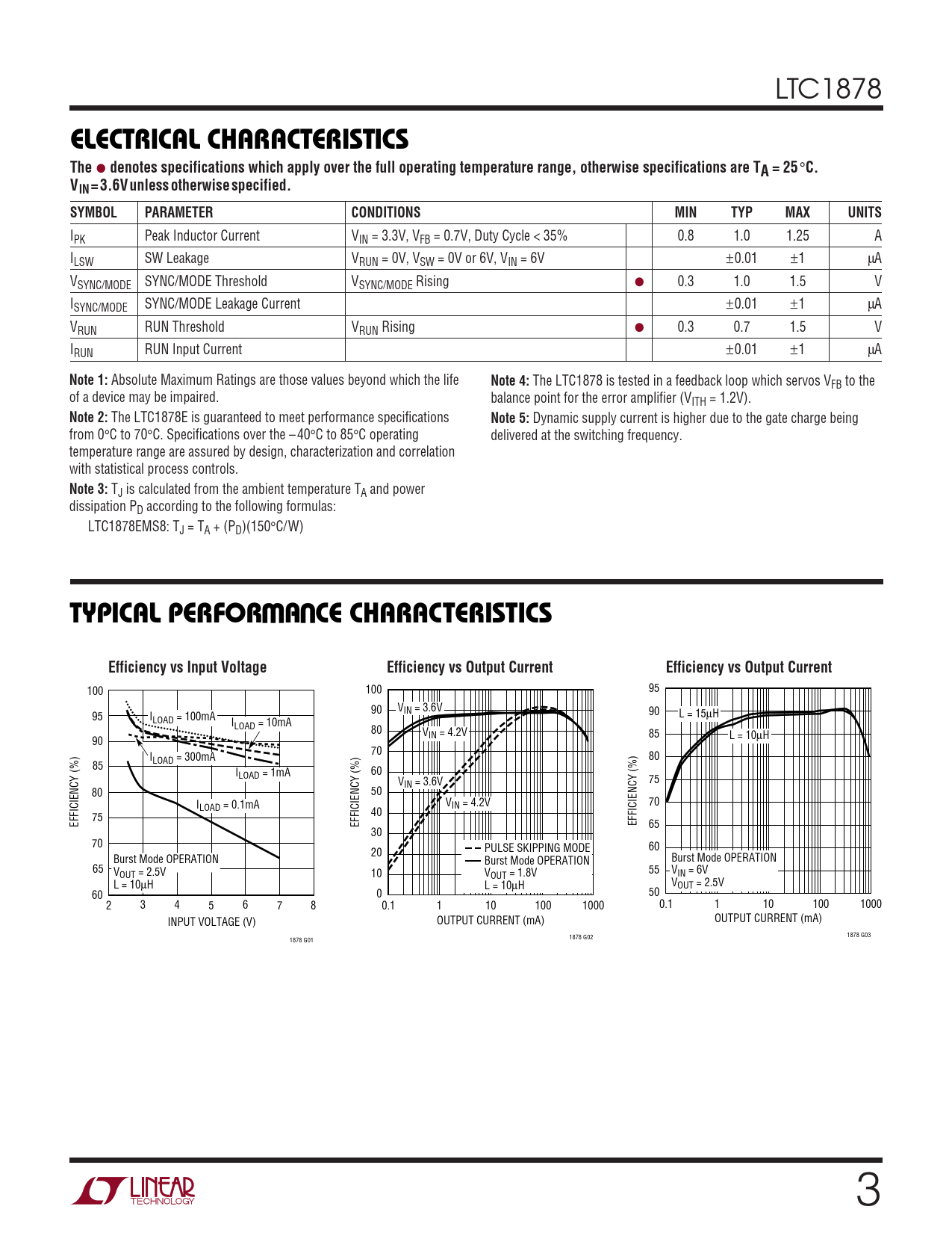

denotes specifications which apply over the full operating temperature range, otherwise specifications are TA = 25
C. VIN = 3.6V unless otherwise specified. SYMBOL PARAMETER CONDITIONS MIN TYP MAX UNITS
IPK Peak Inductor Current VIN = 3.3V, VFB = 0.7V, Duty Cycle < 35% 0.8 1.0 1.25 A ILSW SW Leakage VRUN = 0V, VSW = 0V or 6V, VIN = 6V ±0.01 ±1 µA VSYNC/MODE SYNC/MODE Threshold VSYNC/MODE Rising ● 0.3 1.0 1.5 V ISYNC/MODE SYNC/MODE Leakage Current ±0.01 ±1 µA VRUN RUN Threshold VRUN Rising ● 0.3 0.7 1.5 V IRUN RUN Input Current ±0.01 ±1 µA

W U TYPICAL PERFOR A CE CHARACTERISTICS Efficiency vs Input Voltage Efficiency vs Output Current Efficiency vs Output Current
