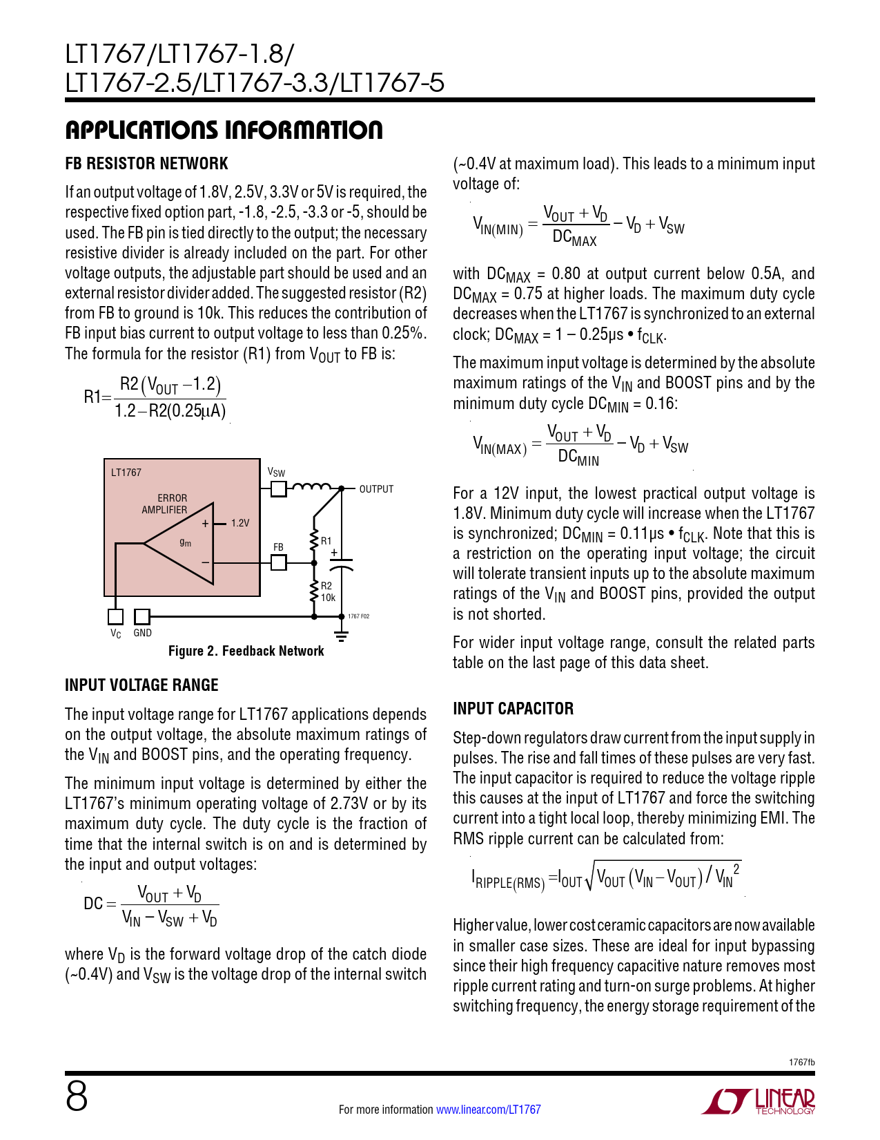

applicaTions inForMaTion FB RESISTOR NETWORK
(~0.4V at maximum load). This leads to a minimum input If an output voltage of 1.8V, 2.5V, 3.3V or 5V is required, the voltage of: respective fixed option part, -1.8, -2.5, -3.3 or -5, should be VOUT + VD used. The FB pin is tied directly to the output; the necessary VIN(MIN) = – V DC D + VSW resistive divider is already included on the part. For other MAX voltage outputs, the adjustable part should be used and an with DCMAX = 0.80 at output current below 0.5A, and external resistor divider added. The suggested resistor (R2) DCMAX = 0.75 at higher loads. The maximum duty cycle from FB to ground is 10k. This reduces the contribution of decreases when the LT1767 is synchronized to an external FB input bias current to output voltage to less than 0.25%. clock; DCMAX = 1 – 0.25µs • fCLK. The formula for the resistor (R1) from VOUT to FB is: The maximum input voltage is determined by the absolute R2 (V ) maximum ratings of the V R1= OUT −1.2 IN and BOOST pins and by the 1.2−R2(0.25µA) minimum duty cycle DCMIN = 0.16: V V OUT + VD IN(MAX) = – VD + VSW DCMIN LT1767 VSW OUTPUT ERROR For a 12V input, the lowest practical output voltage is AMPLIFIER 1.8V. Minimum duty cycle will increase when the LT1767 + 1.2V is synchronized; DC gm R1 MIN = 0.11µs • fCLK. Note that this is FB + a restriction on the operating input voltage; the circuit – will tolerate transient inputs up to the absolute maximum R2 10k ratings of the VIN and BOOST pins, provided the output 1767 F02 is not shorted. VC GND For wider input voltage range, consult the related parts
Figure 2. Feedback Network
table on the last page of this data sheet.
INPUT VOLTAGE RANGE INPUT CAPACITOR
