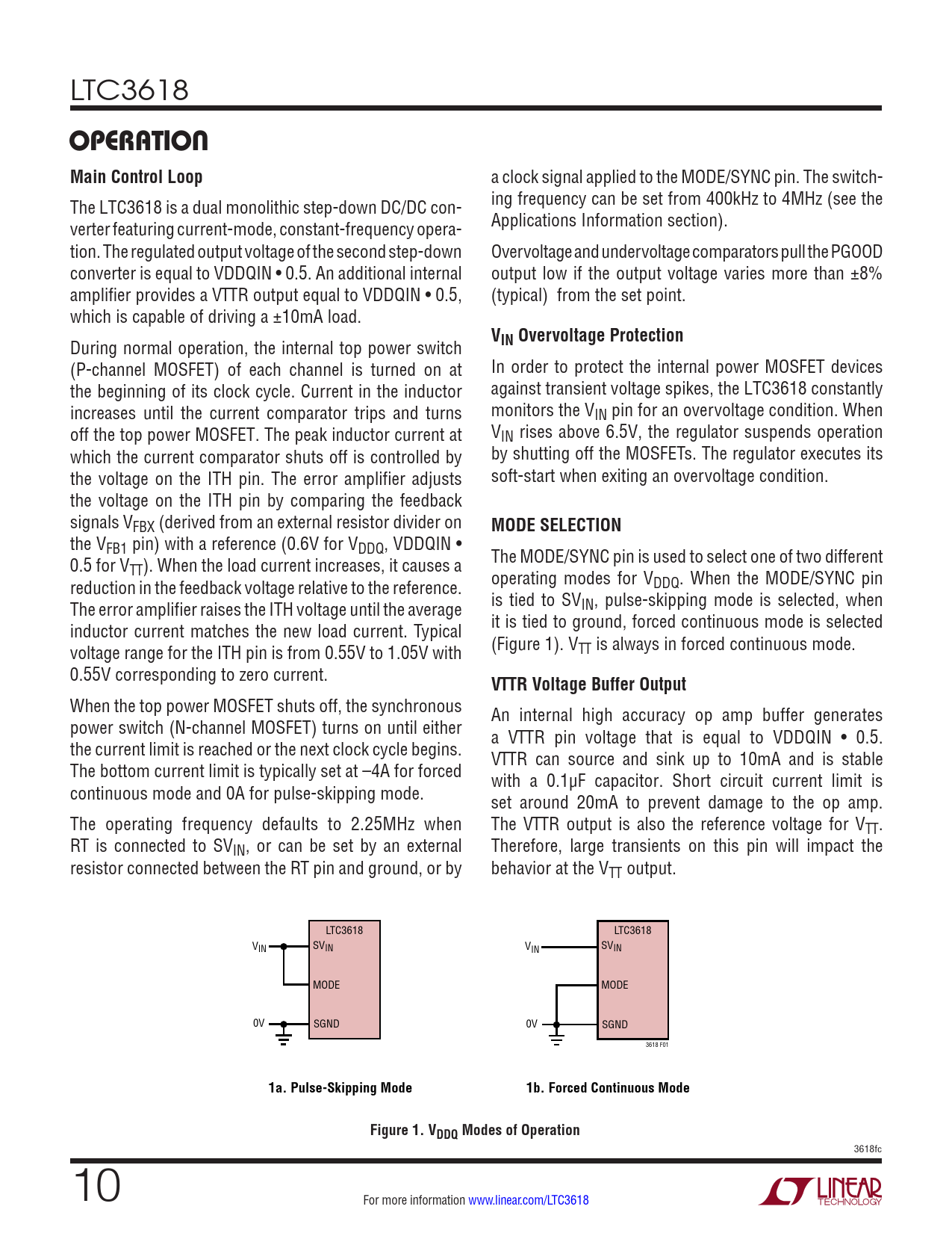

MODE SELECTION
the VFB1 pin) with a reference (0.6V for VDDQ, VDDQIN • 0.5 for V The MODE/SYNC pin is used to select one of two different TT). When the load current increases, it causes a reduction in the feedback voltage relative to the reference. operating modes for VDDQ. When the MODE/SYNC pin The error amplifier raises the ITH voltage until the average is tied to SVIN, pulse-skipping mode is selected, when inductor current matches the new load current. Typical it is tied to ground, forced continuous mode is selected voltage range for the ITH pin is from 0.55V to 1.05V with (Figure 1). VTT is always in forced continuous mode. 0.55V corresponding to zero current.

When the top power MOSFET shuts off, the synchronous An internal high accuracy op amp buffer generates power switch (N-channel MOSFET) turns on until either a VTTR pin voltage that is equal to VDDQIN • 0.5. the current limit is reached or the next clock cycle begins. VTTR can source and sink up to 10mA and is stable The bottom current limit is typically set at –4A for forced with a 0.1µF capacitor. Short circuit current limit is continuous mode and 0A for pulse-skipping mode. set around 20mA to prevent damage to the op amp. The operating frequency defaults to 2.25MHz when The VTTR output is also the reference voltage for VTT. RT is connected to SVIN, or can be set by an external Therefore, large transients on this pin will impact the resistor connected between the RT pin and ground, or by behavior at the VTT output. LTC3618 LTC3618 V SV IN IN V SV IN IN MODE MODE 0V SGND 0V SGND 3618 F01
1a. Pulse-Skipping Mode 1b. Forced Continuous Mode Figure 1. VDDQ Modes of Operation
