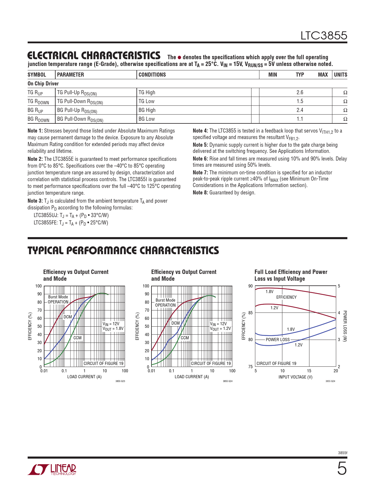

denotes the specifications which apply over the full operating junction temperature range (E-Grade), otherwise specifications are at TA = 25°C. VIN = 15V, VRUN/SS = 5V unless otherwise noted. SYMBOL PARAMETER CONDITIONS MIN TYP MAX UNITS On Chip Driver
TG RUP TG Pull-Up RDS(ON) TG High 2.6 Ω TG RDOWN TG Pull-Down RDS(ON) TG Low 1.5 Ω BG RUP BG Pull-Up RDS(ON) BG High 2.4 Ω BG RDOWN BG Pull-Down RDS(ON) BG Low 1.1 Ω

TJ is calculated from the ambient temperature TA and power dissipation PD according to the following formulas: LTC3855UJ: TJ = TA + (PD • 33°C/W) LTC3855FE: TJ = TA + (PD • 25°C/W) Typical perForMance characTerisTics
Efficiency vs Output Current Efficiency vs Output Current Full Load Efficiency and Power and Mode and Mode Loss vs Input Voltage
100 100 90 5 90 90 1.8V Burst Mode EFFICIENCY 80 OPERATION 80 Burst Mode OPERATION 70 70 1.2V POWER LOSS (W) 85 4 60 DCM 60 V DCM V 50 IN = 12V IN = 12V V 50 OUT = 1.8V VOUT = 1.2V 1.8V 40 40 EFFICIENCY (%) CCM EFFICIENCY (%) CCM EFFICIENCY (%) 80 POWER LOSS 3 30 30 1.2V 20 20 10 10 CIRCUIT OF FIGURE 19 CIRCUIT OF FIGURE 19 CIRCUIT OF FIGURE 19 0 0 75 2 0.01 0.1 1 10 100 0.01 0.1 1 10 100 5 10 15 20 LOAD CURRENT (A) LOAD CURRENT (A) INPUT VOLTAGE (V) 3855 G23 3855 G24 3855 G24 3855f Document Outline Features Applications Description Typical Application Absolute Maximum Ratings Pin Configuration Order information Electrical Characteristics Typical Performance Characteristics Pin Functions Functional Block Diagram Operation Applications Information Typical Applications Package Description Related Parts
