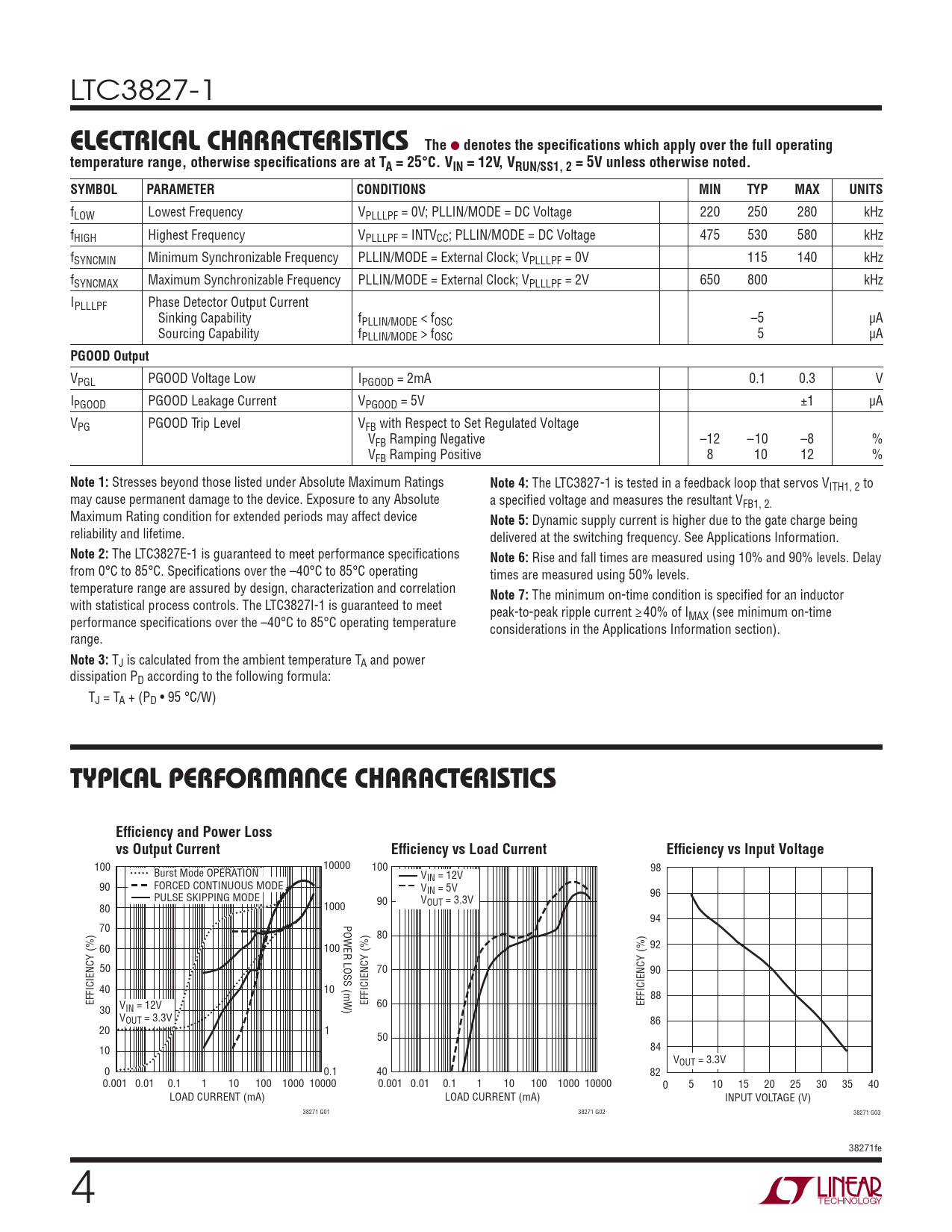

ELECTRICAL CHARACTERISTICS. The. denotes the specifi cations which apply over the full operating
ELECTRICAL CHARACTERISTICS The denotes the specifi cations which apply over the full operating
LTC3827-1
l
denotes the specifi cations which apply over the full operating temperature range, otherwise specifi cations are at TA = 25°C. VIN = 12V, VRUN/SS1, 2 = 5V unless otherwise noted. SYMBOL PARAMETER CONDITIONS MIN TYP MAX UNITS
fLOW Lowest Frequency VPLLLPF = 0V; PLLIN/MODE = DC Voltage 220 250 280 kHz fHIGH Highest Frequency VPLLLPF = INTVCC; PLLIN/MODE = DC Voltage 475 530 580 kHz fSYNCMIN Minimum Synchronizable Frequency PLLIN/MODE = External Clock; VPLLLPF = 0V 115 140 kHz fSYNCMAX Maximum Synchronizable Frequency PLLIN/MODE = External Clock; VPLLLPF = 2V 650 800 kHz IPLLLPF Phase Detector Output Current Sinking Capability fPLLIN/MODE < fOSC –5 μA Sourcing Capability fPLLIN/MODE > fOSC 5 μA
PGOOD Output
VPGL PGOOD Voltage Low IPGOOD = 2mA 0.1 0.3 V IPGOOD PGOOD Leakage Current VPGOOD = 5V ±1 μA VPG PGOOD Trip Level VFB with Respect to Set Regulated Voltage VFB Ramping Negative –12 –10 –8 % VFB Ramping Positive 8 10 12 %
Note 1:
Note 4:
The LTC3827-1 is tested in a feedback loop that servos VITH1, 2 to may cause permanent damage to the device. Exposure to any Absolute a specifi ed voltage and measures the resultant VFB1, 2. Maximum Rating condition for extended periods may affect device
Note 5:
Dynamic supply current is higher due to the gate charge being reliability and lifetime. delivered at the switching frequency. See Applications Information.
Note 2:
The LTC3827E-1 is guaranteed to meet performance specifi cations
Note 6:
Rise and fall times are measured using 10% and 90% levels. Delay from 0°C to 85°C. Specifi cations over the –40°C to 85°C operating times are measured using 50% levels. temperature range are assured by design, characterization and correlation
Note 7:
The minimum on-time condition is specifi ed for an inductor with statistical process controls. The LTC3827I-1 is guaranteed to meet peak-to-peak ripple current ≥ 40% of IMAX (see minimum on-time performance specifi cations over the –40°C to 85°C operating temperature considerations in the Applications Information section). range.
Note 3:
TJ is calculated from the ambient temperature TA and power dissipation PD according to the following formula: TJ = TA + (PD • 95 °C/W)
