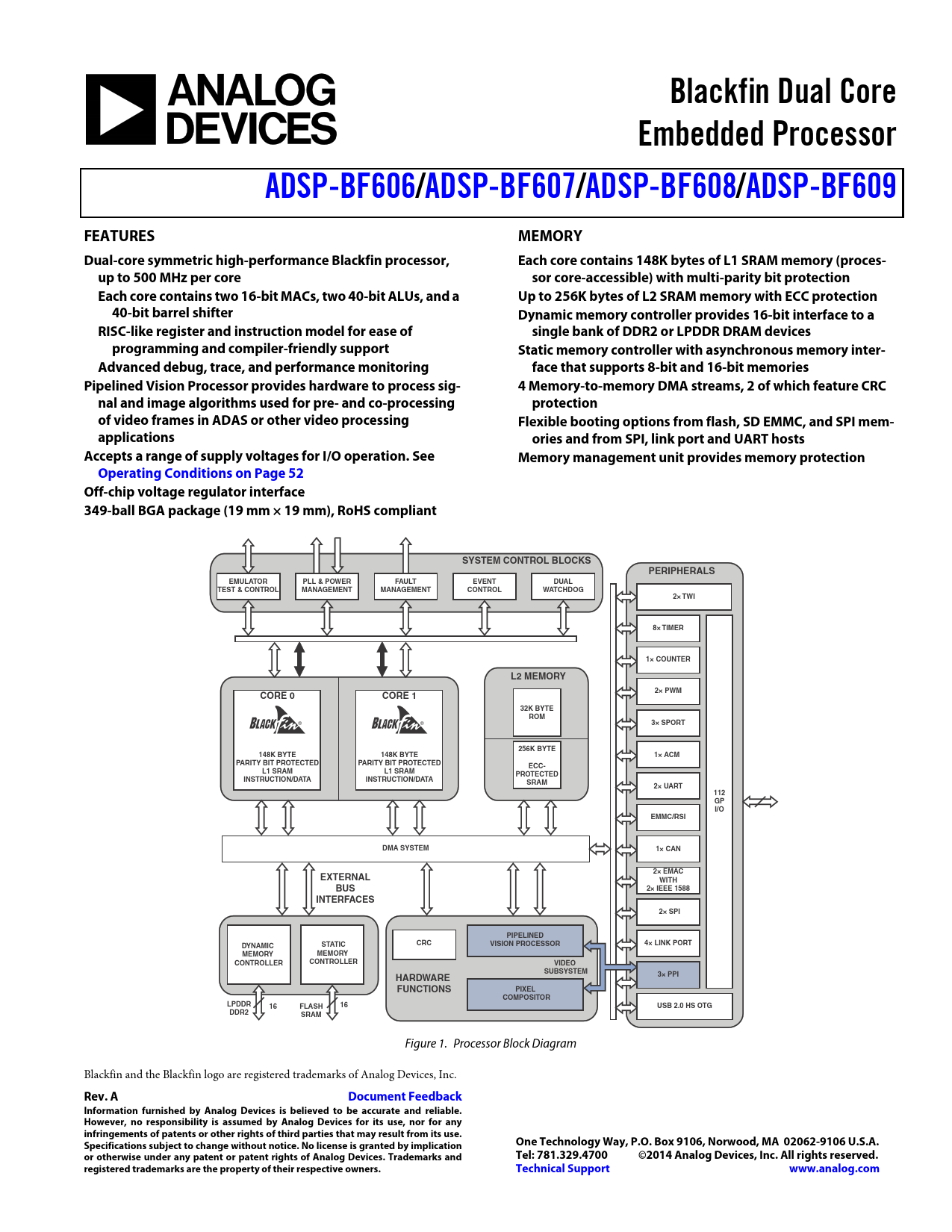

FEATURES. MEMORY. Dual-core symmetric high-performance Blackfin processor,
link to page 52 Blackfin Dual Core Embedded Processor ADSP-BF606/ADSP-BF607/ADSP-BF608/ADSP-BF609
FEATURES MEMORY Dual-core symmetric high-performance Blackfin processor, Each core contains 148K bytes of L1 SRAM memory (proces- up to 500 MHz per core sor core-accessible) with multi-parity bit protection Each core contains two 16-bit MACs, two 40-bit ALUs, and a Up to 256K bytes of L2 SRAM memory with ECC protection 40-bit barrel shifter Dynamic memory controller provides 16-bit interface to a RISC-like register and instruction model for ease of single bank of DDR2 or LPDDR DRAM devices programming and compiler-friendly support Static memory controller with asynchronous memory inter- Advanced debug, trace, and performance monitoring face that supports 8-bit and 16-bit memories Pipelined Vision Processor provides hardware to process sig- 4 Memory-to-memory DMA streams, 2 of which feature CRC nal and image algorithms used for pre- and co-processing protection of video frames in ADAS or other video processing Flexible booting options from flash, SD EMMC, and SPI mem- applications ories and from SPI, link port and UART hosts Accepts a range of supply voltages for I/O operation. See Memory management unit provides memory protection Operating Conditions on Page 52 Off-chip voltage regulator interface 349-ball BGA package (19 mm × 19 mm), RoHS compliant SYSTEM CONTROL BLOCKS PERIPHERALS EMULATOR PLL & POWER FAULT EVENT DUAL TEST & CONTROL MANAGEMENT MANAGEMENT CONTROL WATCHDOG 2× TWI 8× TIMER 1× COUNTER L2 MEMORY 2× PWM CORE 0 CORE 1 32K BYTE ROM
B B
3× SPORT 256K BYTE 148K BYTE 148K BYTE 1× ACM PARITY BIT PROTECTED PARITY BIT PROTECTED ECC- L1 SRAM L1 SRAM PROTECTED INSTRUCTION/DATA INSTRUCTION/DATA SRAM 2× UART 112 GP I/O EMMC/RSI DMA SYSTEM 1× CAN 2× EMAC EXTERNAL WITH BUS 2× IEEE 1588 INTERFACES 2× SPI PIPELINED CRC STATIC VISION PROCESSOR 4× LINK PORT DYNAMIC MEMORY MEMORY CONTROLLER CONTROLLER VIDEO SUBSYSTEM HARDWARE 3× PPI FUNCTIONS PIXEL COMPOSITOR LPDDR 16 FLASH 16 USB 2.0 HS OTG DDR2 SRAM
Figure 1. Processor Block Diagram Blackfin and the Blackfin logo are registered trademarks of Analog Devices, Inc.
