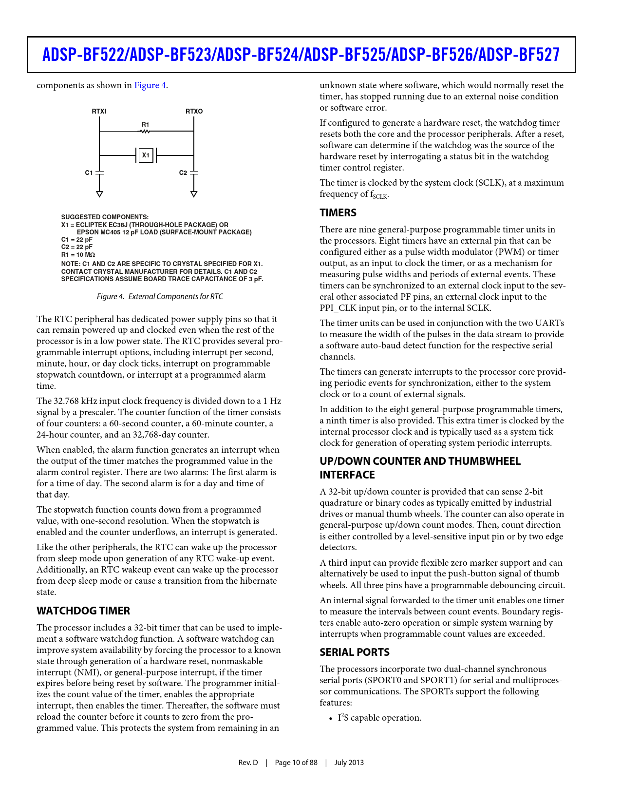

components as shown in Figure 4. unknown state where software, which would normally reset the timer, has stopped running due to an external noise condition or software error.
RTXI RTXO R1
If configured to generate a hardware reset, the watchdog timer resets both the core and the processor peripherals. After a reset, software can determine if the watchdog was the source of the
X1
hardware reset by interrogating a status bit in the watchdog timer control register.
C1 C2
The timer is clocked by the system clock (SCLK), at a maximum frequency of fSCLK.
TIMERS SUGGESTED COMPONENTS: X1 = ECLIPTEK EC38J (THROUGH-HOLE PACKAGE) OR EPSON MC405 12 pF LOAD (SURFACE-MOUNT PACKAGE)
There are nine general-purpose programmable timer units in
C1 = 22 pF
the processors. Eight timers have an external pin that can be
C2 = 22 pF R1 = 10 M
: configured either as a pulse width modulator (PWM) or timer
NOTE: C1 AND C2 ARE SPECIFIC TO CRYSTAL SPECIFIED FOR X1.
output, as an input to clock the timer, or as a mechanism for
CONTACT CRYSTAL MANUFACTURER FOR DETAILS. C1 AND C2
measuring pulse widths and periods of external events. These
SPECIFICATIONS ASSUME BOARD TRACE CAPACITANCE OF 3 pF.
timers can be synchronized to an external clock input to the sev- Figure 4. External Components for RTC eral other associated PF pins, an external clock input to the PPI_CLK input pin, or to the internal SCLK. The RTC peripheral has dedicated power supply pins so that it The timer units can be used in conjunction with the two UARTs can remain powered up and clocked even when the rest of the to measure the width of the pulses in the data stream to provide processor is in a low power state. The RTC provides several pro- a software auto-baud detect function for the respective serial grammable interrupt options, including interrupt per second, channels. minute, hour, or day clock ticks, interrupt on programmable stopwatch countdown, or interrupt at a programmed alarm The timers can generate interrupts to the processor core provid- time. ing periodic events for synchronization, either to the system clock or to a count of external signals. The 32.768 kHz input clock frequency is divided down to a 1 Hz signal by a prescaler. The counter function of the timer consists In addition to the eight general-purpose programmable timers, of four counters: a 60-second counter, a 60-minute counter, a a ninth timer is also provided. This extra timer is clocked by the 24-hour counter, and an 32,768-day counter. internal processor clock and is typically used as a system tick clock for generation of operating system periodic interrupts. When enabled, the alarm function generates an interrupt when the output of the timer matches the programmed value in the
